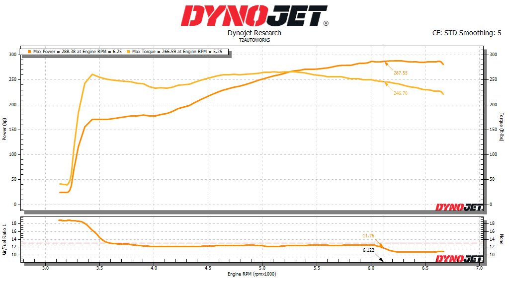

    Yesterday, @virginiamarine ran two YotaWerx 90mm pulley supercharger tunes on a dyno local to him.
    *Caveat, per @virginiamarine , "...the dyno is brand new and the shop said it still needs breaking in so the HP shows lower than it really is."
    "They estimated it could be a 10% loss but didn't have anything firm to back it up like dyno literature."
    This estimate represents as much as a theoretical 29hp difference, but this is all purely speculation.
    These runs were done with an ambient temperature in the low 60's, °F.
    See below:
    There is another dyno session scheduled for tomorrow by another tune tester in another location; ambient temperatures are forecast to be in the mid-to-high-70's to low-80's.
    Tomorrow's tunes to run will be similar to these, although a bit more power has been added down in the 2800-4000rpm range, hopefully that will be reflected on the dynographs.

    Those torque curves looks great!

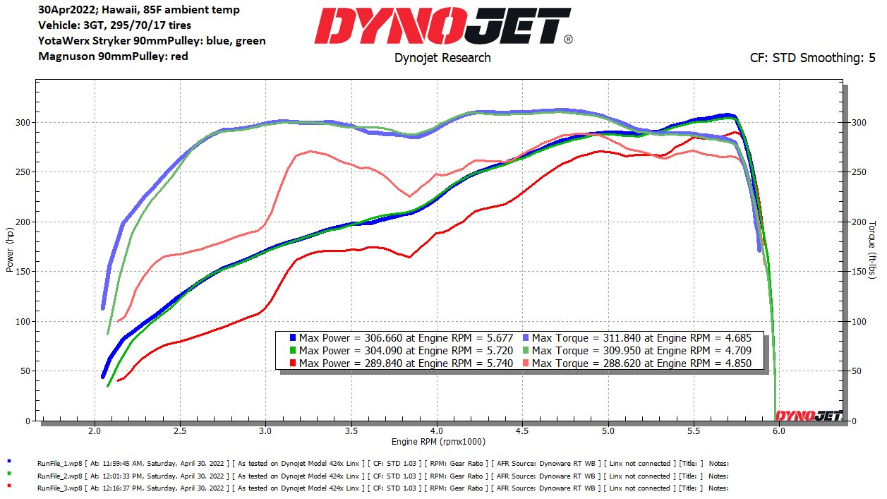

    Today, @SK808 ran his Magnuson supercharged 3GTacoma with the 90mm pulley on the dyno down in Hawaii!
    We made further revisions following Thursday's dyno runs and chose a file to run today.
    Vehicle and climate details:
    - tire size is 295/70/17 MT's
    - snorkel which can present some airflow restriction; this one has been gutted where the snorkel has an inherent restriction due to design shortly after entering the fender
    - ambient temperature: 85°F (approximately 25° warmer than Thursday's dyno runs)
    Dynograph below; the red run is the Magnuson supercharger tune for the 90mm pulley. The blue and green runs are the YotaWerx tune.
    In total, the dynograph demonstrates a 17whp/23wtq gain for the YotaWerx 3GT SC tune, as well as significant improvement throughout the entire powerband.

    Holy s#it! That curve is amazing compared to Magnuson's theoretical garbage!

    Holy shit that truck is a beast. if the red one is the tune, what are the blue and green?

    The red is the Magnuson tune, and the blue and green is the YotaWerx tune that we chose to run.
    There's a ton of data out there from various people running the Maggy tune, so we really only needed the one run to establish a benchmark for the graph. Since 3 runs were paid for, we used the other two for the same YW tune, back to back.

    What is up with that dip on the maggy tune right around 3850 rpm. I can feel that when driving and thought there was something wrong, I guess its not just my truck. It feels like a slight dead spot and then a surge of power. It happens so close to the shift point sometimes that I was wondering if something was wrong with my clutch. It looks like your tune smooths that out substantially. Very nice to see.
