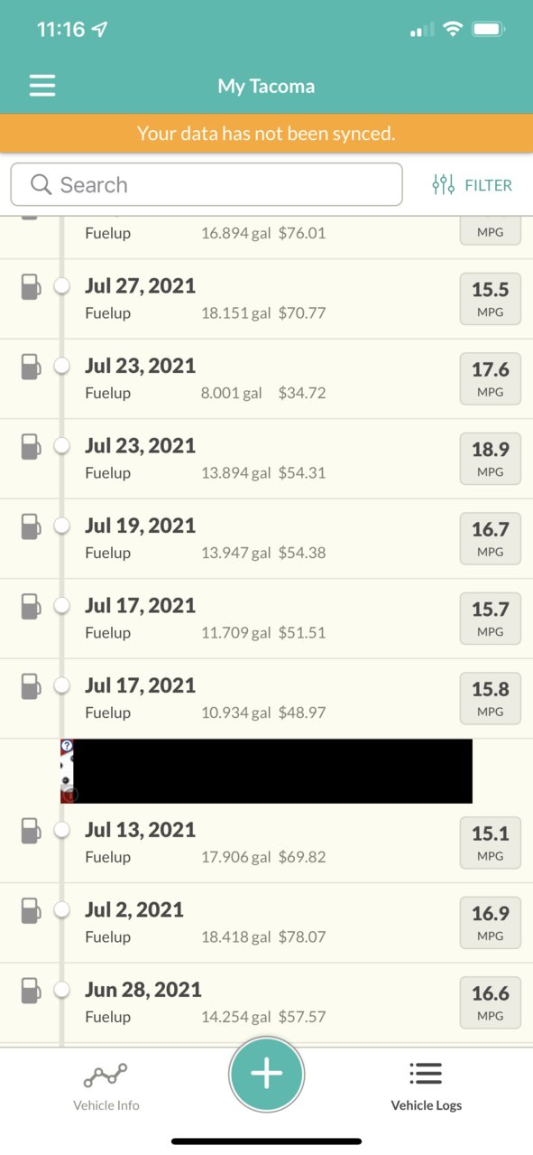

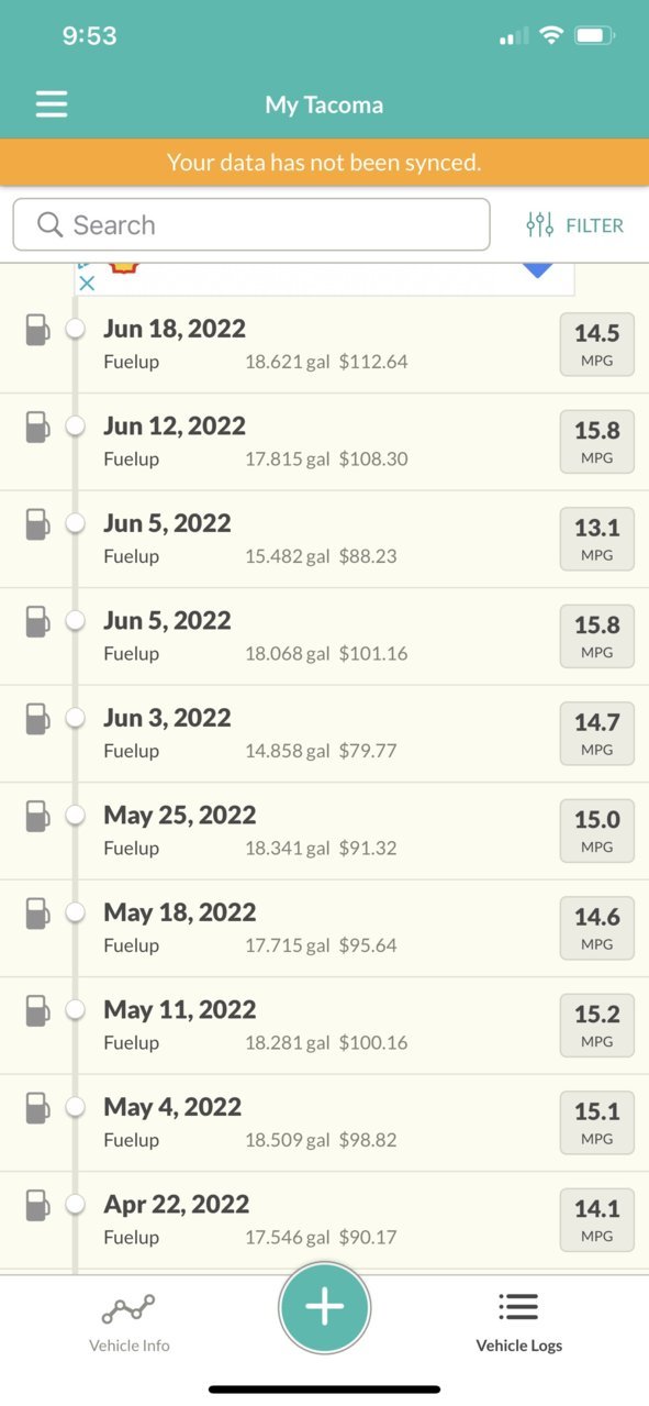

    it's tough to positively say yes because I have other things that have happened in the middle that make comparissons not completely equal. I drive differently on the 87 pulley to try and maximize mpg's where it wasn't as big of a change on the 90mm to get good mileage. Looking at my fuelly logs it looks like I am now averaging about 1mpg worse than the same time a year ago. I took a little later group from last year as this time last year I was doing a bunch of towing that drastically changes the average.

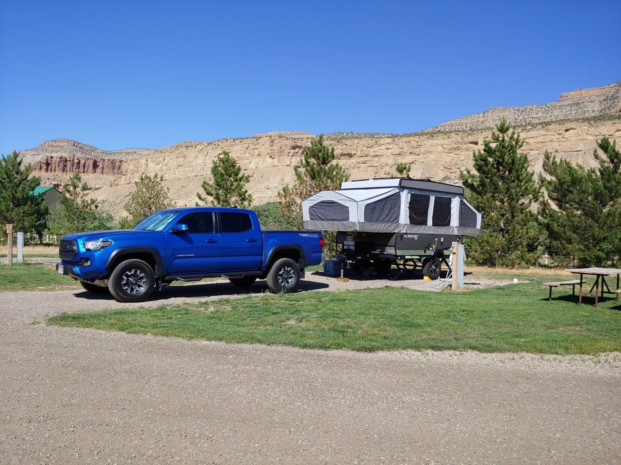

    So, this is a pic of what we tow - a 10ft box pop-up tent camper with our 2016 TRD OR AT V6. Capacity weight of the camper is approximately 2800 lb when loaded. When towing we use S mode always and typically S4 in heavy grades and S5 for the rest. We just completed towing vacation that took us from Golden, CO to Palisade Co - about 250 miles each way. There are two major passes along I70 route over the Continental Divide - Eisenhower Tunnels (11,063 ft) and Vail Pass (10,603 ft). Highway speeds on these passes is 65 mph. Highway speed on the steepest grades was easily maintained in S4 at 3500 rpm. The round-trip miles per gallon (towing) averaged for the round trip of 500 miles was 17 mpg. While at Palisade we drove an additional 200 miles non-towing, and our average mpg was 22.5.
    The YotaWerx Stryker Tune delivers the power and driving experience that is missing from the Magnuson OEM Tune. YotaWerx and @mZiggy have developed a winning solution that makes every-day driving and weekend towing a true pleasure. Thanks Marc, and the entire Testing Group for your work!
    Edit: For those of you wondering about Coolant Temp and Torque Converter Temp while towing during operating conditions (I use a scangauge II to monitor) here are the results: The Coolant Temp ranged between 188 and 200 and the Torque Converter Temp ranged between 155 and 170. I run a parallel Hayden Transmission Cooler with the thermostate pinned.
