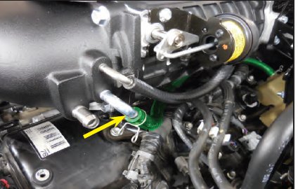

    there was a post a few pages back espousing the installation of an oil catch can. Are there any solid instructions for installing one?

    Would anyone just be willing to point out on a photo which hoses need to go where?

    For a single catch can, with a Maggie, it goes in this PCV line, on the f=drivers side. Take the hose (high-lighted Green) off at the yellow arrow, to the "In" of the CC, then add a new hose from the "Out of the CC to the nipple on the SC with the yellow arrow. Of course you can put the CC anywhere in the run of this line, it runs toward the firewall, and connects to the valve cover; you can see the other end of this hose in the picture, also high-lighted in green. The catch can must be vertical, and you must be able to remove the CC bowl on a regular interval (or otherwise drain it).
    BTW: no need for the check valve on a NA or SC engine; that is only needed for a Turbo setup.
    Some have mounted it to the rear bracket for the SC. That is what I also hope to do.
    For a 2nd CC, it goes on the vent line on the passenger side, but i do not have a picture for that one.
    Note that an over-full CC, from lack of draining it often enough, is WAY Worse than not having one at all. Please monitor your CC every 1-2 K miles, until you learn how often it needs emptying, which may need emptying more often in cold climates. I suggest not letting it ever get much more than 1/2 full; 3/4 full is possibly too high. You do not want to go over a bump or stop fast and have a stream of oil get sucked into the intake.

    Follow the instructions @Pinchaser posted, they are spot on. Here's a picture of mine. I used the SC bracket and bent the bracket that came with the CC to make it fit.
