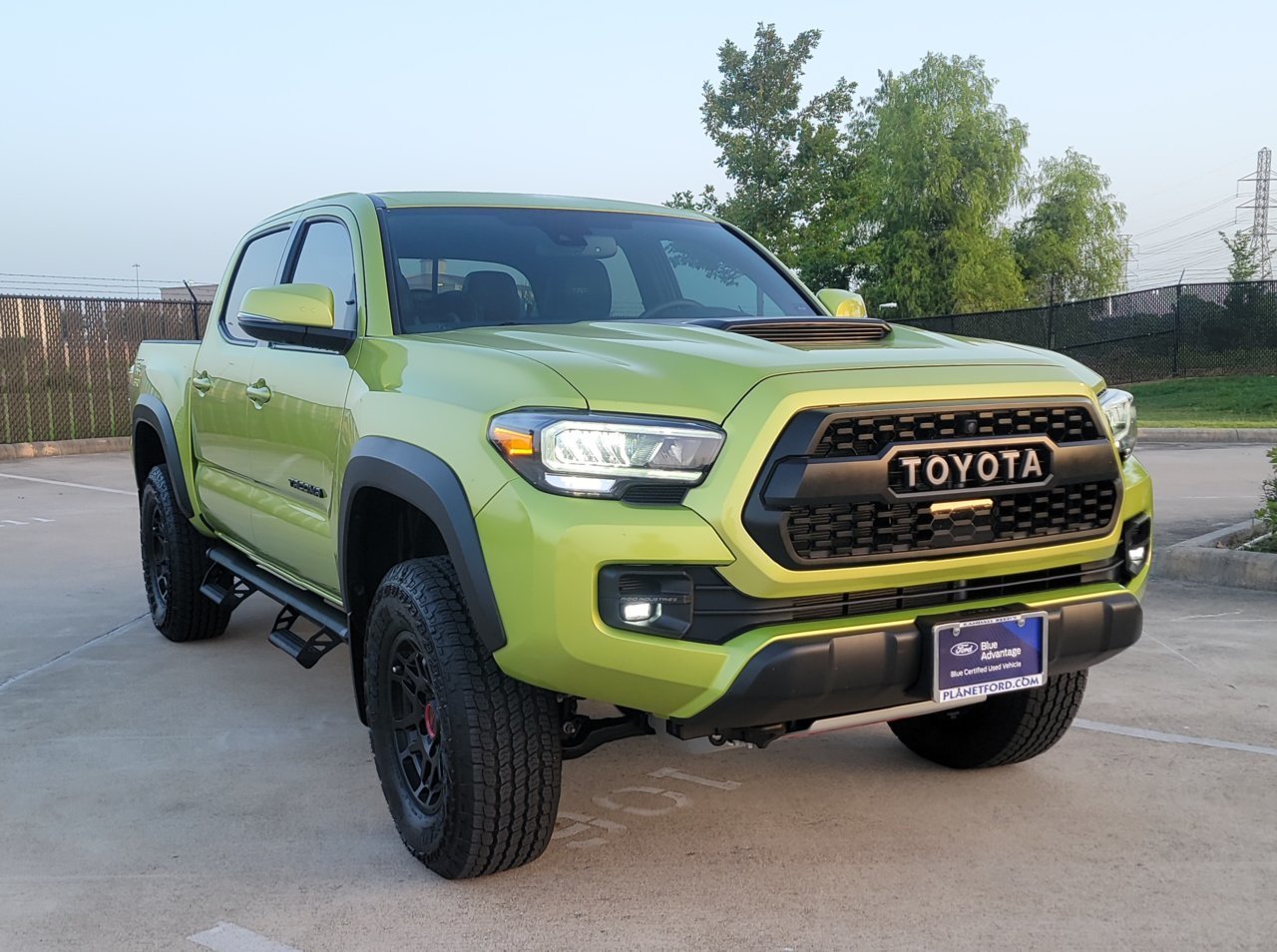

    REVIEW FOR THE TUNES
    (@mZiggy I know you are waiting for this one)
    STORY: I've been always a Toyota fan since I was young all my cars in the Philippines are Toyota. Specifically the Toyota PICKUP (HILUX for asian name) 5th gen and 8th gen all are DIESEL. I own a shop in the Philippines and tuned cars as well using KESS. (Its a straight soldering to the board of an ecm just to tune it). Came here to the United States and yeah, I work an 8-5 job for a dealership being one of their master technicians. Bought a Tacoma, love the looks but hate how it runs. So I read some forums and saw about this tuning. Spending thousands. I TRIED THEM ALL. Working at a dealership, I saw lots of cars being tuned outside and coming in with a F*CK*D UP engine because of it. So I need to search for the BEST tune I can get for my own. I tried KD (KD MAX PRO, KD MAX PRO+, KD MAX PRO+ XT), VALLEY RUNNER, NEXUS. I can't say something bad about other tunes, they are all GOOD. You can even see that I gave a good review for them. But here is my review for the BLACKHAWK TUNE:
    1. Blackhawk Regular OL
    - Lighter Side of Everything
    - Less Aggressive Throttle
    - A/F Mixture always close to 1
    - No DEAD SPOT at any RPMS compared to stock
    - I was able to get a MAX of 17 MPG
    - Great for NO MODS, EVERYDAY TRUCK and The ones that just want to improve the MPG and shifting far from stock.
    2. Blackhawk Premium AD
    - PERFORMANCE TUNE
    - Massive and Dramatic Power and Torque Increase
    - Really Aggresive Throttle
    - A/F MIXTURE always close to 1
    - Less Downshifting if you need to overtake cars coz of the TORQUE that this tune brings out ( I only use 5th and 6th Highway)
    - Max MPG at 20.*
    - I Find this is great for semi modified engine like if you have an intake or exhaust mod. (This tune has the best compensation of the TRD PRO factory exhaust and a drop in filter)
    3. Blackhawk Premium WW
    - Almost thesame as the AD. This just have a less aggressive throttle for the drivers that finds the AD too much aggressive for them.
    - 18 mpg
    ALL TUNES WERE GIVEN 500+ MILES EACH. I Personally SCRUTINIZE engine data through TECHSTREAM to see how each tune performs.
    Find the tune that would fit your driving habit. I find the BLACKHAWK AD perfectly matched mine, as you can see I got the most MPG on that tune. Not becuase they say that the tune is like this and like that meaning you would have the same outcome. "IT DEPENDS ON THE TRUCK and THE WAY YOU DRIVE" Everything should match up for you to get the best outcome.
    After trying many tunes, I found the BEST. It even made me decide to join the YW tuning network. 20220606_065003.jpg 20220613_064315.jpg

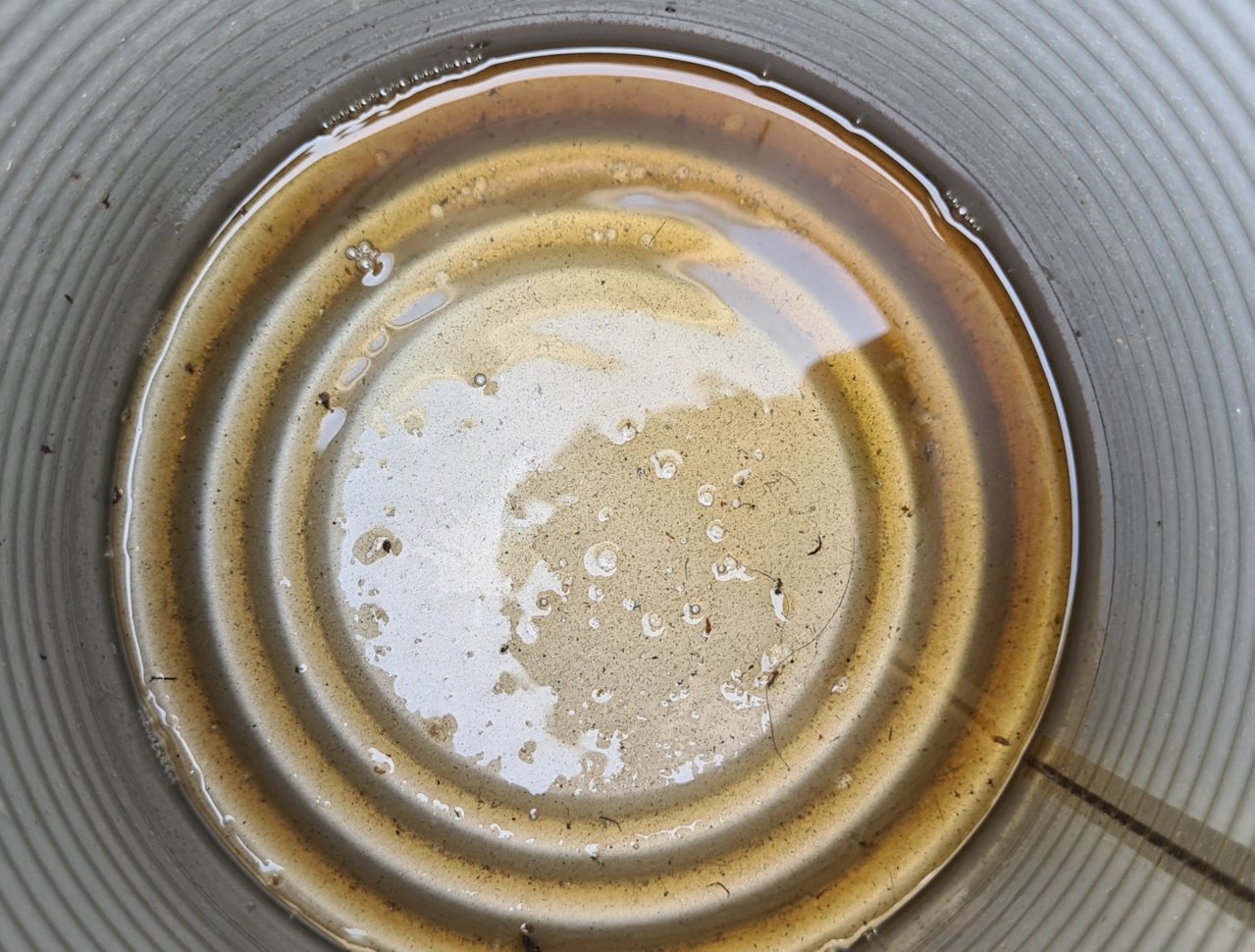

    Just emptied my catch cans. I have dual RXP cans. About 700 miles on twin turbos with 5w30 oil. This is what came out for reference. Contaminated oil and water. About 3 tablespoons. The dirt was already in the can.
    Nothing came out of my breather side.

    that's good for confidence. my NA truck dumped about 3oz of fully opaque black funk with a very strong gas smell last change. needless to say i'm happy to have my catch can.

    Yeah the factory 0w20 is super thin and burns off faster. I would average a loss of a quart of oil every oil change, and that was n/a. Boosted is worse, and my understanding is you guys keep using 0w20 with the supercharger.

    i'm NA. i haven't detected any oil loss.

    It varies from truck to truck and climate. I live in a very very humid area.

    0w20 with SC I see less than 2 oz every 5k miles. I check catch can every 1k miles or after each towing experience. No water - only oil.
