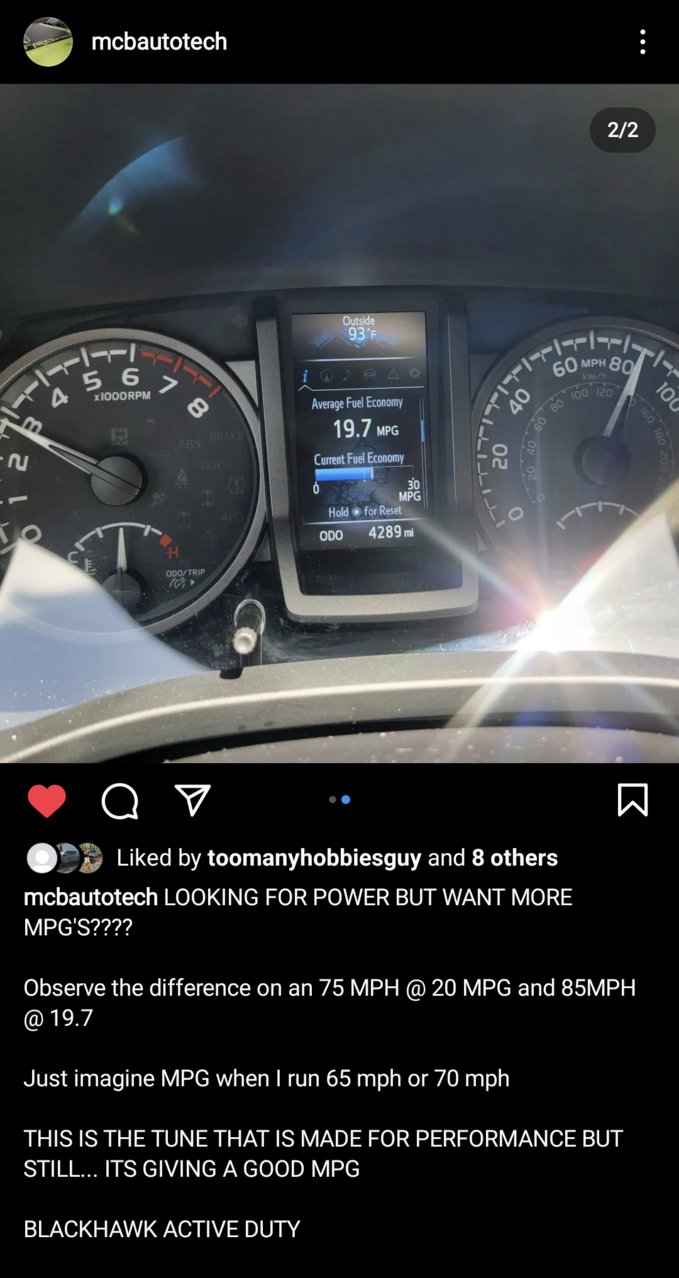

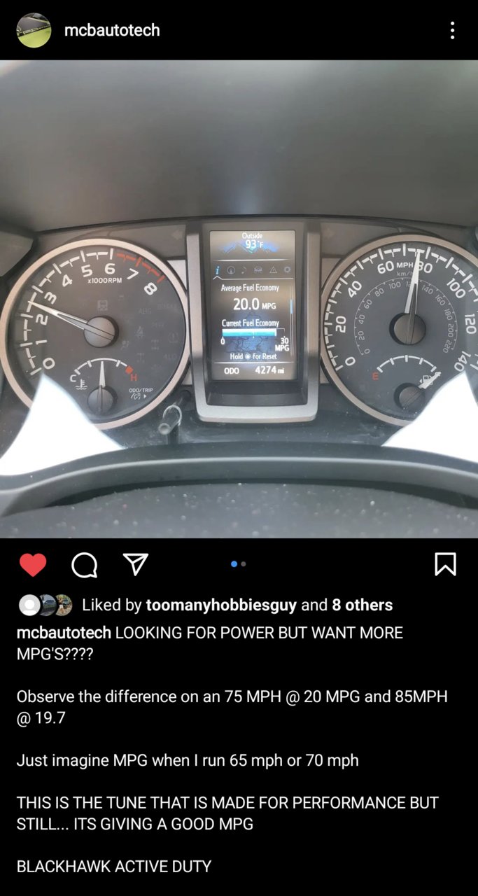

    @Mcbelen over here on a long road trip, racking up the miles on the YWNexus Blackhawk AD tune, and observing excellent fuel economy while he's at it. If I'm mistaken, he daily drives the premium fuel tune version and is still on it for this trip.
    These shots are at 75 and 85mph in his 6MT Tacoma (stock 4.30 gears).
    @Mcbelen is also a YotaWerx networked tuner in the Houston, TX area.
