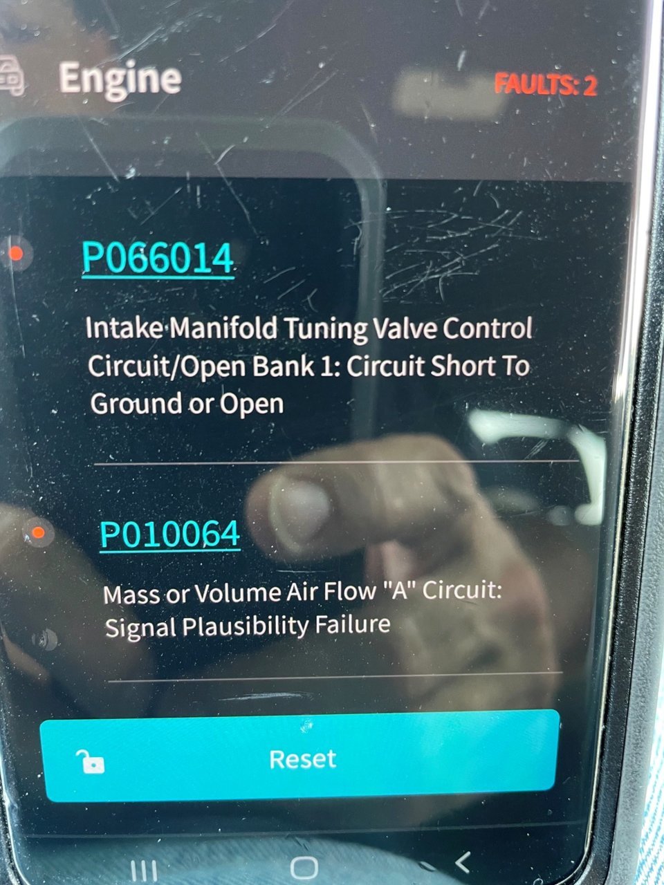

    I did a scan and came up with P066014 and P010064
    It stays off for a few days after I clear the code, then pops back up. Funny thing is I haven't cleared it this week and this morning it didn't show up.
    To follow up, I cleaned the MAF sensor with CRC MAF cleaner, tube, air filter, throttle body thingy, and checked all wires around the area. No luck with that, then I ordered a new MAF sensor, installed....3 days later engine light popped back up, same codes. Next thing i did was clean the MAF sensor in the SC itself with the CRC stuff, no luck. Unless directed in a different direction, I plan on calling Maggy and ordering the MAF sensor in the SC and maybe the breakout harness.
    The truck runs great even with the check engine light on, weird.

    Thank you. Light came back on today on the way to work. Sorry for the poor picture quality.Engine codes.jpg

    The ACIS code is normal.
    The MAF code is probably a vacuum leak. Check your PCV hoses first. Make sure they have hose clamps on them! Make sure all the hoses to the supercharger have clamps.
    if that doesn’t fix the issue your intake system or the supercharger lid may be leaking vacuum after the MAF sensor.

    It seems like a wiring issue to me. The connector might have been loose during the SC install. I went trough the wiring diagram of the engine. The ACIS and MAF has one wire that is common for the two. It fis the GREY wire. It is a feedback signal going to the ecm. You might want to inspect the connectors for loose connection on this wire on the ACIS and MAF.

    The setup is actually a little different for the supercharger, I have the install guide here somewhere. I'll send it over to you so you can see what I mean.

    PM'd you the install guide with an explanation @Mcbelen
    Nonetheless, I'd check the aci harness connection with the cap for loose connection, or dirty connection, kinked wires, etc
