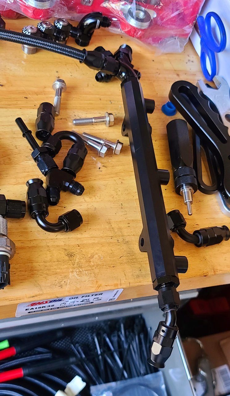

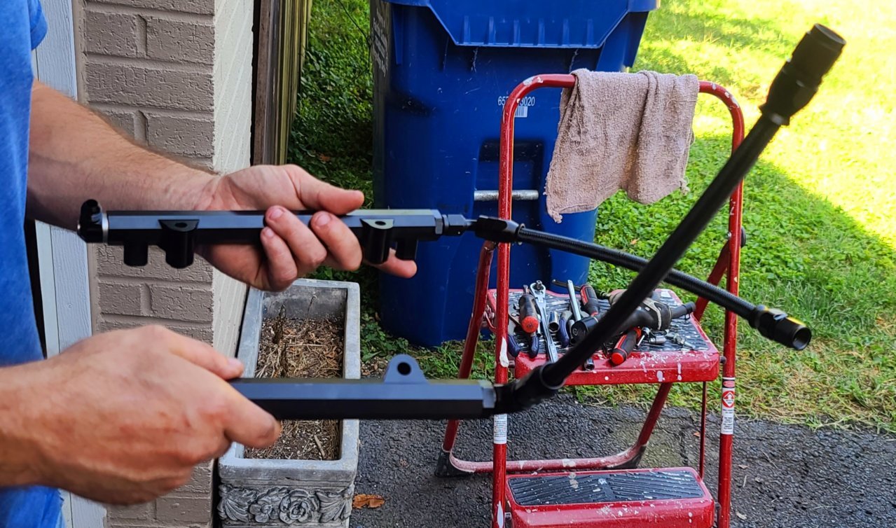

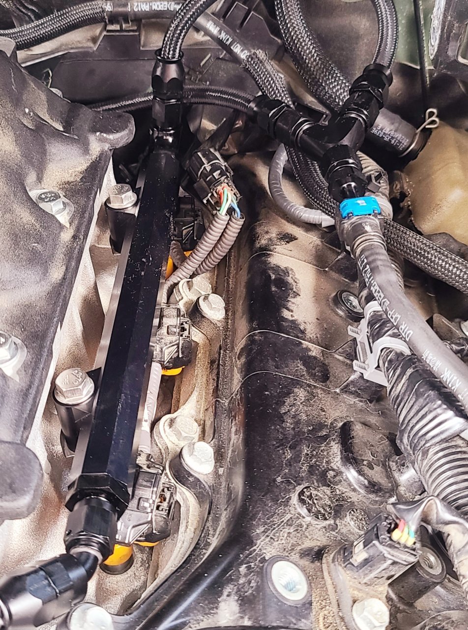

    Thanks again for being my guinea pig and letting me install these on your supercharged truck. This allowed me to proof and repeat the setup my tester used on the hose kit and now I can confidently start distributing to guys with superchargers.
    Hearing the results of a noticeable improvement upon install definitely gives me more confidence that these will be a benefit to everyone. I am absolutely excited to see the data from my tester that backs all this up and am anticipating a solid improvement with tuning.

    Did you notice any difference in fuel consumption with these rails vs oem?

    I just got them so I don't know. My avg mpg dropped down to 13mpg on my way home because.....to be honest I was extra aggressive because it was just too fun! I'll do a regular drive but also need an update tune for real numbers. I can honestly say that I am using the regular tune (not +) and it feels like I am using + and etc power.

    With balanced fuel delivery, it's going to be running stronger for sure, I'm not entirely surprised about that.

    "In theory", since we don't have the data yet, we should see an minor increase in fuel consumption since both banks will now be running richer, but I'd be surprised if it even changes the MPG.
    Then once tuned we should see minor decrease in fuel since both banks can be reduced to an efficient and safe AFR, but again probably won't see a change in MPG.
    Likely everyone's MPG will go down because of the increase in pedal action.....
    From what Virginiamarine told me about his drive, it sounds like we've also increased response by ensuring all of the injectors are getting equal fuel at the same time now. Prior to the rails, the last 2 injectors were likely seeing a delay in fuel delivery since they had to wait for the other 4 to take their drink first, plus the pressure at those 2 was probably decreased along with the flow. I saw an immediate improvement on my twin turbo's response and spool time.
    Additionally I expect to see less knock in the data since those last two cylinders will see more fuel now.

    All of these factors combined should yield an allowed increase in power as well, as a result of the balanced fueling, while continuing to provide safe performance conditions.
