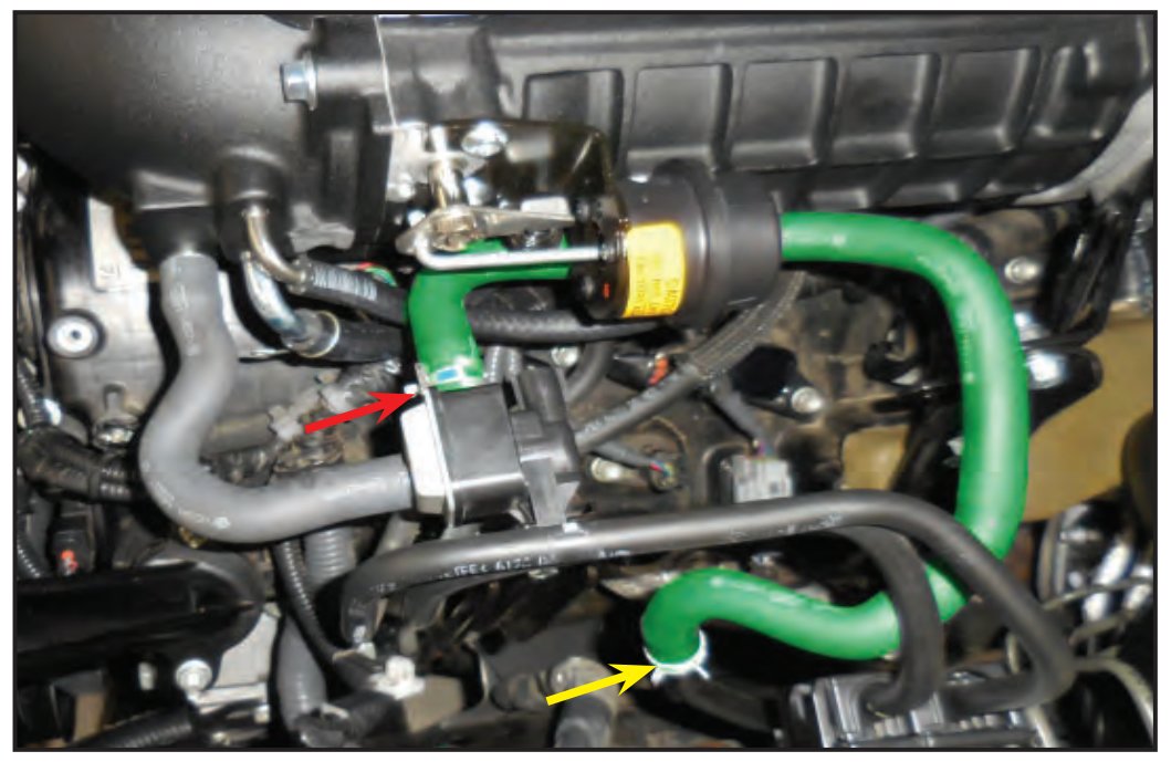

    Interesting. I will ask Justin for a look this weekend. That is surprising though considering how the S/C looks compared to Stock, which wasn't a horrible job.
    If so, bravo, Maggy!

    Well, hell. Look at that. Plenty of access. You can see Number 4 and 6 pretty clearly there.

    I was just looking at my engine bay to verify the access. To see them is one thing, to have access is another. Especially, when you need to squeeze the long extension for the plugs. Don't get me wrong, I think it's doable and it seems like even with the blower, there is more access than many cars out there. But it will definitely take more than 15 minutes.
    A few hoses and brackets will have to be moved out of the way to get full access. Especially, for the ones running a catch can.

    No doubt, but it looks like more room than stock. I did mine twice. It was about 90min give or take with the left side being the bigger pain obviously.

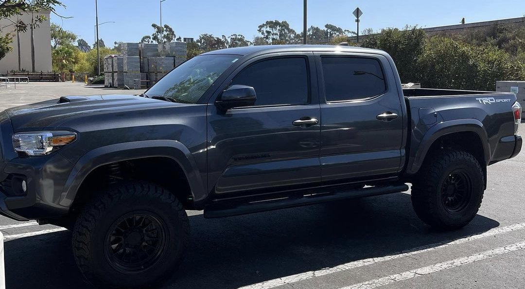

    Another Tacoma running right on our Blackhawk tune, courtesy of our YotaWerx networked tuner in Phoenix, AZ :hattip:this individual went with the Active Duty throttle as prep for the additional weight this truck will soon be putting on :thumbsup:
    Looking good!
