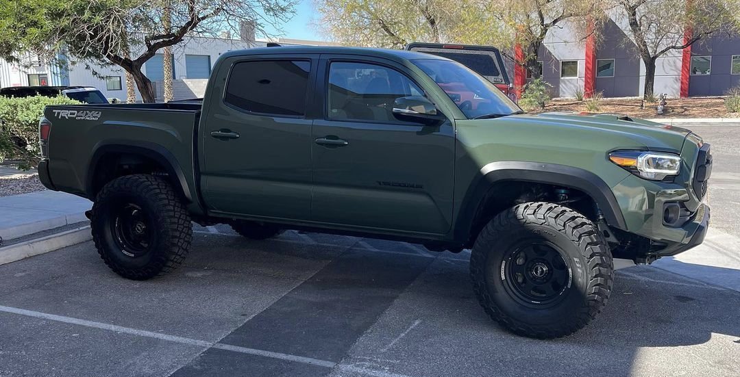

    Vince out in Las Vegas got his Magnuson supercharged 2021 Tacoma tuned on the Stryker tune this morning and noticed the benefits immediately, to include the superior transmission control, additional throttle response, and more power and torque throughout the rpm band especially down low where it's needed.
