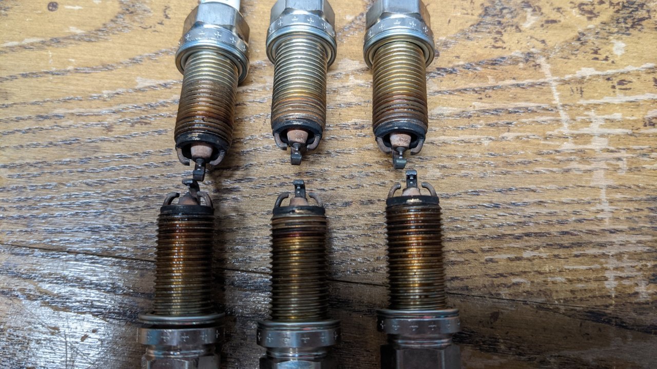

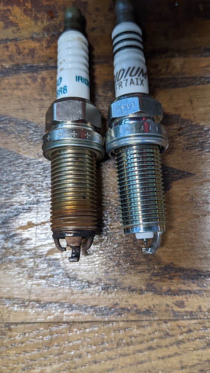

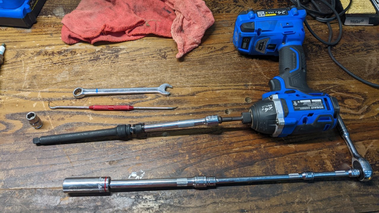

    I switched to colder spark plugs this weekend and also added the 87mm pulley and loaded the 87 tune.
    The whole thing took me about 2-2.5 hours at a relaxed pace with neighbors coming over to chat every now and then.
    The spark plug process was pretty easy. I could've cut about 20 minutes to the whole process if I started using a pick to get the connectors off the coils a little sooner. Some of the connectors were a little stubborn and the pick made it a breeze. A little less space on the driver side to get your hands through but still manageable.
    The 87mm pulley swap took about 10 minutes, pretty painless process.
    As far as the tune goes, I loaded the Stryker since that's what I was running with the 90mm pulley and I wanted to get a fair comparison. The difference between 87 and 90 is quite REMARKABLE!, especially at altitude. If you're on stock or close to stock weight and not at altitude, the 90mm performance might be sufficient. I have some weight and at altitude the performance of the 90mm definitely suffered. Still great overall and much better than no SC or SC with Magnuson tune. But the 87mm makes the truck move like the weight is not even there and it doesn't struggle at altitude.
    I've been thinking lately of different options to reduce some weight in order to gain some performance back, but now with the 87mm pulley performance I don't have to think about it anymore. I can keep what I have and still have a very responsive truck.

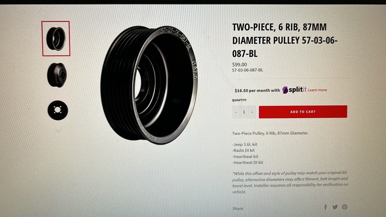

    @mZiggy what is the location in Santa Ana? I think I’m going to go there to get my truck flashed.
    Also, which 87mm pulley wheel should I get?
  17. Nov 22, 2022 at 6:57 PM
    #1017
    mZiggy
    mZiggy [OP] Honey badger
    Apr 8, 2017
    #215707
    4,709
    Marc
    2020 MGM Tundra SR5; 2020 4R TRD Pro; 2008 4R SR5 v8
    Our Santa Ana tuner is currently onboarding and is not yet taking customers.
    See below for part number on the 87mm pulley, should be the correct one if I'm not mistaken:
