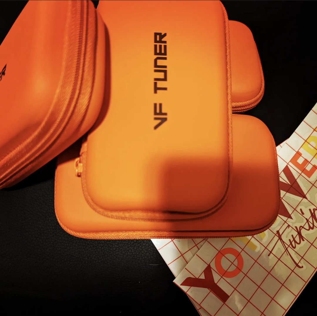

    More flash kit bundles ready to go out. Reach out today and take advantage of our Black Friday sale because these are going fast, nearly out of stock. Thankfully we have another batch on the way.
