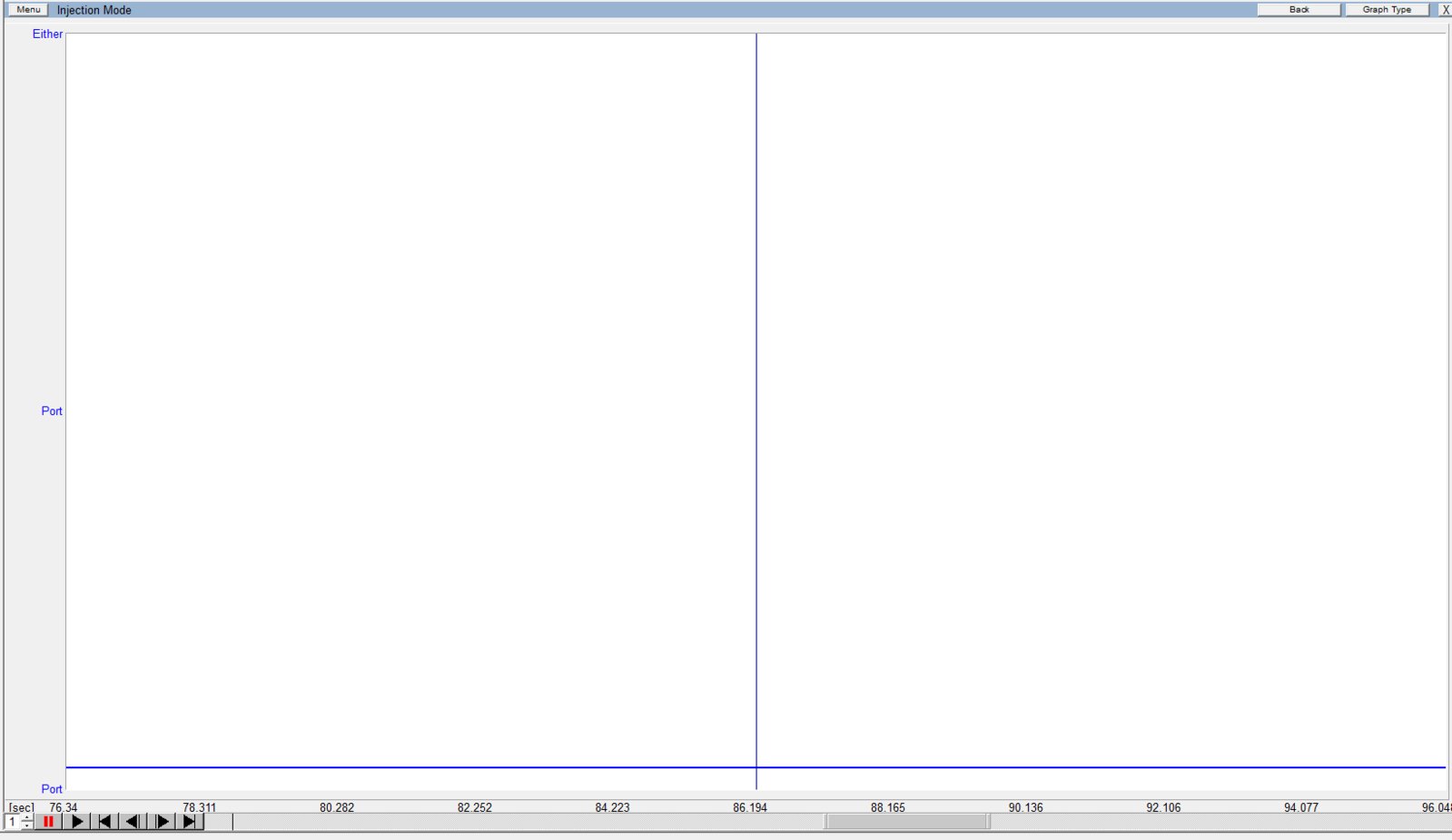

  16. Feb 12, 2024 at 5:27 PM
    #1316
    moon22
    moon22 :-|
    Dec 23, 2022
    #413879
    886
    SW Mitten, for the moment..
    '12 TRD OR ACLB 6MT
    FJ AWD Swap & 3G Pro Suspension
    So I did this - and all I got was a flat line in my log graph? It was showing live data, so I am not sure what was up with that. Unless this just means it was only in "normal" mode and not doing anything else.
    I did hear the cleaning chatter during idle after flashing to the 2.0 tune, so there is that! I'll disappoint everyone and say I legitimately didn't have time* for a test drive.
    * I live in a salt brined dirt road hell, and leaving the neighborhood in a manner that keeps satan's spunk off the undercarriage takes and agonizing 10 minutes...and coming back home takes another 10 minutes...so that quick round the block is a half hour commitment.
  17. Feb 12, 2024 at 5:40 PM
    #1317
    Vlady
    Vlady Well-Known Member
    Dec 20, 2017
    #238986
    4,434
    Issy, WA
    2017 White SR5 DCSB V6 4x4
    You should see a "fence" like picture when driving. Did you run it for 96 sec in Park? If the case, then it is normal to see Port only at idle.
  18. Feb 12, 2024 at 6:27 PM
    #1318
    moon22
    moon22 :-|
    Dec 23, 2022
    #413879
    886
    '12 TRD OR ACLB 6MT
    Ah, well MT so idle in neutral, but assuming that's the same. I ran it for the duration of the timer that was at the bottom, something like 2.5 minutes? But doesn't the 'cleaning cycle' only occur at idle, so were I to drive, it wouldn't show up?
  19. Feb 13, 2024 at 3:18 PM
    #1319
    Vlady
    Dec 20, 2017
    #238986
    4,434
    Issy, WA
    You need to drive for 20-30 minutes to see the cycle.
