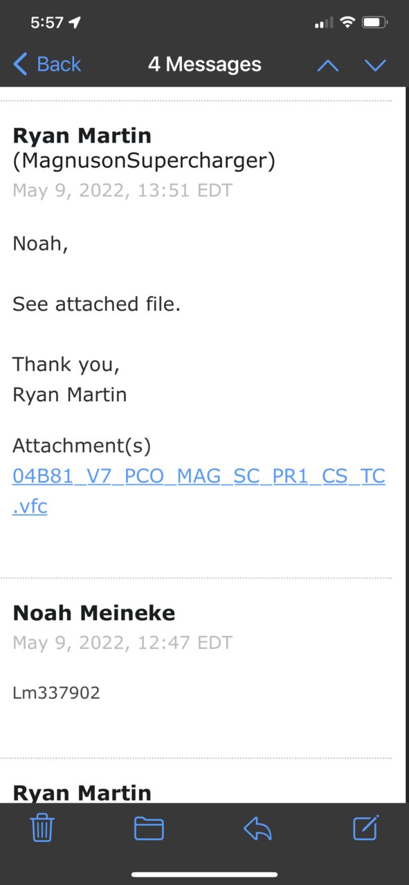

    547AB186-CA11-490F-9B15-D204C126703D.jpg Based on the tune file name is my ecu Id 04b81?

    #126
    Murd3rd
    Murd3rd I believe I Toyota harder than most
    May 5, 2011
    #56111
    1,010
    Your Mom's House, USA
    00.5 Reg Cab Slammed, Turbo'd/19 TRD OR 6MT S/C
    1st gen - it's got a built engine, a turbo, and waaaaaaay too much to list. 3rd gen - basic-bitch lift, S/C, Pro Wheels
    Yes
    Zoey'sTaco[QUOTED] likes this.

    You can use the VFTuner software to identity your ecu version
