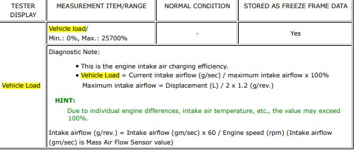

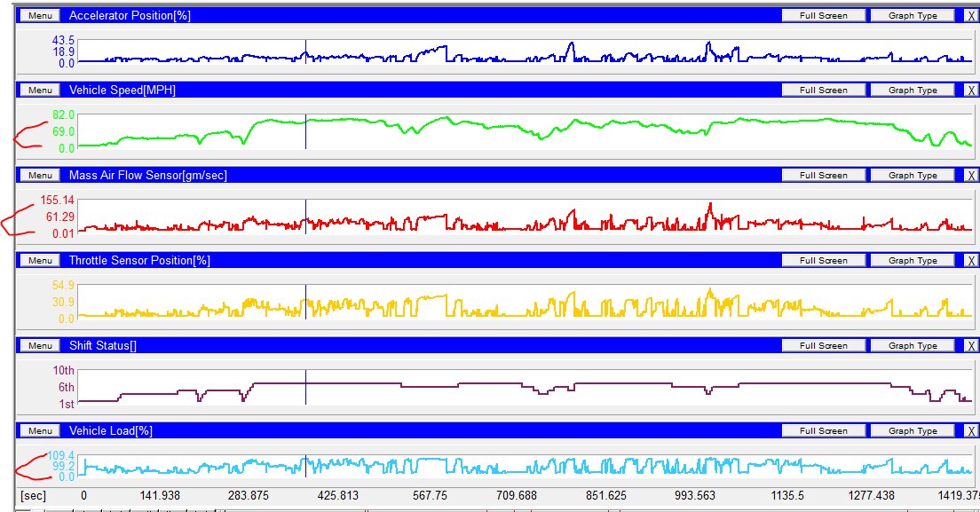

    @TACO-TY
    here we go. Summer 2022. @RPMS 1786 69mph
    Vehicle load PID (volumetric) at 99%, Calc Load 94%. I'm sure mpg bar was pegged left. Thats why I prefer the downshift

    I also prefer an earlier downshift to keep the engine in a usable powerband. If you really thing about how little power the engine is making at say 1600 rpm, increasing load isn't going to help matters. It's better to get some gear reduction and kick the rpms up a bit.

    There's a big old 'it depends' tagged on to that.
    I can climb in 6th at 1,100rpm, be grazing pedal, and have no issues.

    Oh, absolutely conditional. Agree there fully.
