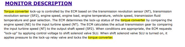

    Just for clarity, the setting is being asked to turn off is not fully locking/unlocking the converter. The setting activates the lockup solenoid, the converter is in "slip" mode. The full tc lockup is managed by ECU based on many parameters.
    When lockup solenoid is activated, the trottle plate closes regardless of your accelerator input. Thus causing a stumble while accelerating.
    Disabling lockup solenoid in 3rd has an adverse effect on AT2 temperature (tranny valve body/torque converter temperature). It will go up pretty fast. You are driving in fluid coupling mode.
    If you are staying in 3rd alot for towing or driving under a heavy engine load, you need to consider asking developers to review speed values in for 3rd gear to elevate them to avoid engagement and stumbling at lower speeds, say below 35, and engage above 35 to keep AT temperature happy.
    In 4th, I do prefer an early engagement to avoid the throttle plate closure in the middle of acceleration, and I stay in 4th for driving under heavy engine load..
    The other issues, 3-4, 4-3 shifting needs a focus. Minimal downshift/upshift speeds are not right. A slight accelerator input (1%) is causing shifting.

    Thanks for TC edits for 2nd and 3rd. Acceleratoration is much smoother now without dips.
    4-3 downshift speed for 0 accel is to high in my opinion. I shared numbers with you. Truck drops to 3rd at 27-28 mph. I have not had any issues so far with 3-4 upshift.
    Yes, ideally lockup solenoid engagement should be optimized for a specific speed range to avoid its interference with normal day to day driving.

    You are experiencing a full lockup of TC. Also depends in the throttle limits tuning for gears. Same accelerator input in 6th can produce a different TP in 5th.
    If you downshift from 6th to 5th, TC will be in a partial locked for a few seconds and then go to fully locked.
    Partially locked state only exists in a very small speed window.
    Ideally, we would like to extend the partial lock state and/or activate the partial lock based on the throttle inputs. This condition exists in KDMAX, but at lower speed (<50 mph) for a few seconds. I have not seen a partial lock in speed above 60, unless those tables are altered. However, there is a toll on the AT2 temperature.
    I doubt tuners have access to control this.
