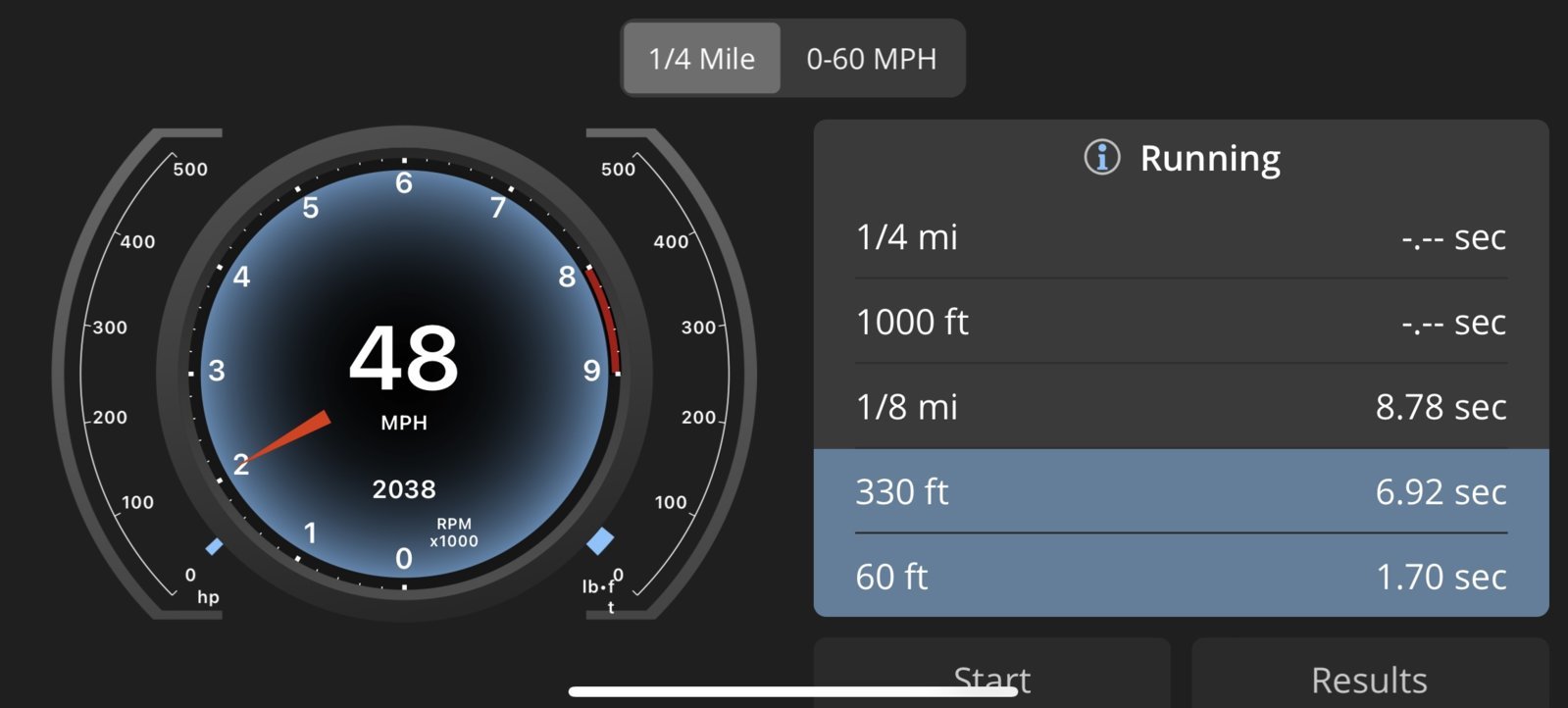

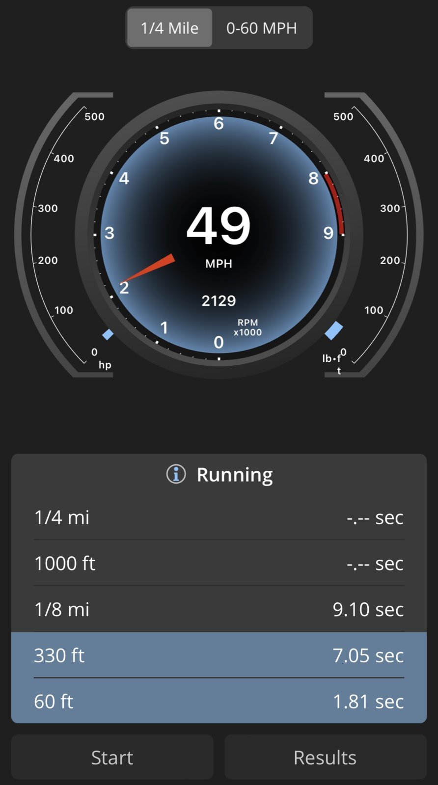

    I wanted to share this just in case, there was someone out there on the fence. Jump off and seek your local YW tuner!!!!
    Huge thank you to @Mcbelen for such a stout tune I’m enjoying as time goes on, and @805 Tacoma Tuning for being a good guy and YW tuner.
    So take this for what’s it’s worth. DISCLAIMER: My SR5 Taco rolls on 245’s :anonymous: About 100lbs of gear, and 3/4 tank.
    Taken from Fusion(gps is shockingly damn close to accurate), the BH 2.1 AD+ allows the 3.5 and 6 speed to give the driver some fun feelings. Hovering at 17.7 or so on average for mpg’s flooring it like mad on the most recent tanks. Good gas mileage otherwise.
    Great all around tune with STOUT torque for a quickie go from a stop with a heavy haul, trailer, or in 4LO. Cat like reflexes that quickly turns into a tiger!
    And yes, it can be repeated. 2WD-76 Premium (with a quart of 5% Nitro/ALKY leftover fuel from the race season poured into a full tank…just kidding:0) One more logging show to go at White Pines at the end of this month. I was only concerned with 0-60, so that 330 was off some. Get it for the sake of the 2GR-FKS and them mini van smack talkers!
    Shiiiiiiit.

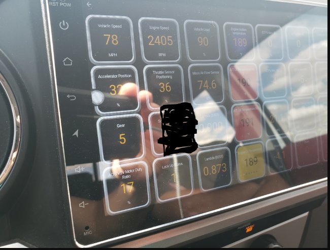

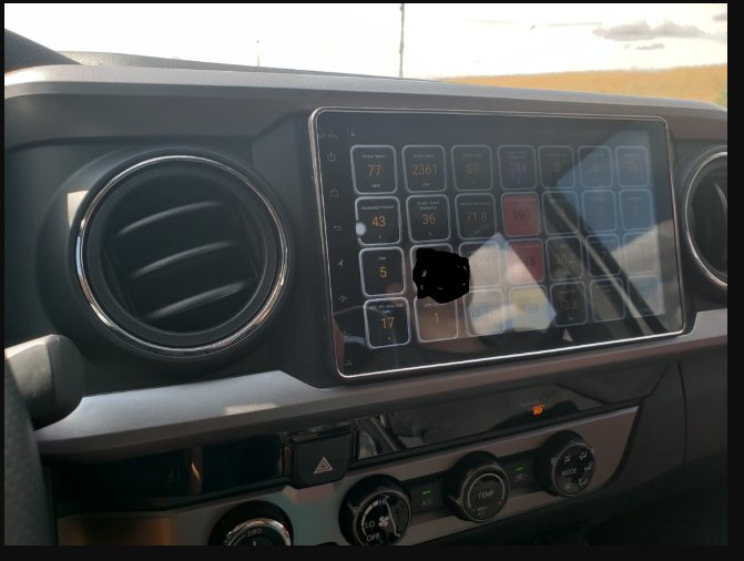

    I worked with @Mcbelen to address the stumbling issues in 2nd and 3rd gears. Not sure why, but it took us five iterations to resolve it. Also improved the premature downshift from 4th to 3rd gear at zero accelerator, which now occurs in the 24-25mph zone. All these helped with slow speed driving. I had promised the opportunity to test the tune in the mountains and high speed conditions
    While driving up long inclines, mt pass and against strong winds, I used S5 because 6th gear proved ineffective above 75 mph in hilly conditions. During this, I encountered the limitations of 5th gear: the throttle is capped at 36% at 2300-2400 rpm. When driving over rolling hills at speeds of 75 mph or more and beginning to accelerate, the throttle position sensor would reach 36%, yet the engine load would remain at approximately 90%. The ACIS was activated.
    The truck is not accelerating and losing the momentum(speed, rpms), causing you to apply more accelerator. The accelerator reaches 43%, yet the TPS remains at 36% and the MAF is around 70 g/s. The knock feedback then falls below -4, causing the KCLV to drop to 20. Continuing to press the accelerator meets the conditions for a downshift, not to mention that the downshift point is too high, and you would need to use the stick to force the downshift. 6th gear has same issue, by it does not take long to downshift.
    In my opinion, the load can be safely increased to 97-98% to maximize 5th gear performance.
    I also see premature 4-5 upshift at around 20% of accelerator.
    I think the tune is still raw and needs some work. The power is there, but is not delivered in efficient way. The tranny tuning was neglected.
    Terrible mpgs, but I did know that already.
