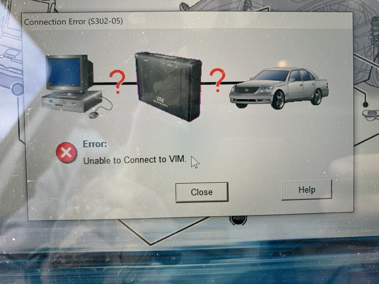

    Tried this. Seeing this:

    I’ll be sticking with 04A70 if it works. My local Toyota will not touch my Tacoma. It’s hard to get them to do recalls. I do not trust my techstream copy.

    Do you have the ignition on (engine not running)?

    yes
    bbut it worked
