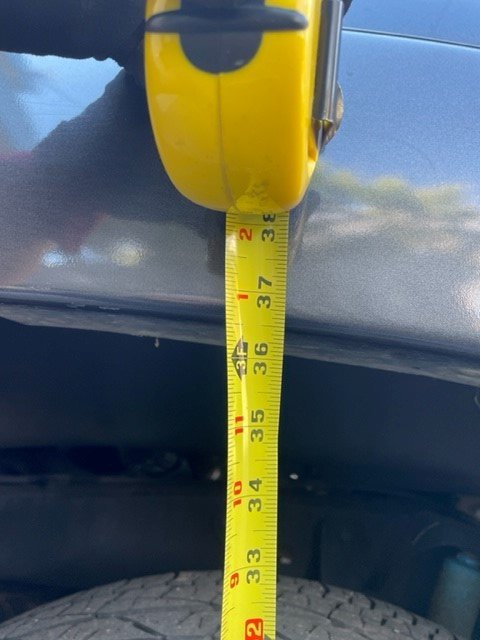

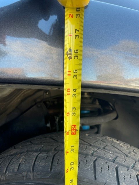

    i could SWEAR that other people's stock tacos ride higher than my stock taco, despite what other people have told me. you have a tape measure? i do, and took measurements at both axles.
    so i'm just curious... where's your fender at on your STOCK taco (can't remember which is front/rear, but i'm just trying to get a general idea anyway)?

    Measuring from the pavement to fender is useless since people run different tire sizes.
    Measuring from center of hub to fender is better because that won’t change based on tire size alone. Stock is something like 21” hub to fender front and like 22” rear (don’t quote me on that, going off memory).
    Also depends on age of your suspension. My stock junk was sagging badly causing loss of height.

    Like mentioned you have to measure from center of hub to fender. My bone stock 2020 SR 4x4 is front 21.5" and rear 22.5

    2nd Gen is 20 inches front and 22 rear Center of hub to fender.
