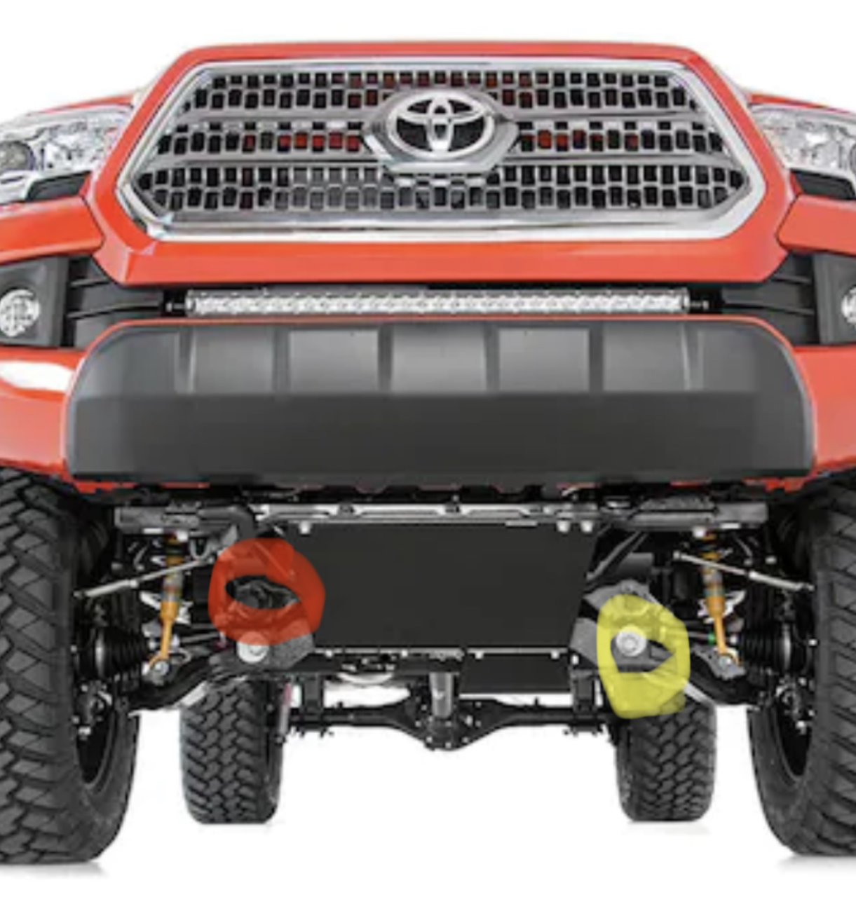

    For what reason would you need to cut your frame?

    I heard on the 6” lifts. You have to put a frame extension. It just takes your lower control arm and diff, and brings it down so you won’t have crazy cv angles. And to install that “cradle” you have to cut your factory frame.
    here is a rough picture. The red is where the factory lower control arm bolts to the frame. And the yellow is the “cradle” and where the lower control arm bolts up. And to install that cradle, some cutting is needed
