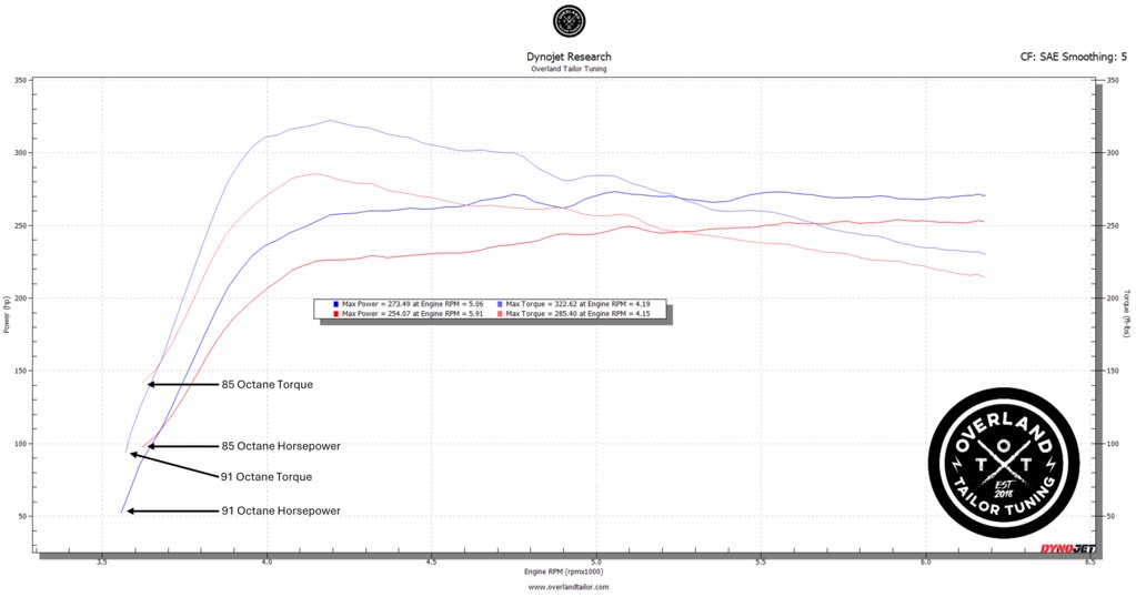

    Testing on our newly acquired development 2024 Tacoma has shown some pretty shocking results in the difference between 85 Octane and 91 Octane (here in Utah). Same truck. Same dyno, 1 week apart.

    What are the different color plot lines?

    Amended the image above.

    Yay, some real data, thanks for posting this! I'm assuming other variables like ambient temp were similar. That's a 7.5% increase in HP and a 13% increase in torque. More than I thought there might be (and debunks the theory that it doesn't matter at all). It doesn't quite seem to make up the difference in cost for those who only care about that, but it does show that there is a difference. Probably matters more on the 2024 with the turbo.

    I wonder what mode the dyno truck was in for the testing?

    85 Octane (Red) was done in: 85.10degF, 25.93in-hg, Humidity: 27.55% for an SAE Correction of 1.18
    91 Octane (Blue) was done in 72.50degF, 25.58in-hg, Humidity: 38.08% for an SAE Correction of 1.18

    Normal - for these specific tests.
    I don't think we'll see any difference in actual peak output between the modes, but we'll be conducting testing to validate that.

    this is actually a lot more interesting big picture. No one's done any videos on this for this engine, despite its widespread adoption by Toyota. You guys could put together a cool YouTube video. Even if it's just the discussion of the results and the implications.
    It's really eye-opening to see the difference in octane and output even on stock. You'll always hear people that say hey I run 85 octane at altitude. Yeah well I have too in an 11:1 compression engine that's naturally aspirated. But a turbo is not the same.
