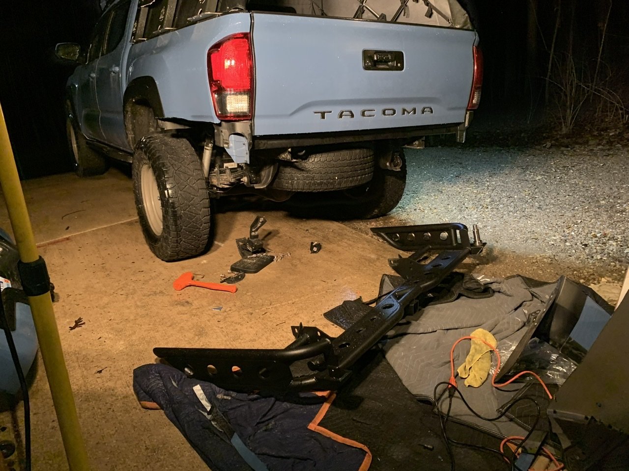

    Kind of in a holding pattern right now. Bumper is pretty tight against the frame so might have to wait till tomorrow afternoon. Plus it’s raining pretty good and my anger levels are rising lol

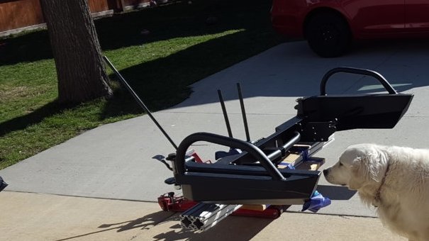

    If you have a motorcycle lift and some 2x4s handy, I fashioned this to make lifting the bumper into place a breeze
    I did have to remove my rear tires and rest the rear axle on some short jack stands to get the frame low enough to jack the bumper into the mounting location

    This was about right lol
    Until @TacomaDad18 showed up and everything fit nice lol
    took a couple hammer hits. But it’s all mounted up. Cuts are weeee bit high. But not terrible.

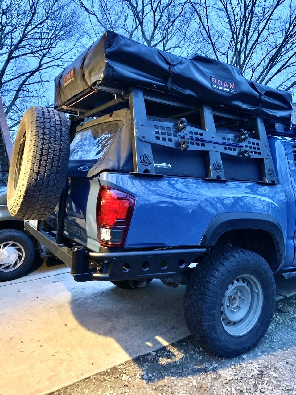

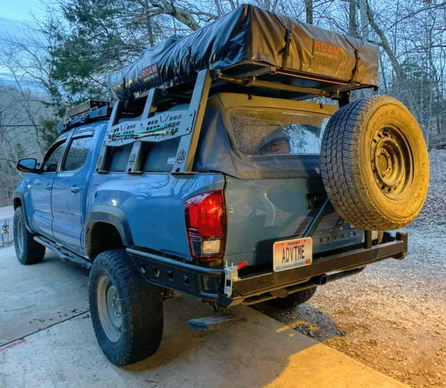

    Oh...
    Pictures. Hmm

    That looks really good man!!
