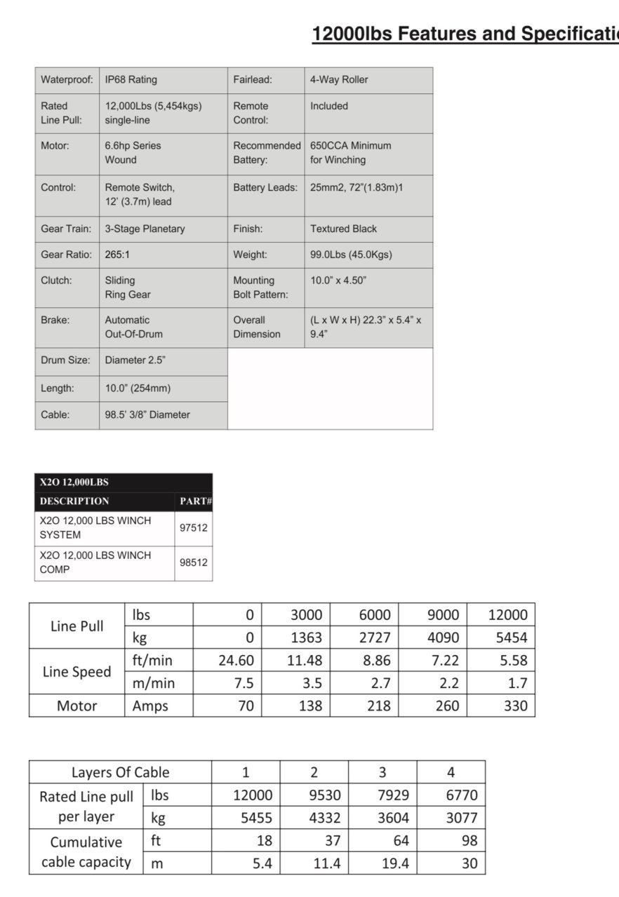

    The 12k I’m referencing is the smittybilt 12k X20. It’s the same exact form factor as the 10k, except the gearing is lower, so the only downside is the pull speed will be a little bit slower.
    If that wasn’t the case and the only option was one larger/heavier then I agree it wouldn’t be necessary. Since it’s such an easy option though, why not? That’s why I’m saying it’s a valid option. You may have missed that though from the convo earlier.

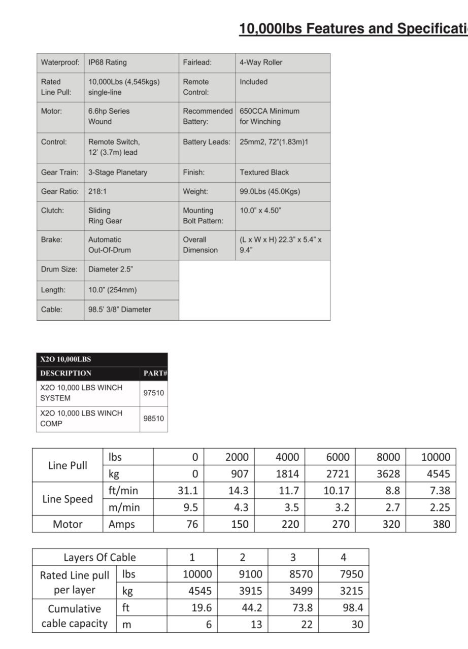

    Interesting. They are in fact the same size, but with 4 wraps on the drum the 12k is rated for less weight than the 10k. I wonder why that is.
    Edit: and that 99lb weight is with steel cable. Will be around 75 with syn

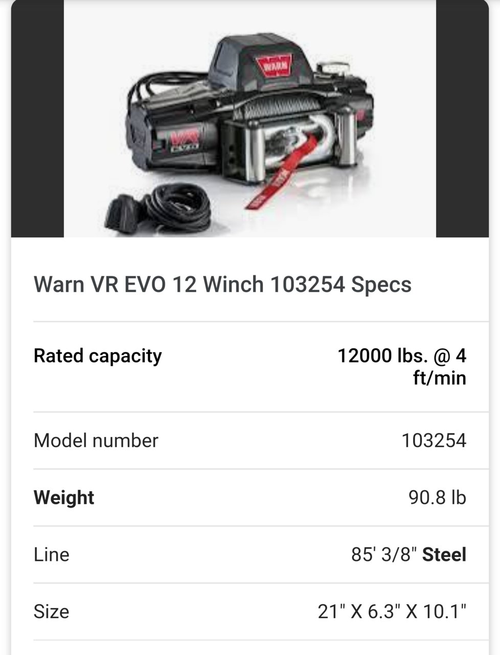

    I just checked, and the Warn Evo12s is only about 20# heavier than the 8S.
    With the weight difference being so insignificant, I can't really see a downside to going bigger.

    Where are you coming up with 100+ lbs?
    How is anyone losing clearance by running a heavier rated winch? The 8, 10, and 12K winches all seem to be about the same size and weight.

    You keep mentioning the increased size and weight but the winch we’re discussing is identical in size and weight to a 10k. And yes, less strain on the battery. Comparing a 6k pull between the two winches, it’s a 52 amp decrease for the 12k.
    Regarding snatch blocks, you say the purpose is for an easier and slower recovery. That’s literally what the 12k is doing except it’s all built into it because it’s inherently slower, and easier on the winch.

    The dimensions on the Warn EVO 8, 10, and 12k are the same
