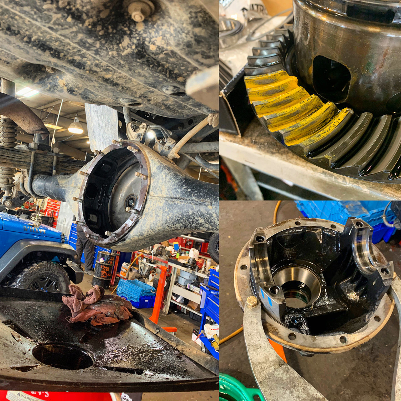

    Lol, come try it!
    I know that I have very little to go on, but this Warn EVO seems to be a pretty solid unit. I'm hoping to not really need it much, but I feel pretty confident that it will get the job done.
    I'm looking forward to hearing your feedback after the re-gear. It looks like the shop knows what they're doing.

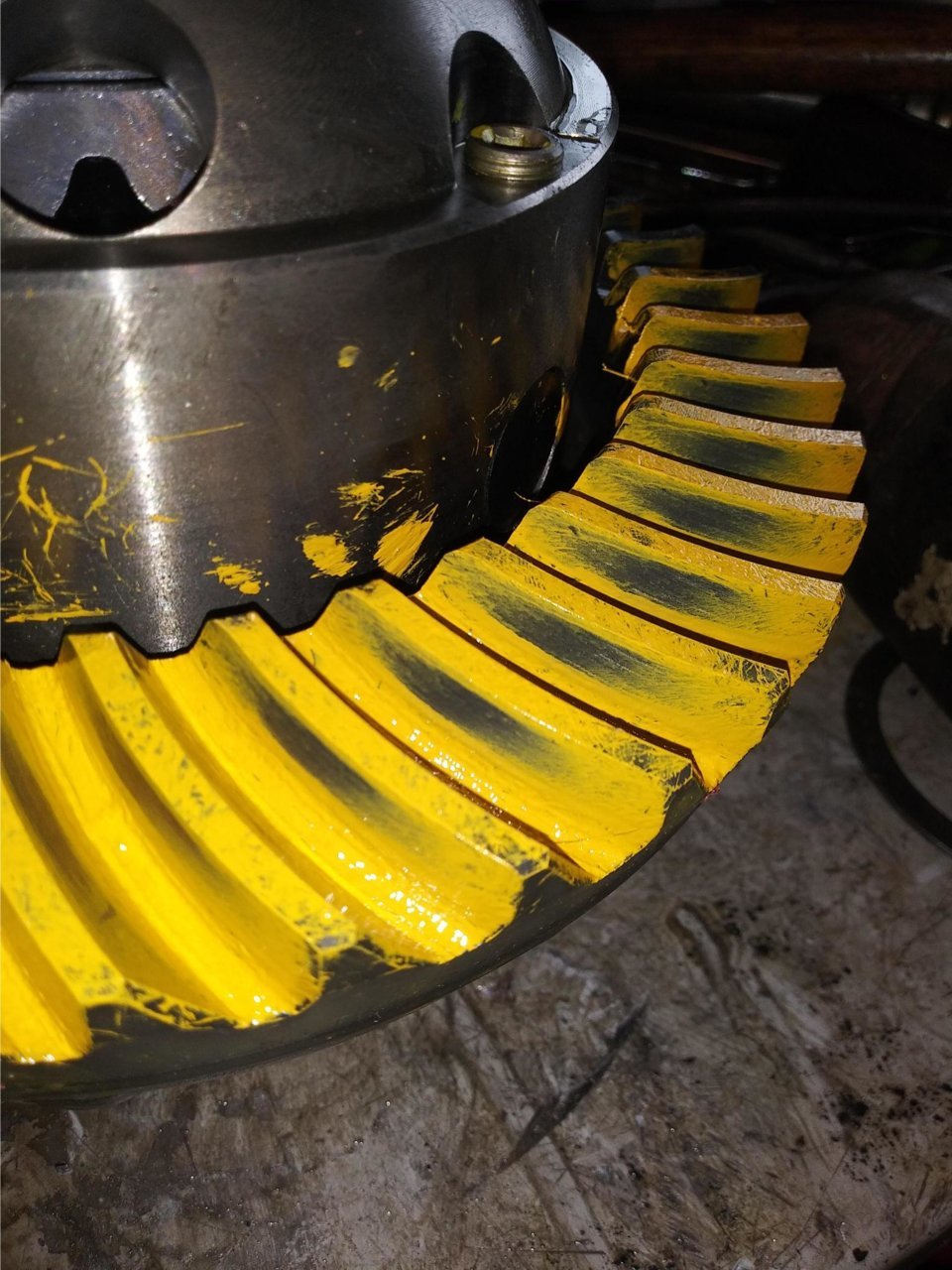

    Oh yeah. They’re sharp.
    Actually.. that’s just the oem gearing still. They do a paint pattern prior to removal to see where Toyota has it set.
    So they have a general idea of where it needs to be factory. Then they’ll tighten that up .001” so that during regular driving the pattern is a little tight, and when off-roading under a load, the pattern actually would be perfect.

    I remember my buddies trying to explain that to me a few years ago when one of them was building an old Trans-Am. It's pretty interesting, for sure.
