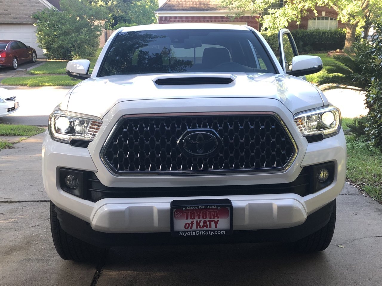

    The title speaks for it self, but to add some substance. I have a brand new Tacoma 2019. Came with yellow halogen bulbs, I replaced them with DOT certified LEDs. The beams do not look like they need to be adjusted as they line up with the old bulbs against my wall. Pulled up to a smaller Sedan and the beam was below their back windshield. Visibility of the road is 100% better!!
    I live in Texas, do you think I’m a moving target to be pulled over since most bulbs I see in the road are halogens therefore mine seem to shine brighter than most on the road? Might sound paranoid but I dread being pulled over for silly stuff like this. Too old to be a troublemaker lol
