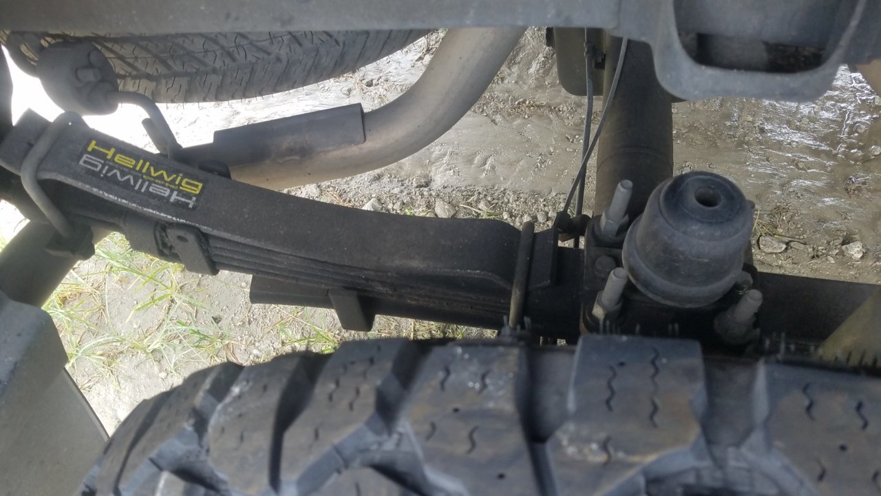

    I've been running the Wheelers Offroad 3 leaf progressive aal. I left the overload in for 2 inches of lift. The ride is leagues smoother than the single Toytec aal I ran on my last Tacoma. Now, about 8 years later, I started noticing a sloppy rear and some sagging. I've since slapped Hellwig 550 helper springs on as a bandaid fix until I can upgrade the entire leaf pack. The helper springs do indeed stiffen up the rear and eliminate some of the slop. 20210628_135419.jpg
    208Yoda and Pearson[OP] like this.
