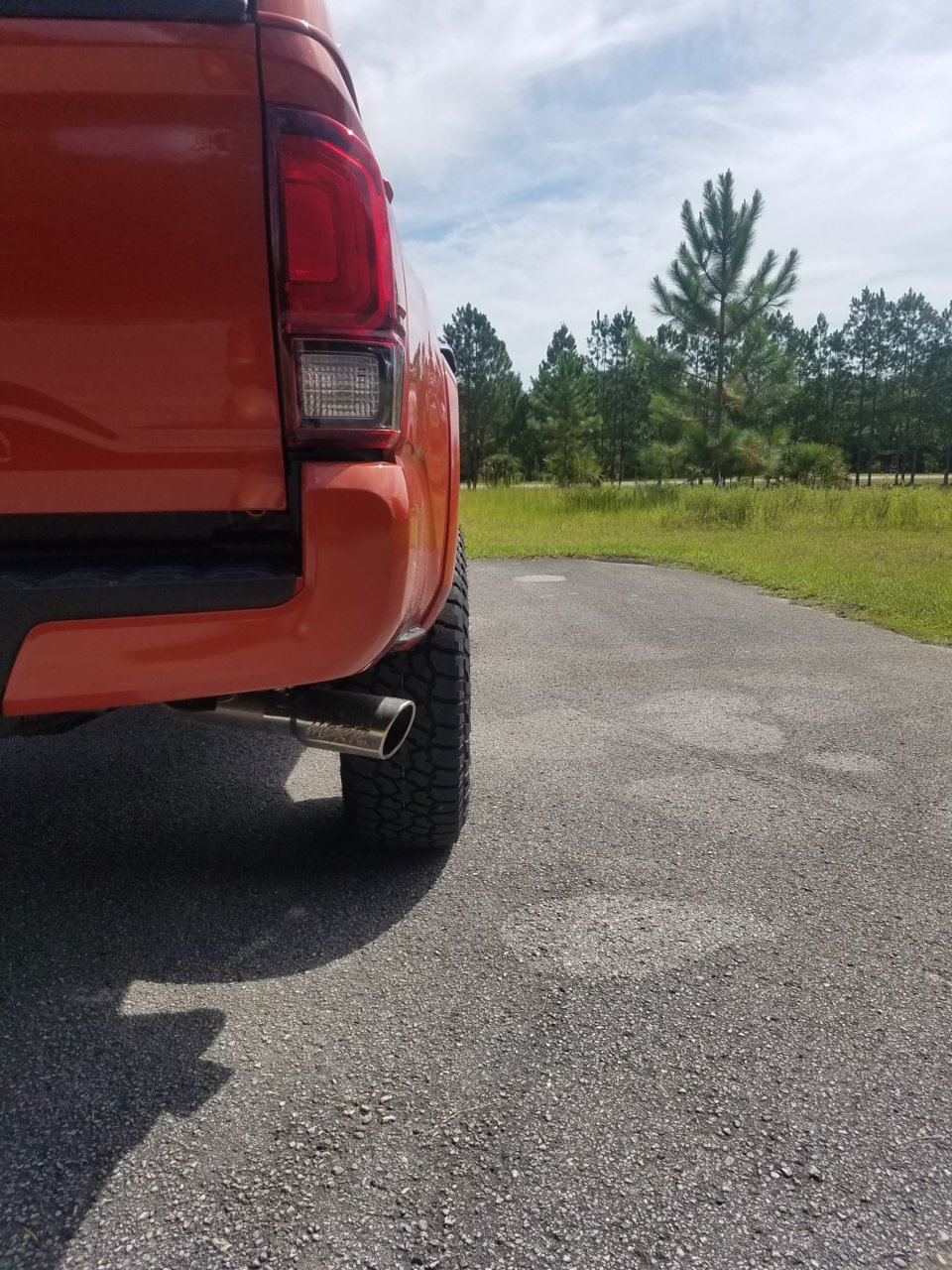

    Im using them now, Spidertrax 1.25. Only about 1000 miles on them, no issues. You will be fine as long as they are hub-centric.20180821_110517.jpg 20180821_142714.jpg
