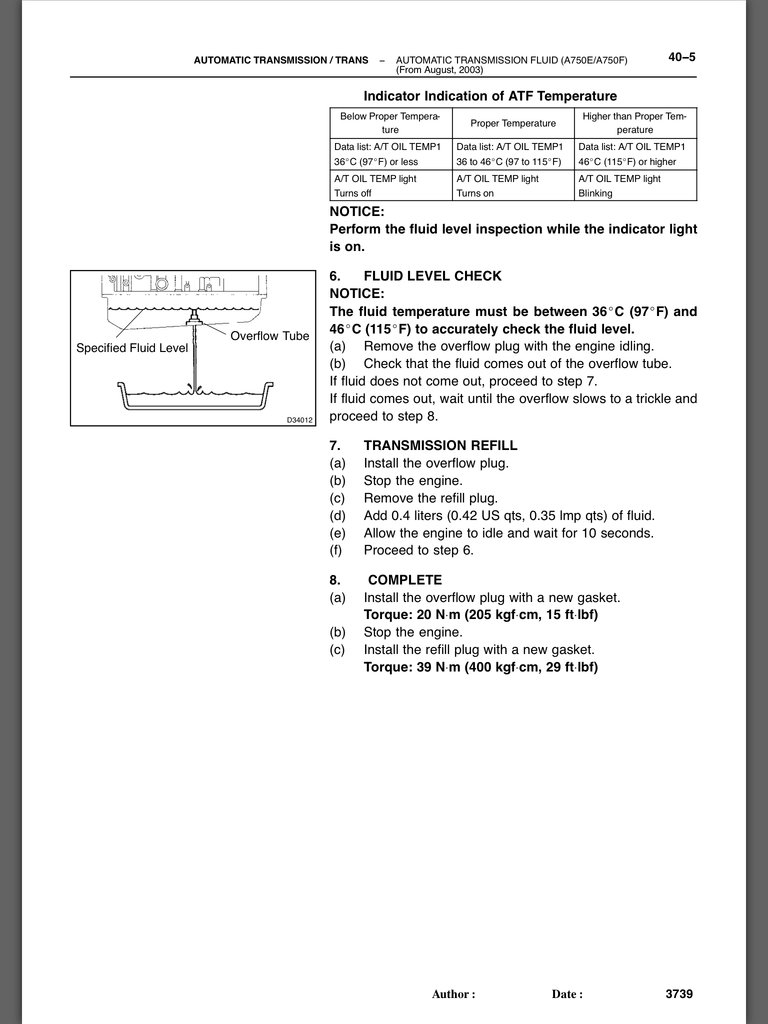

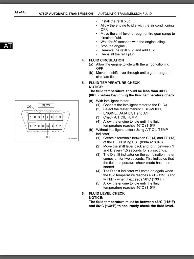

    I have seen this mentioned a few times but No clear answers. Conflicting temperature checks. I have a buddy that is a tech and insist that temp check is 97-115. My Haynes manual says 97-115. Multiple excellent write ups on this forum state 115-130. I have a 2012 TRD Sport 4.0 4X4 with Tow Package and I'm going to do the drain and fill for the 3X and every time I do this I rack my brain about the temperature differences. Anybody have ideas to why these are differing? Thanks in advance for your help!

    I'm not sure why there's a difference in the stated trans temps so I just shoot for 115 and know that's going to be close.
