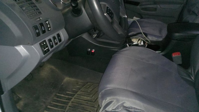

    Here's what I went with.
    Out of the way and still easily within reach.

    Did you follow a guide or something for running the wires? I'd be worried about the side airbags, plus I don't know how to remove the panels w/o accidentally destroying the clips.
  9. Oct 29, 2014 at 6:13 AM
    #49
    geekhouse23
    geekhouse23 The "Liftman" - @DrFunker
    Jul 14, 2013
    #108251
    15,700
    2GMGMDCSB4WDTRDFTMFW!! TL;DR
    mostly stock, grocery gettin' Prius
    I ran the wires toward the windshield, ran them along the windshield and down the A pillar using zip ties attached to the existing wire loom already running down it from Toyota.
    Quick google search yielded this:
    http://c-lution.com/2013/01/08/2005-2013-toyota-tacoma-overhead-cb-install-with-easy-removal/
    VERY similar with what I did.
    I have this kit for removing trim:
    Works great. You definitely want plastic over metal.
    RIDER34 likes this.
