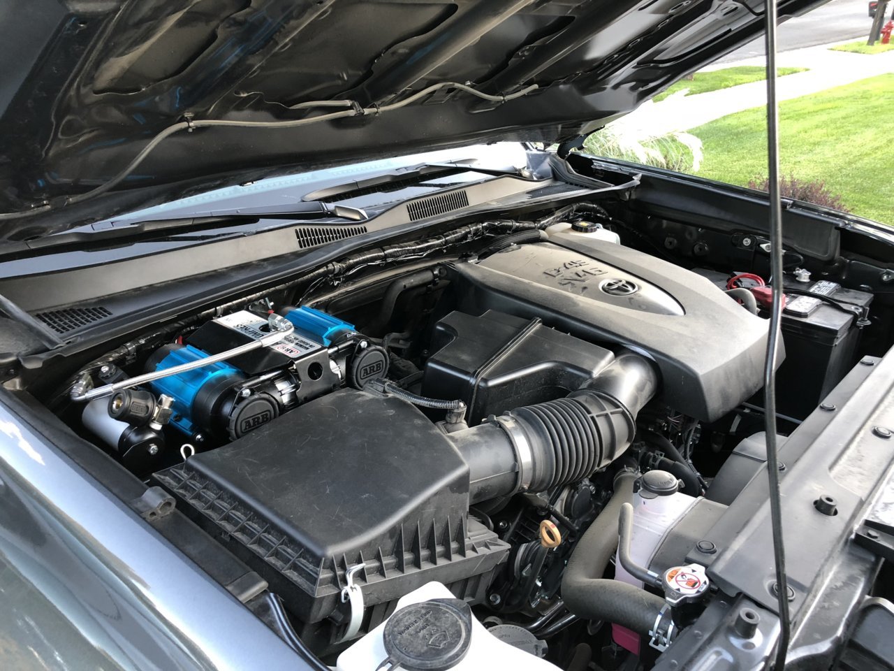

    I have mine under the hood for 2 reasons. 1) there is no driver's side cubby on my 2019. 2) I use mine for my front locker and didn't want a full truck length of hose to get nicked and start leaking.

    Much more convenient under the hood for me. Wiring simpler, mounting simple, easier access to air chuck, protected, and closer to front air locker.

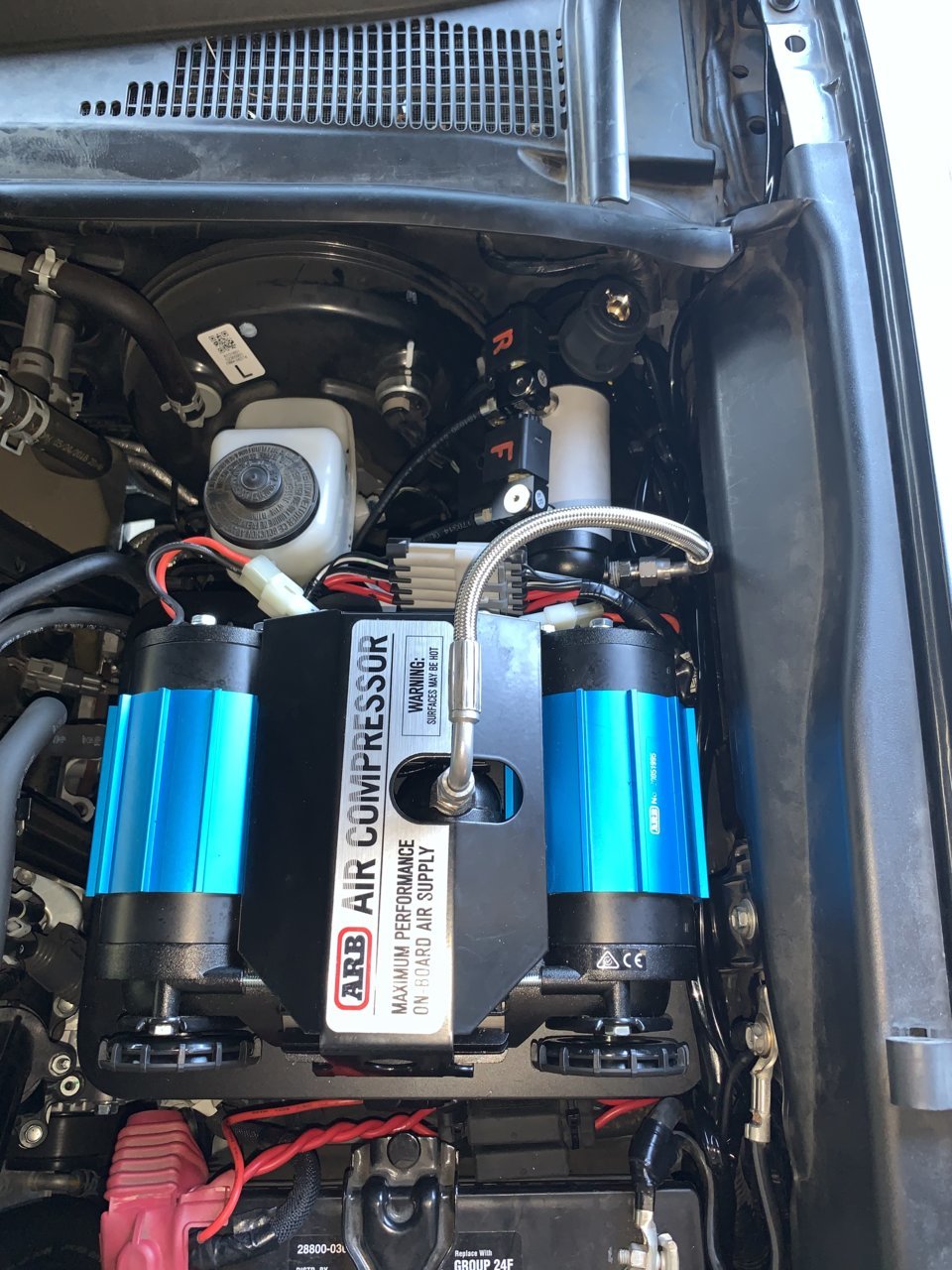

    I put the 1 gallon ARB tank under the dual with the slee mount. I like how compact it is. Only pain was cutting apart wiring harness to use with switch pro. I scrapped everything but the power, ground, fan ground, and remote power on/off.

    I don’t have the driver side rear cubby, so under the hood was the best option for me. I think all brackets whether in the cubby or under the hood cost about the same but electrical wiring seems more simple under the hood.

    I love mine and I mounted under the hood because it made sense to run my front locker and after looking at both spots it came down to temp cycles under the hood or a deluge of road/trail debris with the rear bedsides. Now I want to run an airline to the rear of the truck.

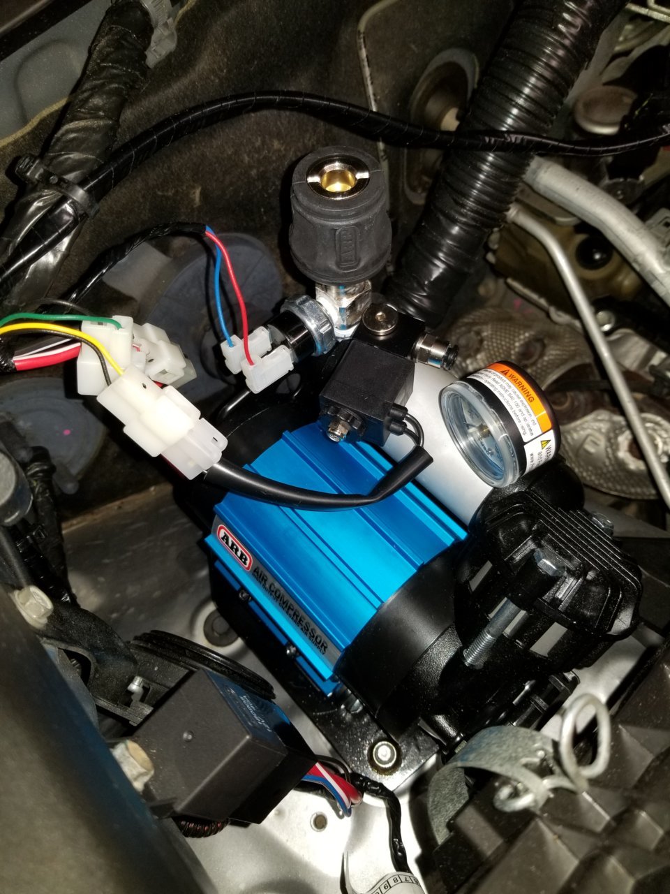

    here is mine that I copied the idea of a regulator from @WrecklessAbandon
