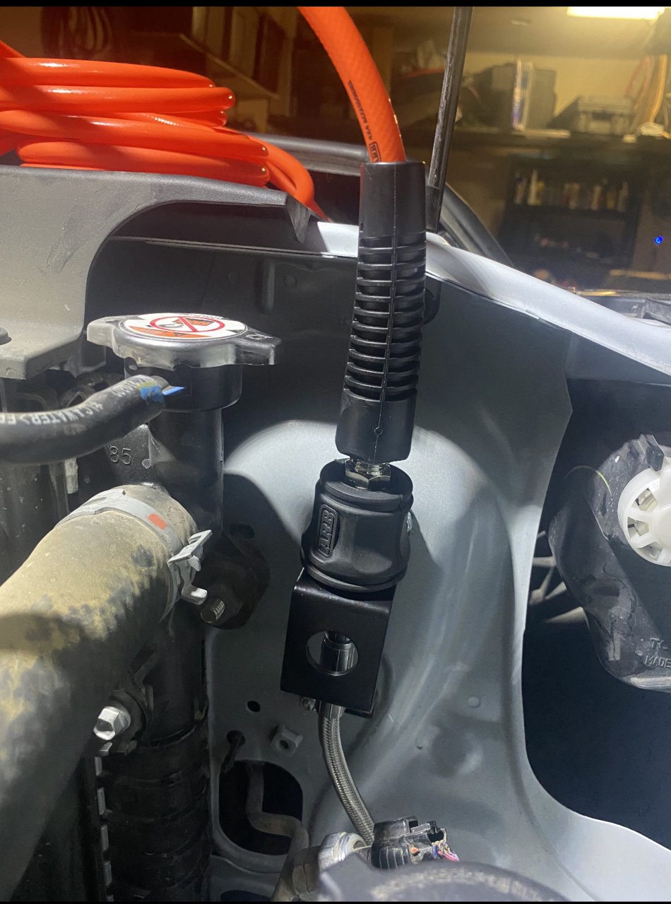

    #67
    Traction
    Traction Well-Known Member
    May 23, 2016
    #187673
    1,321
    WA
    2020 TRDOR
    I ended up with this setup:

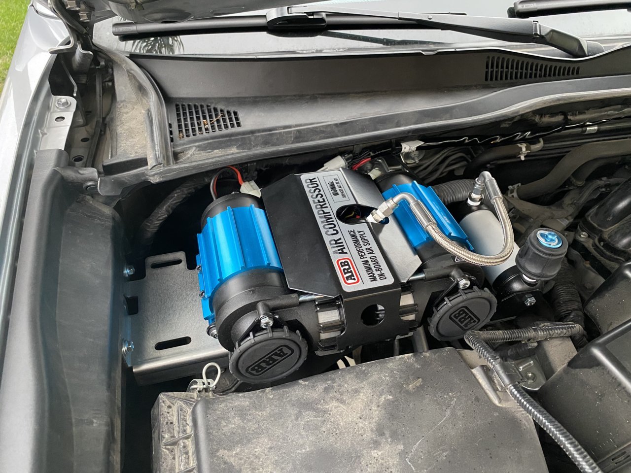

  13. Jul 11, 2022 at 11:52 PM
    #73
    Baja Action Drone
    Baja Action Drone Do cool stuff, rinse and repeat!
    Apr 29, 2018
    #252033
    61
    Gregory
    2021 TRD Off Road Access Cab
    Front ADS 2.5 Coil overs RR w/Clicker. Rear ADS 2.5 piggyback, Camburg 1 1/4 Uniball UCA's,Camburg LCA's Camburg Performance Spindles, Deaver U401 Stage 1 Leaf Pack, BAMF Greaseable Shackels, CaliRaised Rock Sliders/Overland Bed Rack, Method 305 Wheels, Borla S-Type Cat Back & uuuuh, various Pods, Light Bar Rotopax..........
    I got this installed under my hood last week and am stoked! I bounced it around on Chimney Rock in Tucson Sunday and aired up WAY faster that my old trusty portable. I went with the MORE Mount under hood location, because this warlock fits perfectly in the engine dead space. Cheers!!
