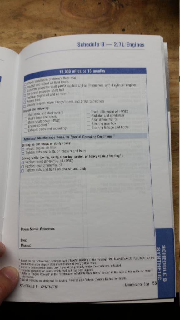

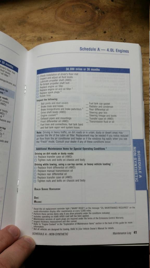

    It's in the warranty and maintenance book. Notice where it says schedule B 2.7 L at the top. On the side schedule B synthetic.
    Schedule A 4.0 L, non-synthetic.
