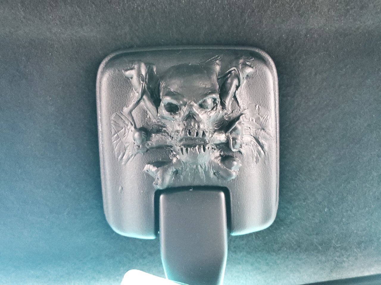

    Yo dudes. New here.
    Anyway, big Beksinski/ Giger fan so I did a little epoxy putty sculpt as a test run before blacking out my interior.
    It's holding far better than I thought to the vinyl so we'll probably be adding bits of similar texturing around the dash.
    Probably only be helpful to other weirdos but if you sculpt something and run lighting behind it, it could make for some cheap but heavily detailed interior mods.

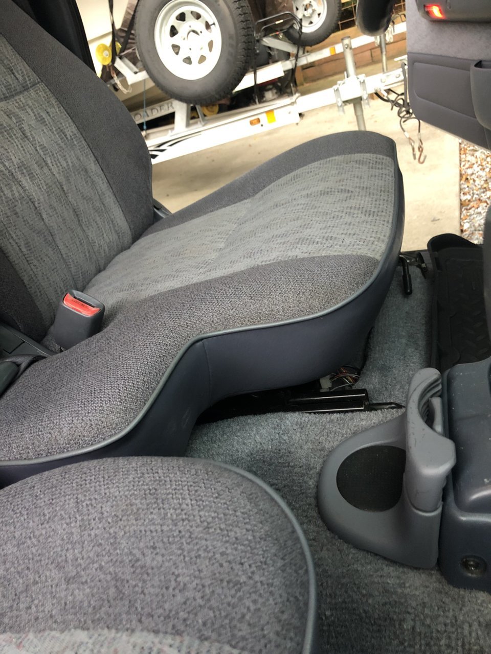

    I've got the double cup holder. Never slammed the seat forward, but I did an experiment to answer your question.
    My seat does brush up against the cup holder but not enough to move the mount at all.
    I did only install with the 3M tape as I didn't want screw holes in my factory trim pieces.
    Hope that helps a little.
    Cheers!

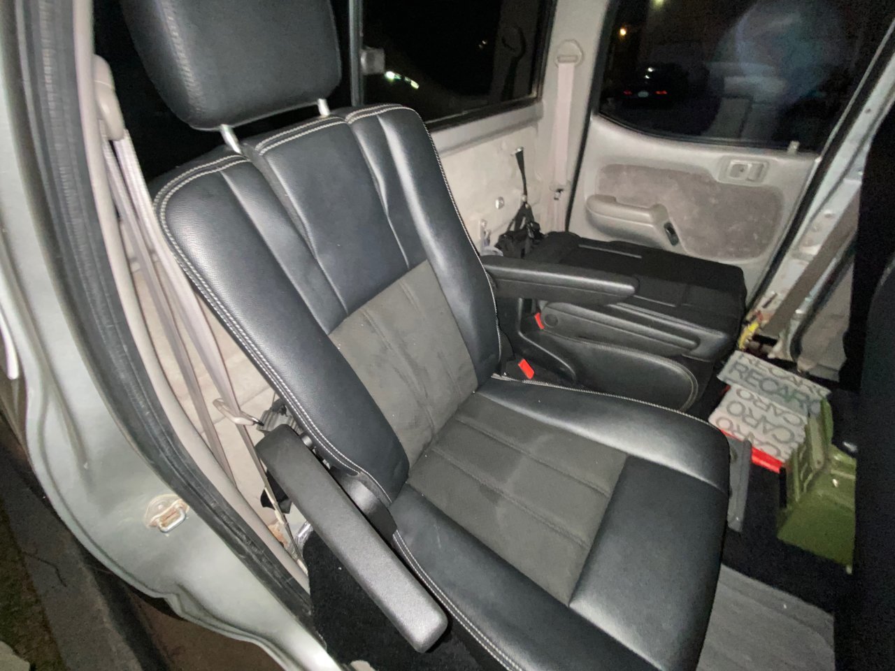

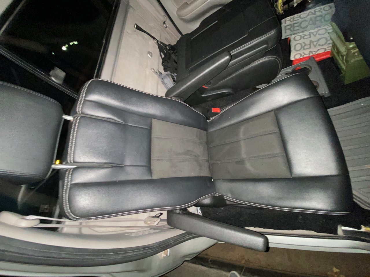

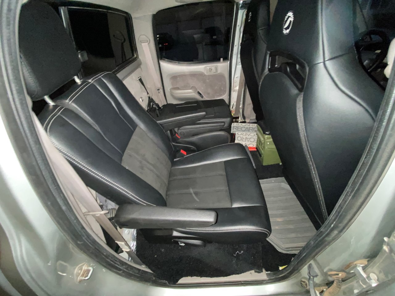

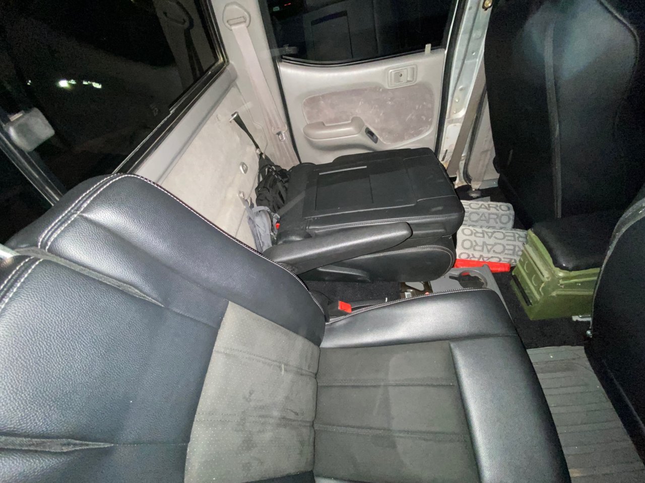

    I have custom seat mounts in my car and my seat is mounted further back for the passenger so they get more leg room. Never hits it

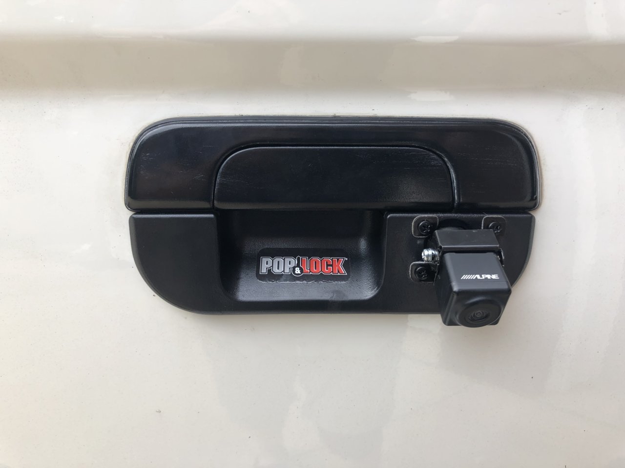

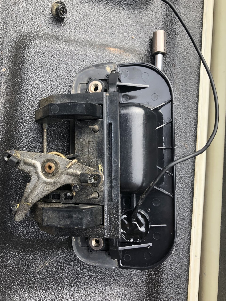

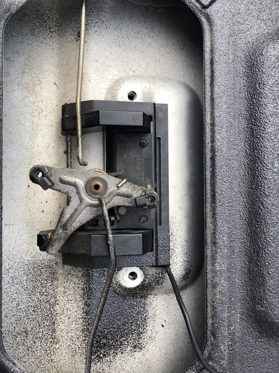

    Moved my Alpine rear camera from the license plate up to the tailgate latch using a manual Pop n Lock assy. Removed the lock to run wires through. Plan to add an auto lock later. Had enough room to run the camera wire without drilling any holes. All worked out well with the connection back to the Alpine ILX-650.
    74553D6D-A081-4A45-9980-1915E169B8EE.jpg 236EEA8F-018A-4BF2-B3E1-22152C70047F.jpg 40F7E063-368F-49CE-8133-18CFD72DDB24.jpg

    Most Excellent!
