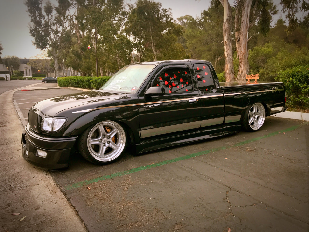

    my whole truck is pretty unique. But I’ll say my wheels and my kit.

    more! looks very slick

    Bagged?

    yes

    solid af. Wheels remind me of an F40.

    looks good. first time ive ever seen love flames!

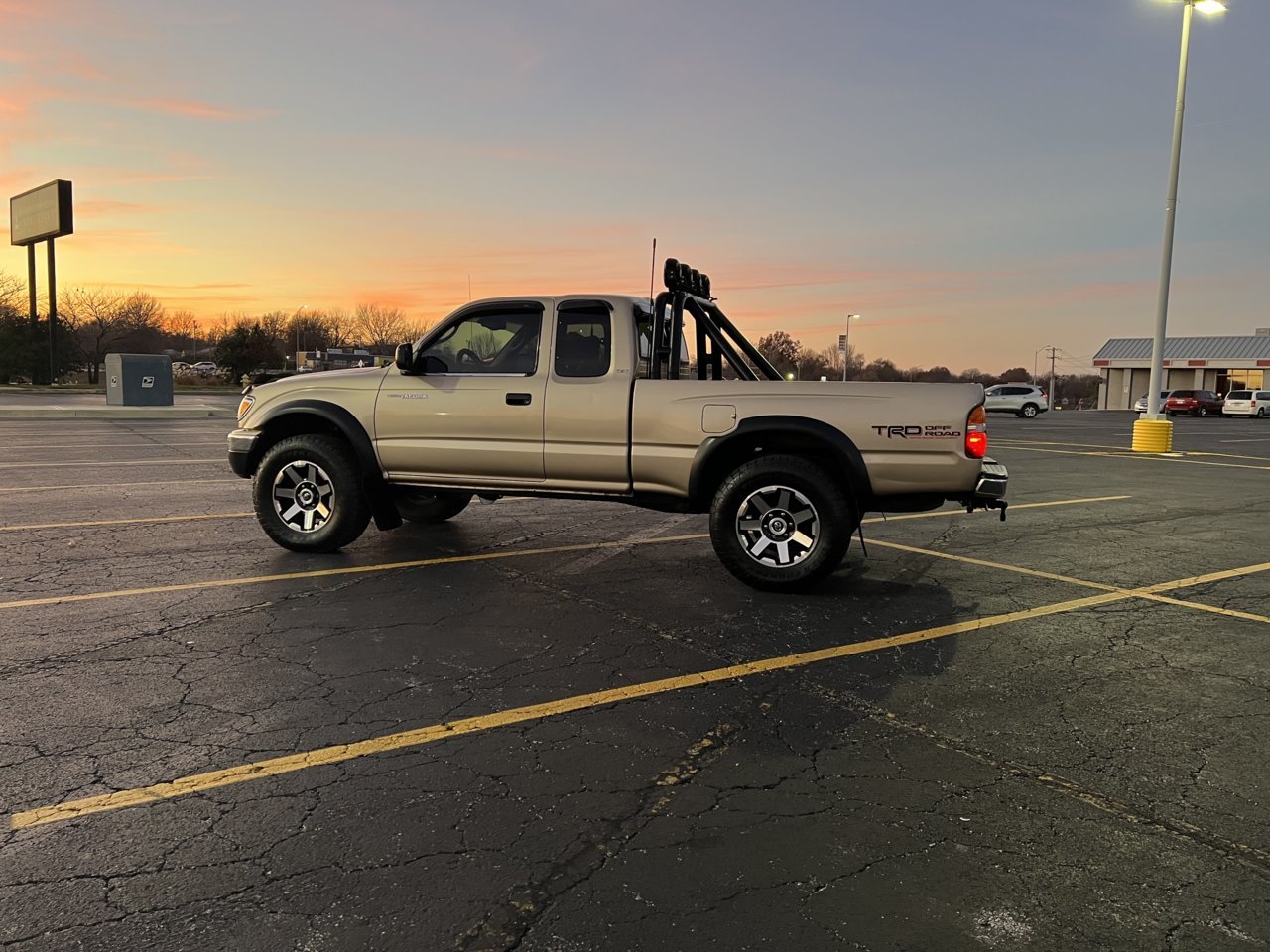

    Stock: Light bar!
    My work in progress

    I like the roll bars with lights. You don't see those around too much anymore.

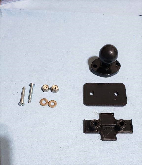

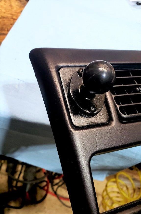

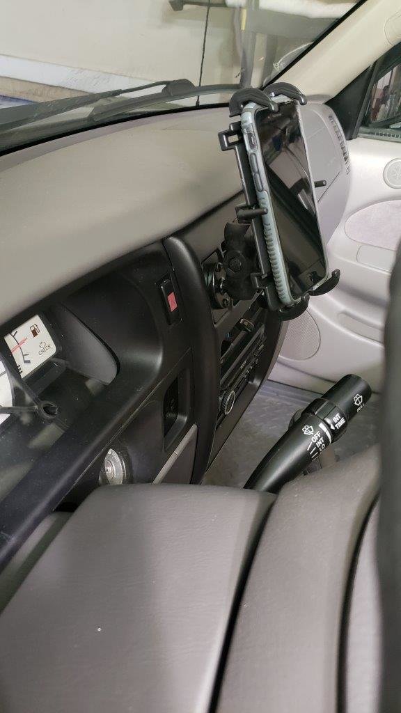

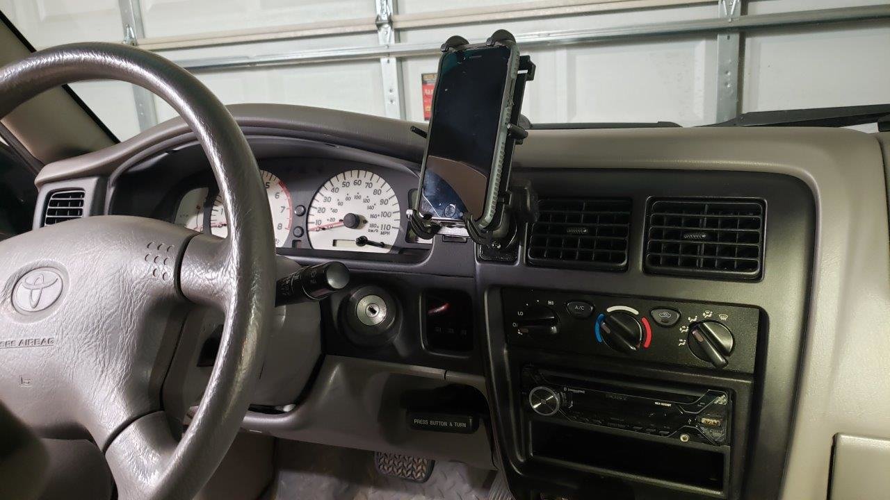

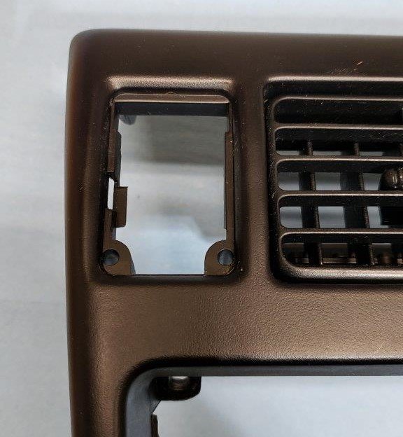

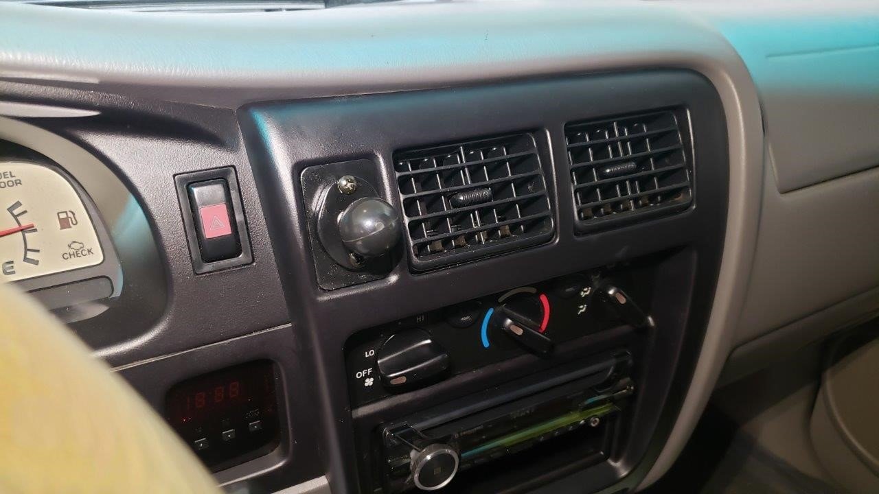

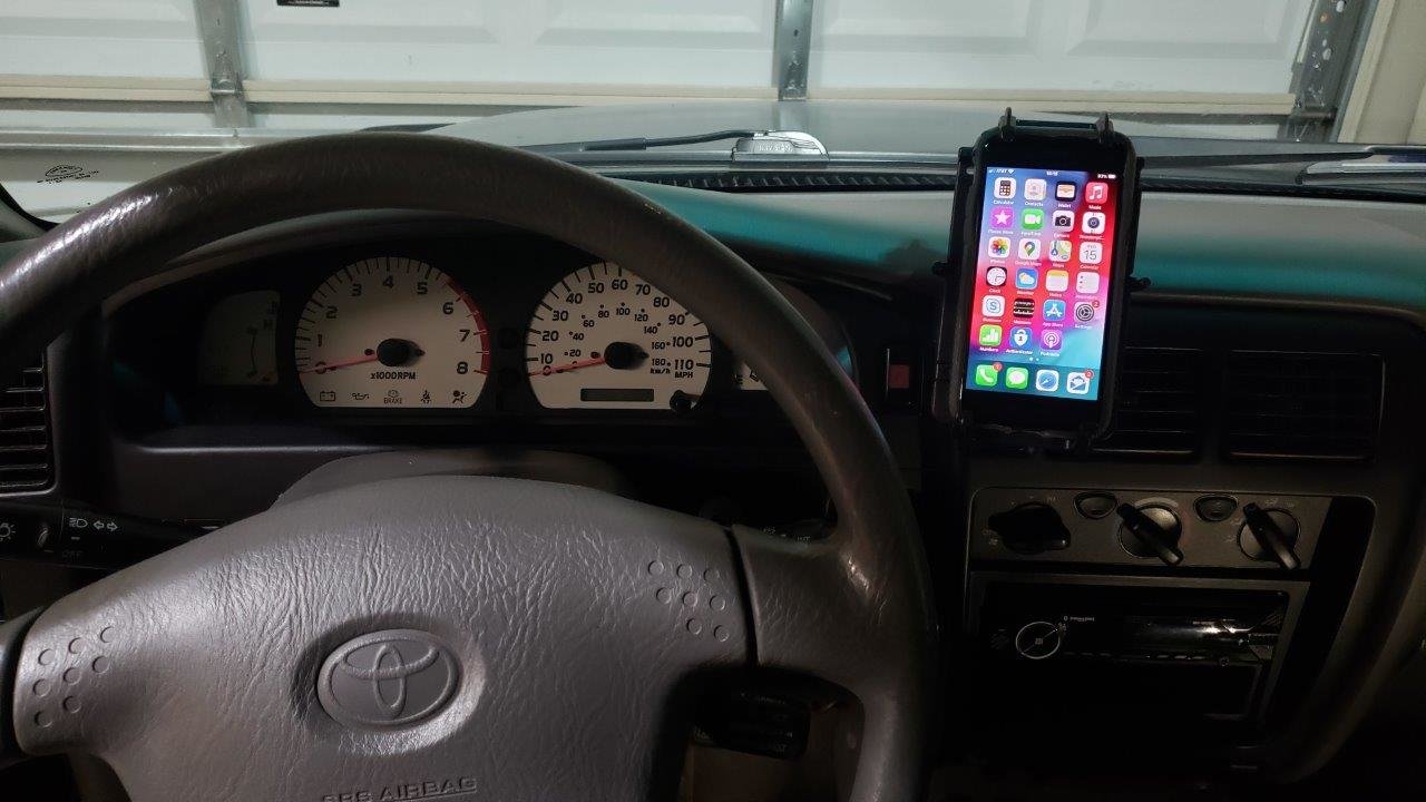

    I got tired of the cheap suction cup phone mounts on the windshield that fall off randomly or the cheap Amazon mounts that cause big phones shake so much going down the road that it's impossible to quickly read the directions. I treated myself to a RAM Mount. If you aren't familiar with, you're in for a treat. By far the best phone mount on the market, just get one and you won't accept anything else. At work we use similar mounts to setup instrumentation to precisely measure things in awkward locations.
    There are pre fabricated solutions to mount this system, but none quite fit what I was looking for. I wanted a way to permanently mount the phone out of the way of other controls, off the windshield, not require drilling holes, and still have the phone accessible to passenger so they can control it, play different music, setup direction, etc. I cannot take complete credit for the idea, as I'm sure I've seen someone else mount a phone here, but I can't find where I saw that. If you know, please link it.
    Anyways, on double cab 1st Gens, there is a blank panel on the center stack above the HVAC controls and left of the middle vents. On non-double cab models, the passenger airbag disable switch goes there in place of the blank. Since it is not being used, I thought it would be the ideal mounting location. Initially I thought I would put a couple of holes in the switch blank and mount the ball directly to the blank. However the blank can move a bit and is only held in by two molded in "spring latches". I feared it may break with continued use and fall out after hitting a big bump.

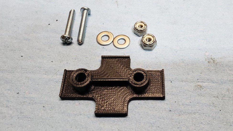

    I decided to create a "sandwich" to clamp a ball into the center stack. There are two thick plastic plates that clamp onto the switch hole, providing a solid attachment that does not move under load. The original hole pattern on the RAM Mount didn't quite fit the space, so I ground it down a bit and drilled new holes. With a few modifications to the RAM Mount Ball Base, a couple of parts I designed and 3D printed, I present to you the Phone mount. So far this is amazingly solid, the phone does not move. I don't have to glance too far off the road to look at it. Best of all, the phone can easily be put in place with one hand. Time will tell how durable it is.
    The Location Used. Typically there is a blank panel or a passenger airbag switch depending on the cab.
    Backing Plate - grips the sides of the square cut out of the switch center stack.
    All the parts - Fasteners, backing plate, face plate, and modified Diamond RAM Mount
    Assembled in the Center Stack
    Ball Location
    Finished Product
