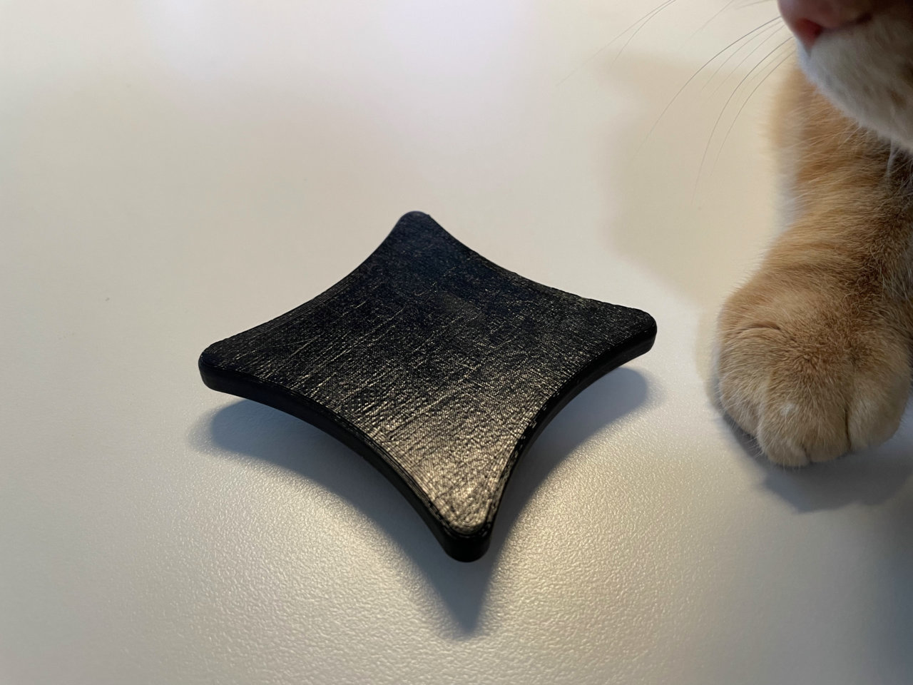

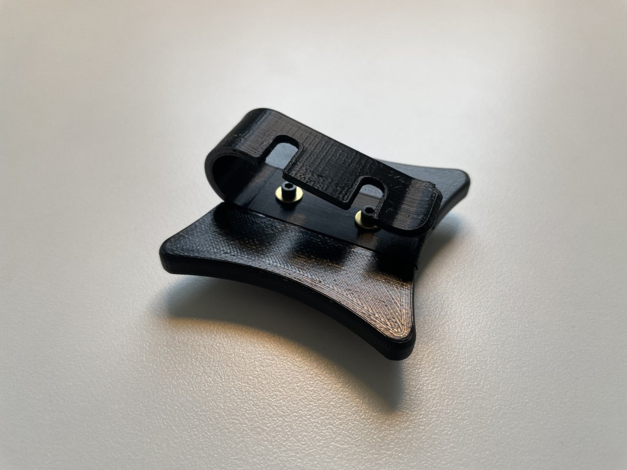

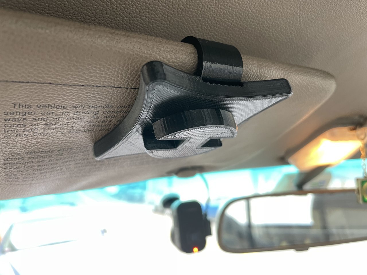

    updated to add a visor clip... sorry, no cat scalar this time :p

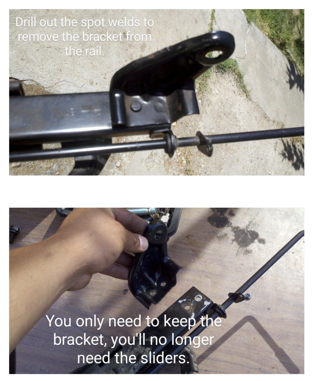

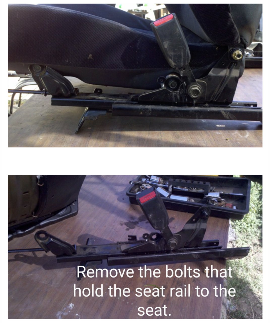

    I'll get some pictures for you this week. It's not difficult to do as long as you have the parts ready to bolt on.
    Integra DC2 seat, planted seat bracket, and Recaro sliders.
    For the Integra seat, once attached some pictures below. You'll need to remove the factory Integra sliders prior to working on it.
    The reclining handle side comes right off as seen below.
    Seatbelt buckle side, there's a few extra bolts that hold it on. Remove them to get the slider off.

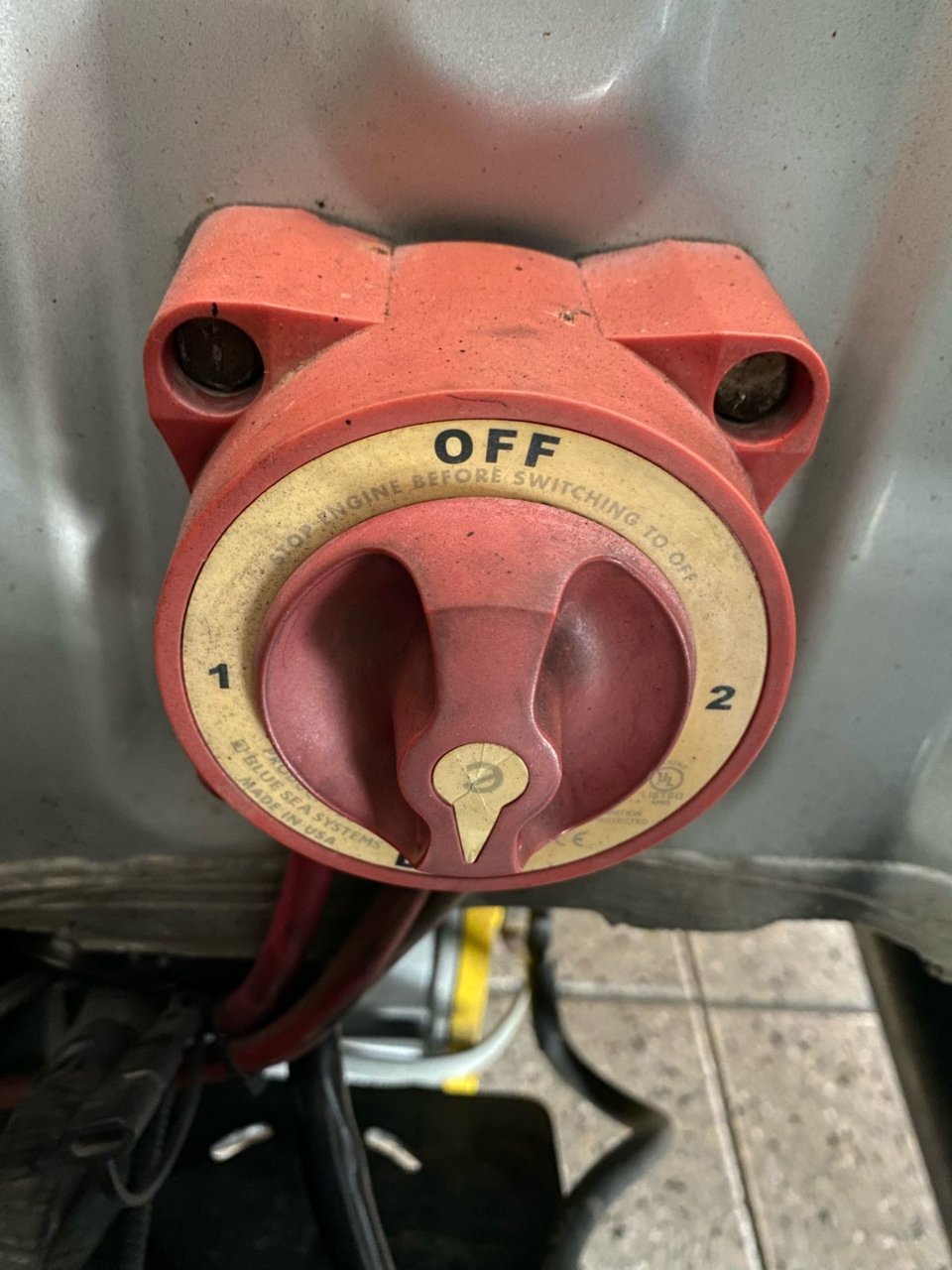

    I'm sure I am not the only one in here but a dual battery set-up with a battery switch souced from the local marine supply store :). At least I could be sure it was weatherproof!

    Sweet. Haven't seen a dual battery placement on the side of the frame like that before

    Yea... wanted an out of the way spot and the Optimas (or any Gel type I assume) can be mounted like that with no issues. It has worked out well and I've had no issues (been running it that for at least 10yrs).
