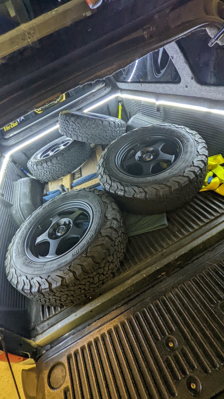

    Installed lights in my camper today. Pretty happy with the output.
    Faztec1, Mr Yoda, BeLance89 and 9 others like this.

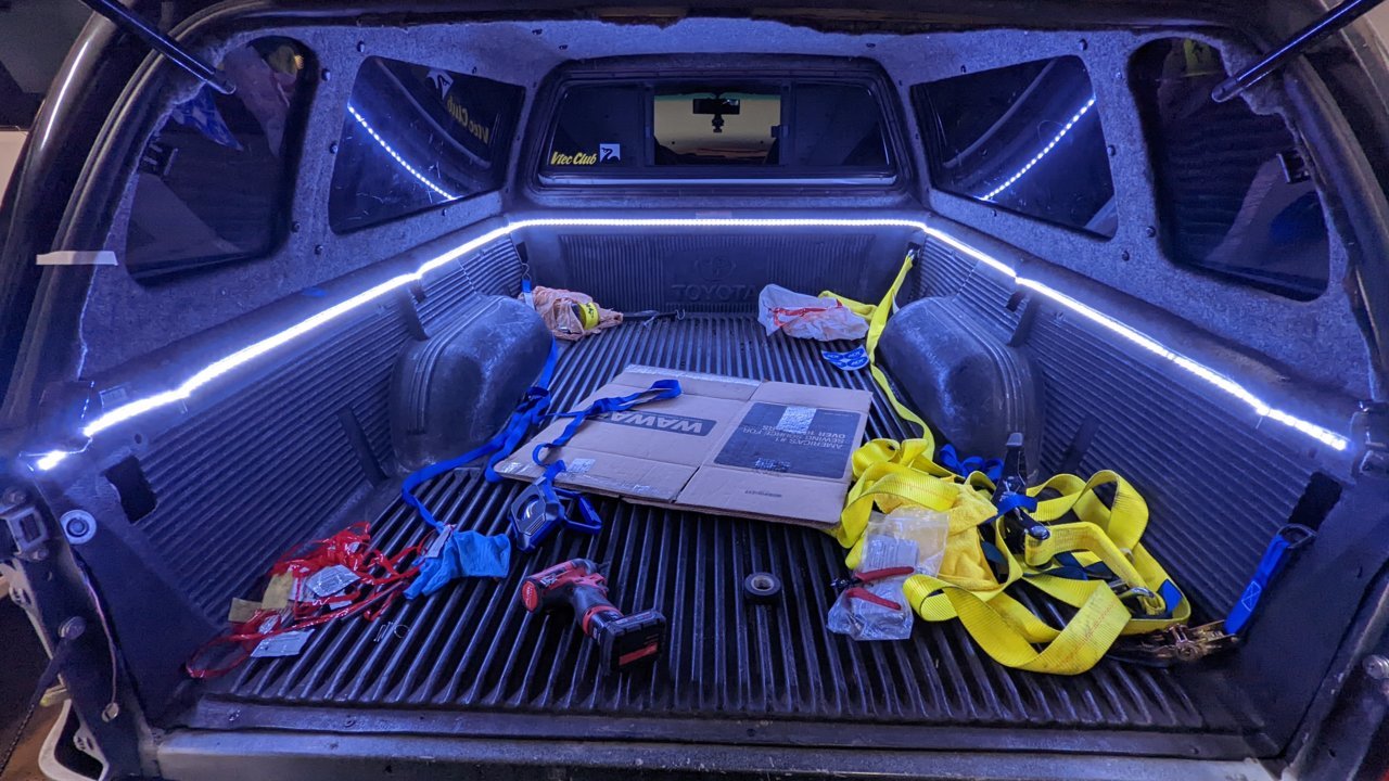

    I used this tutorial as a guideline.
    https://youtu.be/77t1UW4Qc7g
    I omitted the magnetic switch because I want to be able to turn them on even with the tailgate closed. Basically ran a wire from the battery through the firewall under the cab and bed and into the driverside taillight area to wire up the switch and light strip.
    LED I used: this was the perfect length for a 6ft bed.
    ALITOVE 16.4ft 5050 SMD Black PCB... https://www.amazon.com/dp/B07MXY16HZ?ref=ppx_pop_mob_ap_share
    Switch I used: you'll only need 2 of the 5 wires unless you also want it to illuminate.
    19mm Latching Push Button... https://www.amazon.com/dp/B076GYW4KX?ref=ppx_pop_mob_ap_share
    In-line fuse I used:
    Nilight 10 Pack NI-FH01 Inline... https://www.amazon.com/dp/B07426WCLM?ref=ppx_pop_mob_ap_share
    Magnetic switch if you prefer to use it:
    Directed Electronics 8600 Micro... https://www.amazon.com/dp/B0009SUEZY?ref=ppx_pop_mob_ap_share
    If you have any questions, feel free to send me a message.

    Here's how it looks lit up in my garage during the day. Pretty bright still.
    unstpible, my2coma and SwampYota like this.

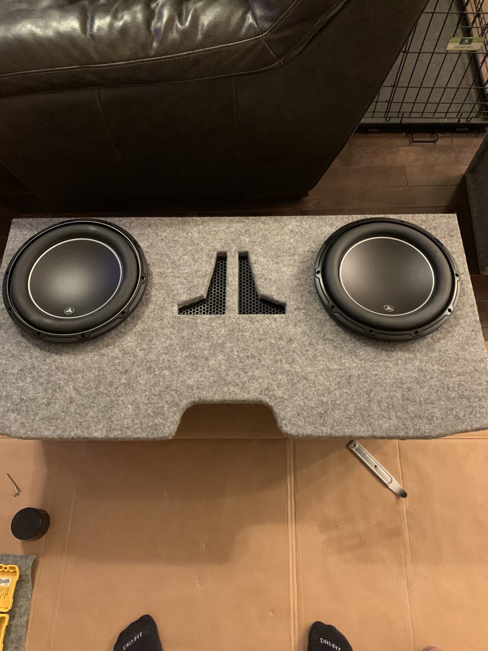

    Custom box I built
    5B1121C0-CC1E-4034-A9AA-20E8FE8AB9C8.jpg 5D6BD444-1683-4EF9-B356-45FDFE1B4A22.jpg
