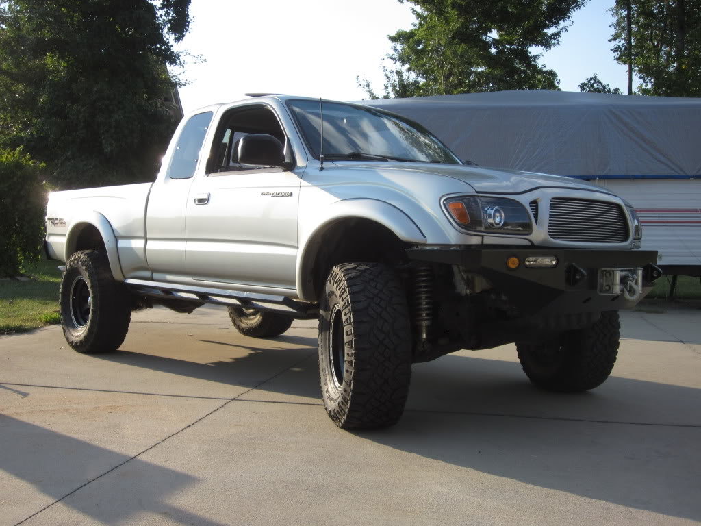

    where did you get this blacked out corner lights?

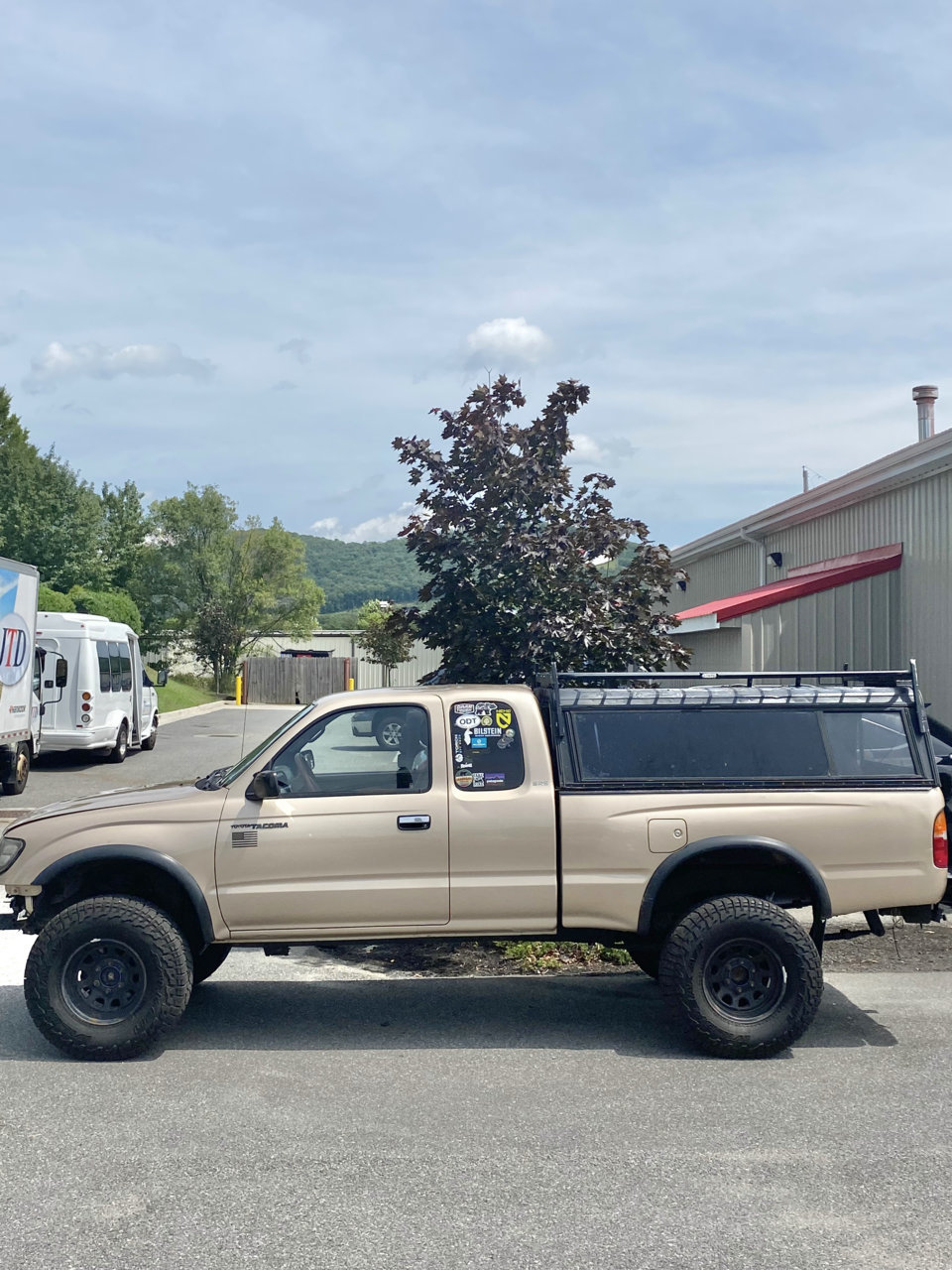

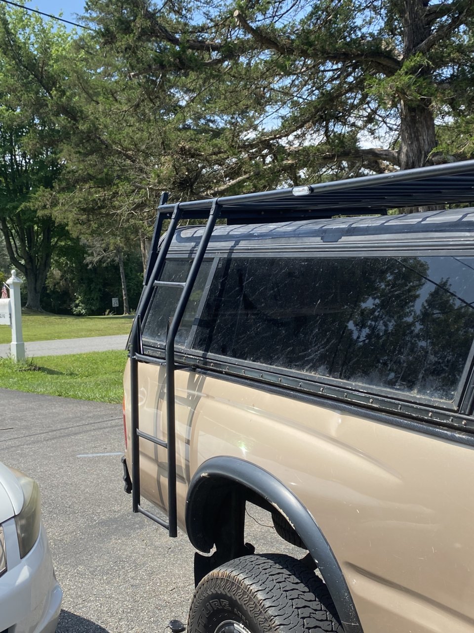

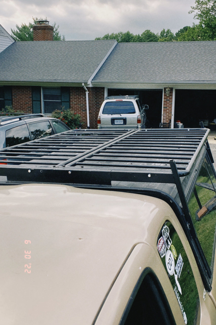

    I would say my camper shell roof rack and side ladder made from an old bunk bed I got for free is pretty unique...maybe not in a good way haha

    That's actually a really good idea and looks like it works really well. Is it secured to the shell or the bed?

    That actually looks like it was made for that lol! Good job!

    Thanks! The ladder is secured to the camper shell with brackets that just slide between the bed rails and camper shell

    I was talking about the rack itself, it's hard to tell if it is secured to the shell or goes doe to the bed rail in the front and back?

    Oh I see. The camper shell just had some simple rack in the front and back that the bunk bed racks are bolted to

    I think you're down playing yourself. This is sick! Very creative, unique and purposeful--you might have to draw it up in CAD and distribute the drawings for a couple of bucks

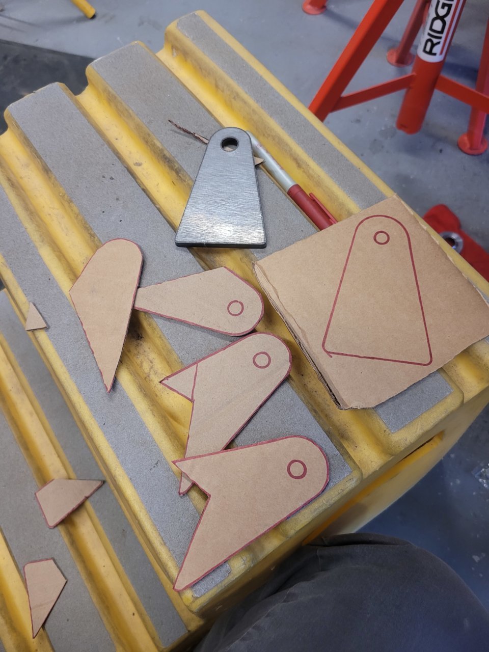

    You don't know how to use CAD? You got to be kidding me....
    CAD = Cardboard Assisted Designed
    :rofl:

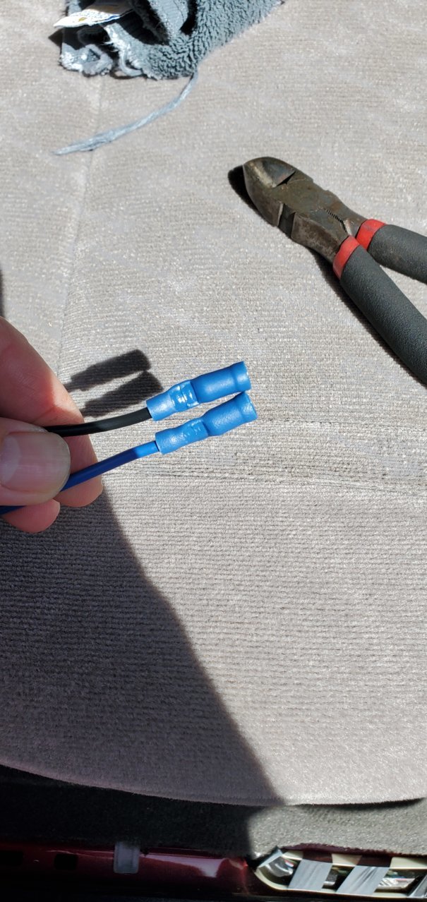

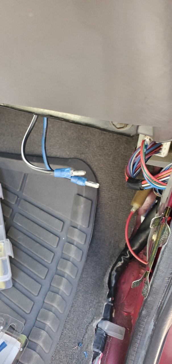

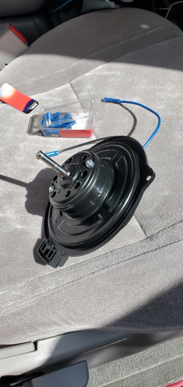

    My unique mod is probably not unique but it is practical and I haven't seen it here. Since I know my truck is on its 3rd a/c blower motor at the very least I decided to modify the wires so if there are any future replacements needed won't have to keep cutting the trucks wiring shorter every time.
