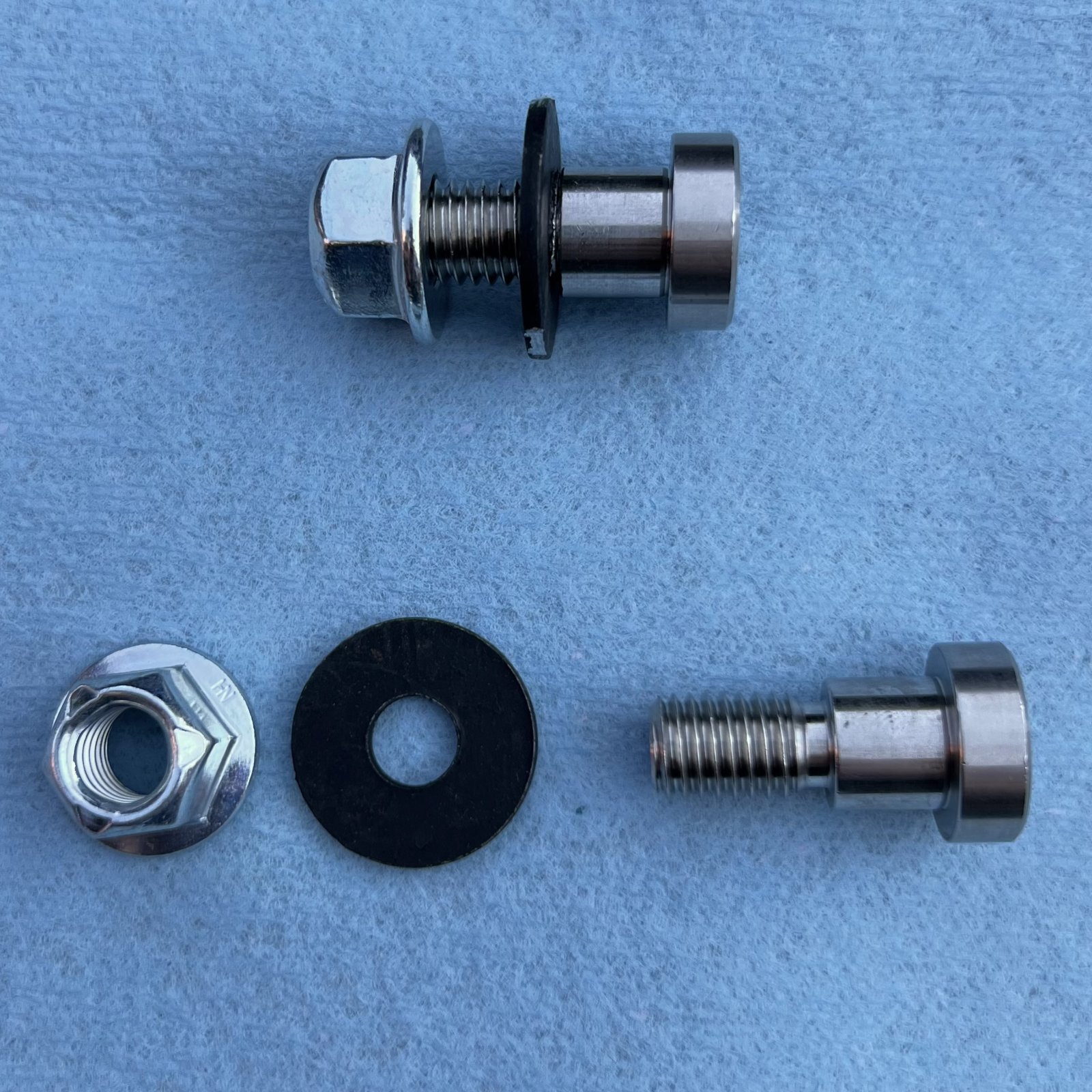

    Shoulder Bolt - 18-8 Stainless Steel Low-Profile Precision Shoulder Screw 12 mm Shoulder Diameter, 10 mm Shoulder Length, M10 x 1.5 mm Thread
    https://www.mcmaster.com/product/90323A262
    Nut - High-Strength Steel Distorted-Thread Flange Locknut Class 10, Zinc-Plated, M10 x 1.5 mm Thread
    https://www.mcmaster.com/product/3528N13
    Washer - I used a M8 washer I had on hand and tapped it for M10-1.5 threads. The thread relief on the shoulder bolt caused way too much play between the bolt and a standard M10 washer such that the shoulder would not bear down on the washer fully. The threaded M8 washer provided the least amount of play.

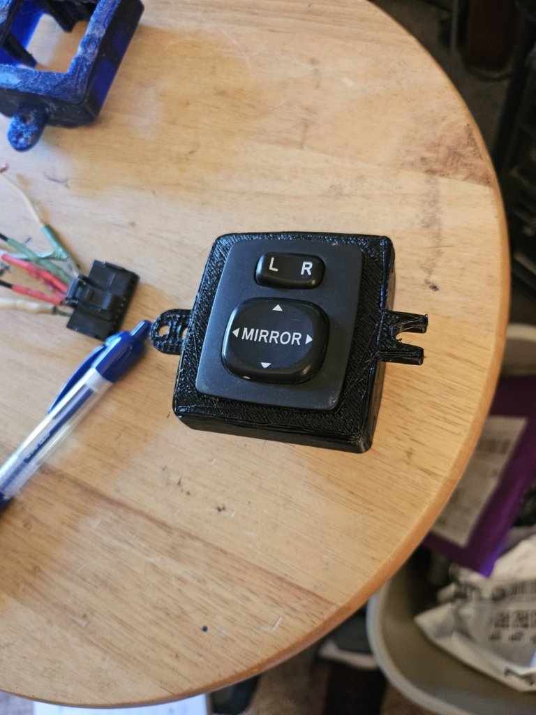

    getting ready to do a manual to power mirror swap, 3d printed mount for clock area.. ill do a writeup after done.

    Curious, does your driver's door control panel not have the blank spot where the switch normally goes?

    no, my sr5 had power-NOTHING when i bought it. :D
    I have added OEM cruise control, aftermarket power windows and locks, and now power mirrors.

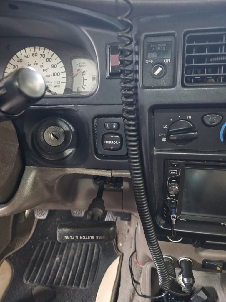

    Did you ever complete the writeup on how to do this? I have an LX with OEM Power windows and locks but no mirrors. I would like to add OEM power mirrors.

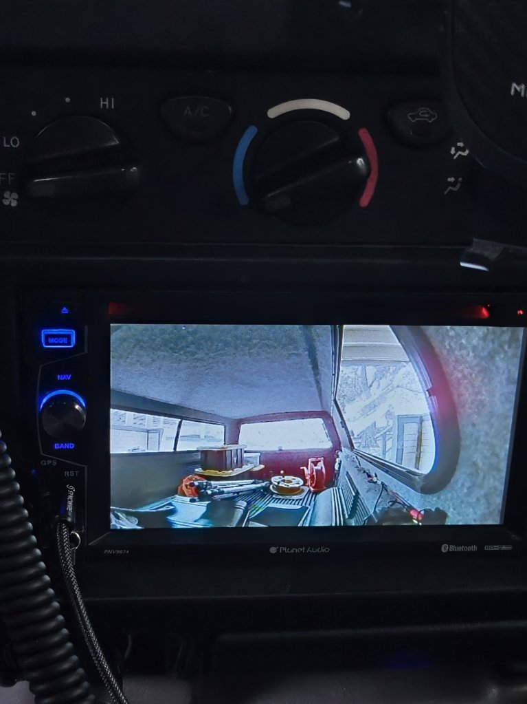

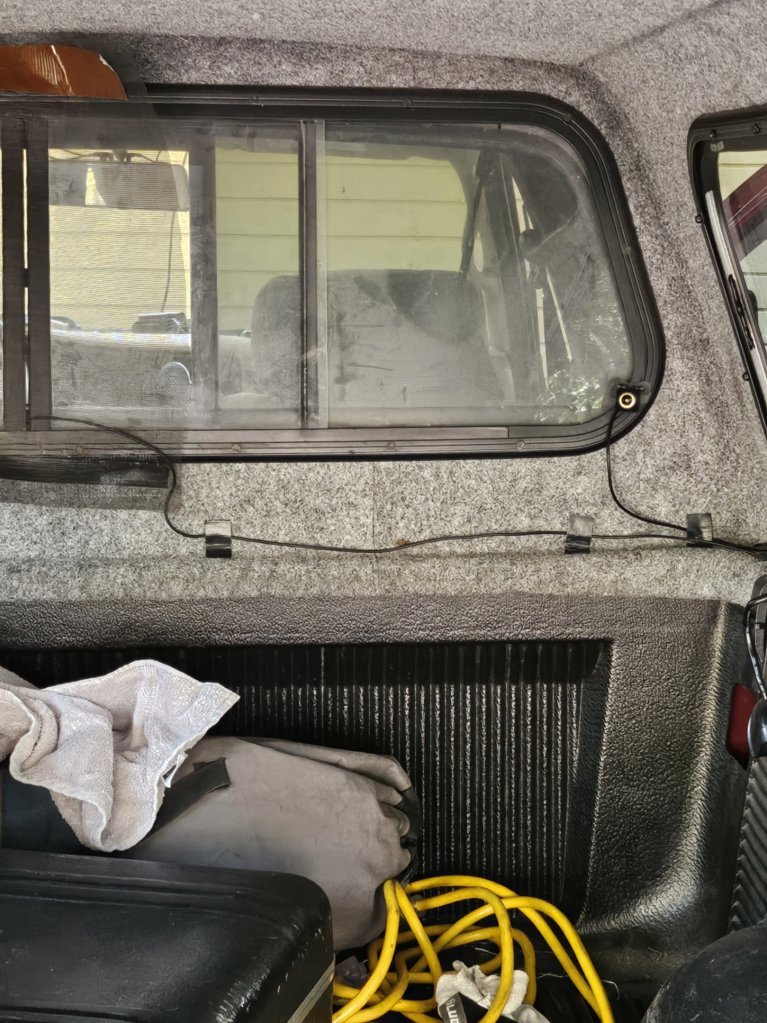

    today's totally unnecessary and frivolous mod, my rear view mirror cam is so good i leave it on, but i cant see my bed contents. insert cheapo $30 rearview cam for my stereo aux input!

    Curious which head unit you're running. Does it only allow you to view the camera if you're in reverse, or does it have an input selector?

    its a https://planetaudio.com/product/pnv9674/
    it has an AV aux input. cant listen to media while the screen is on but it works. That unit does have a reverse cam input but id have to disable the reverse detection for it to be on whenever I want it.

    Awesome, where'd you pull power for the "backup" cam from?

    I have DC panel in the camper shell with a fuse block so just ran it from there. that panel is controlled from a switch just below the radio.

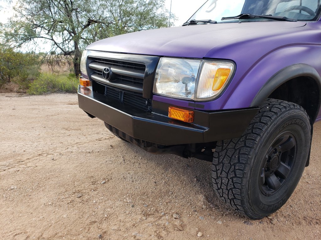

    Didn't like any of the aftermarket bumpers and didn't want to pay a $1,000 so I built my own.
    $200 in materials, a couple months of weekends and a few revisions later...
