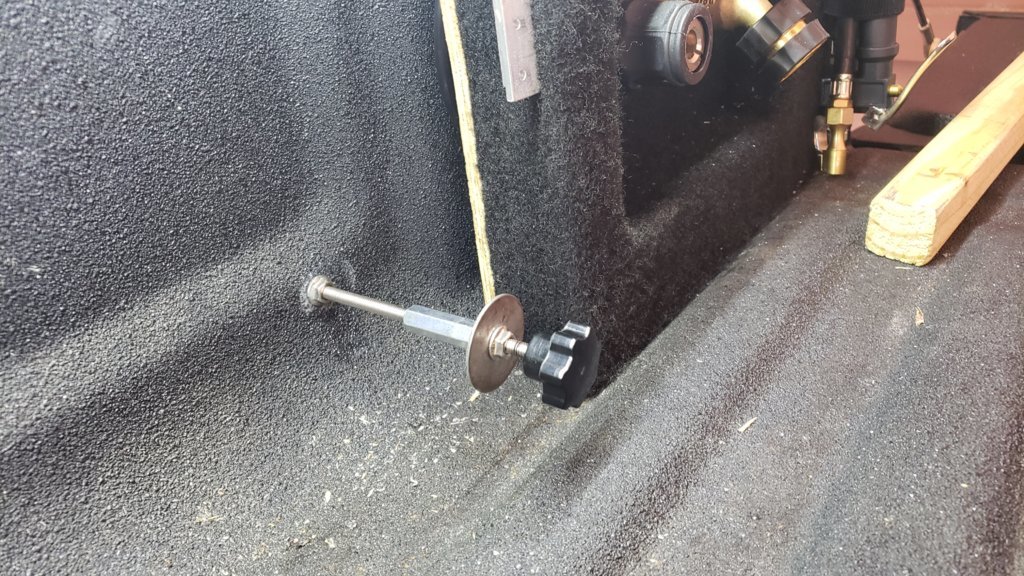

    Awesome job that looks supper clean. How did you attac the front pannels?

    Thanks! You can probably see some black threaded knobs in the other photos. The pic below is how I attached them with a threaded rod and rivnuts, just to keep them spaced out and secured. I only did two per panel at the bottoms. At the top they fit tight in a lip on the roll cover
