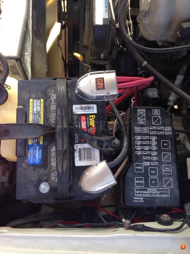

    He has put in quite a set up in his own truck that he is trying to manufacture to sell including dual battery set ups with meters in cab and the whole 9 yards that makes me want spend my lift and tire fund on haha :)

    Haha yeah, I'm going to do my own dual battery. But I do want his alternator/wiring harness.

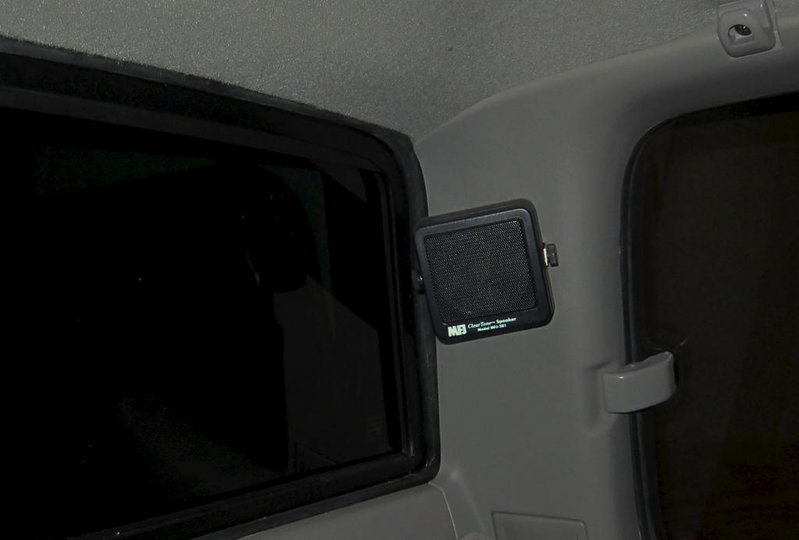

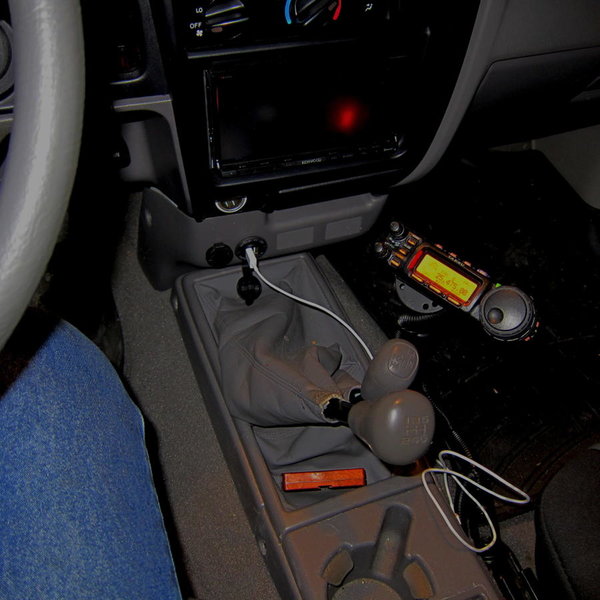

    Instead of the usual CB I installed ham for more versatility. Use a portable CB on the trails.
    Speaker behind driver works well as a location.
    The ham location has never bothered a passenger.

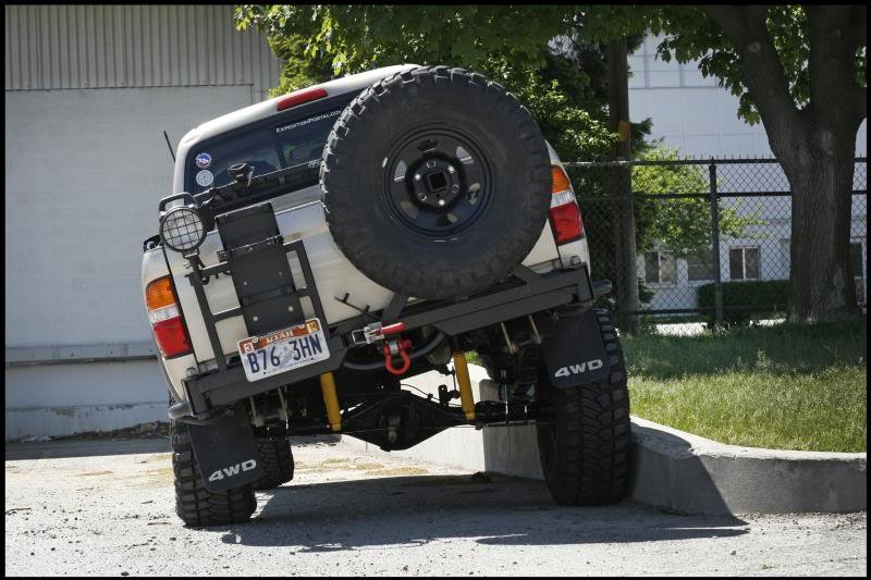

    Drop bracket lift and booger welds
    The line with the brass fitting correct? Drain for what? The cab in case you flood? Or something else?

    Probably for an OBA tank.

    Winner, the bumper is an air tank, the pictured 1/4" line has long since been replaced with 3/8".

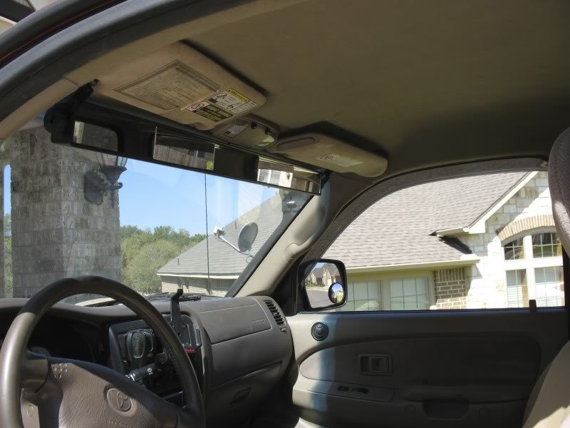

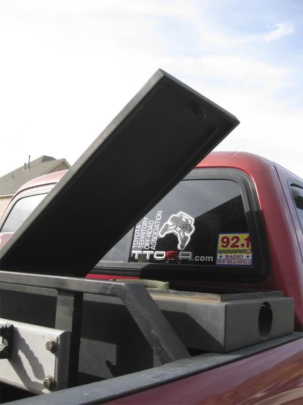

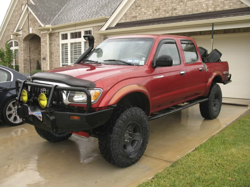

    Check the TTORA Garage Section....
    Very cool stuff here... Some I have done long ago like the V1 hardwire, mag light mount, CB location, OBA in my ammo can with the tank under the bed, etc....
    My unique mods that I have not seen
    Custom tool box, bed bar and bed rail by JFAB of TTORA

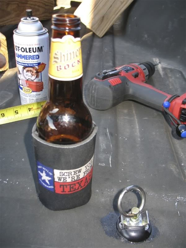

    MAC's tie down
    WINK 5 panel mirror

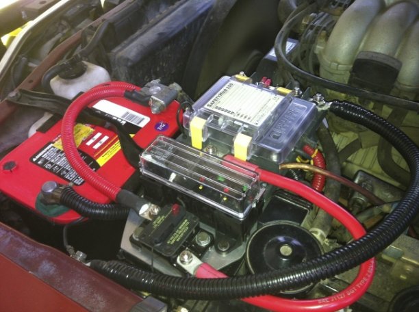

    Fuse box power distribution system

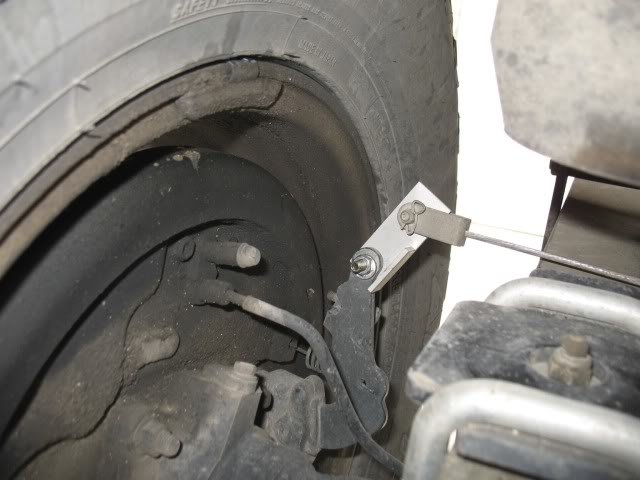

    My custom made aluminum e-brake extender
    Using the land cruiser's FZJ80 wheels
    But in the end... I love my truck and it is different than anyone else's.

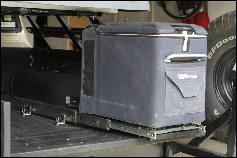

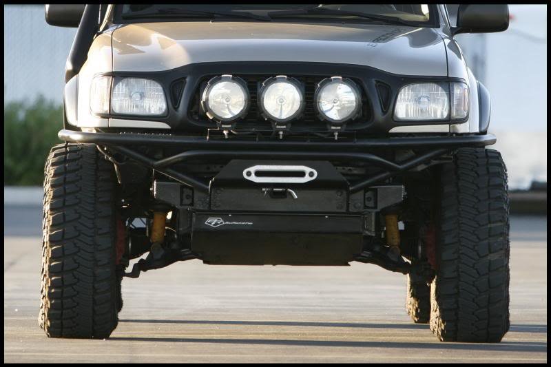

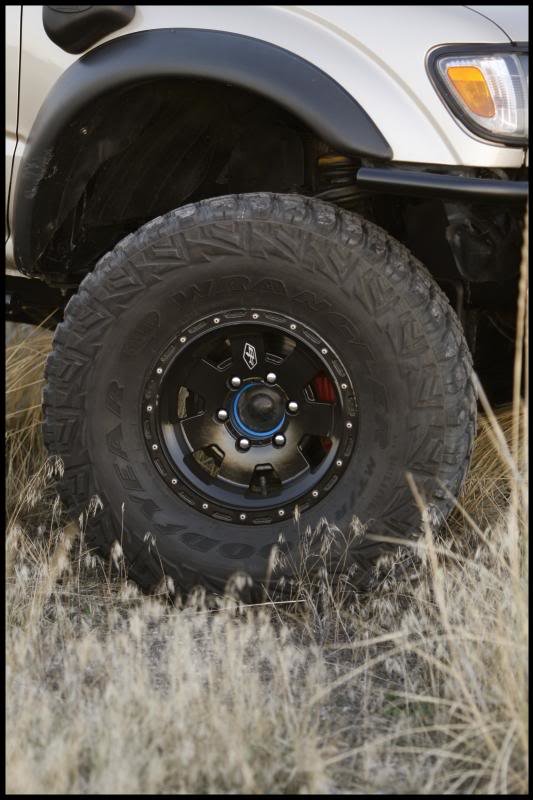

    1995 FZJ80 Land Cruiser

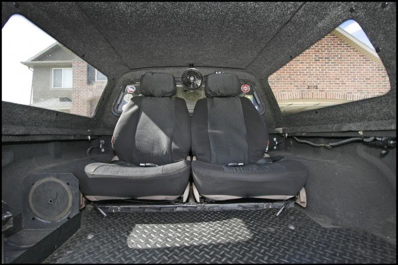

    3xLocked, lifted, well used
    custom fridge slide
    bed seats
    custom skid plates
    custom dual swing out rear bumper.
    custom bedrack
    painted "Box Rocket" ultra wheels
    painted FZJ80 wheels

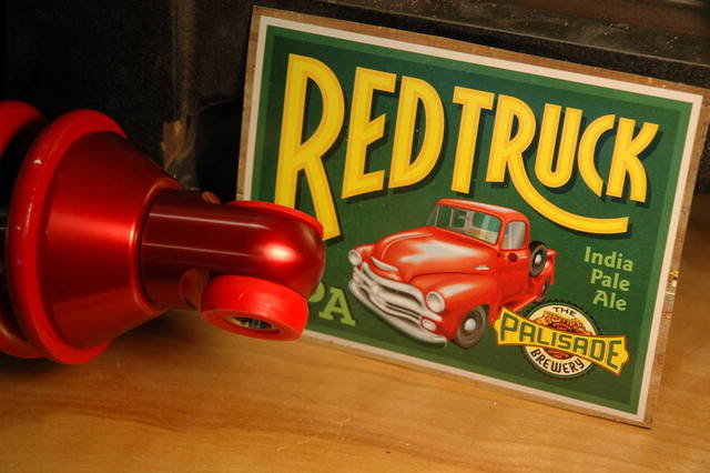

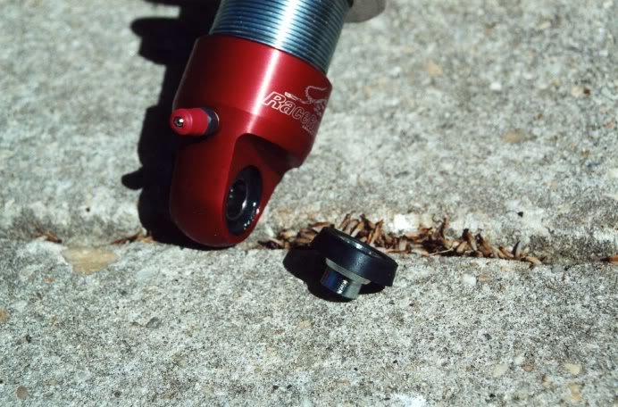

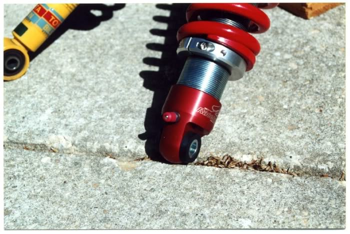

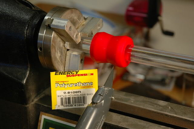

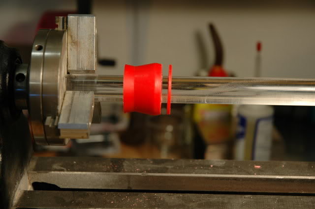

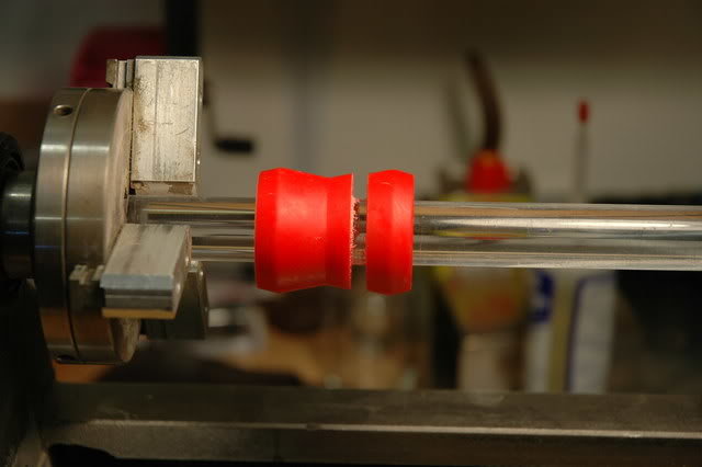

    You don't see this everyday.
    I cut up some poly shock bushings to make seals in an attempt to extend the life of the Heim joints (spherical bearings) commonly found on aftermarket coilovers. I have been doing this for 13 years and get 60K-80K miles out of a set of joints including thousands of dirty ass off road miles a year. The joints themselves and the retainer clips get a light smear of "Plumbers Silicone Grease" (Home Depot plumbing department) as a corrosion inhibitor, not a joint lubricant. It's made by "Gunk" and is intended for use on o-rings and seals. It contains no petroleum products. As an additional benefit the seals prevent the shock body from rotating and rubbing on the LCA mount ears.
    Similar seals are now sold for double shear mounted rod end Heims.
    These 2 shots are of the first commercially sold Tacoma SAW (rev 2 of the "upside down" 1st design, 7/8" shaft upgraded from 5/8") around Y2K. Still have them as spares.
    Here we see cutting the seals and a glamor shot of an install on a current shock. I used a razor knife against a plexiglass mandrel in a lathe. A steady wrist could do it free hand. Leave them around 1/16" to 3/32" fat so they "squeeze" in tight.

    ^Very cool, however not that unique :eek: kings come with those on their shocks

    Not 13 years ago they didn't and those are just anti chafe disks up top with nothing on the lowers at all.

    I don't know that. While you may have thought of it yourself, maybe even started the trend, just saying its no longer unique 13 years later. It is cool that you make them yourself, I do appreciate any hand made or modified things that work. Take the credit for making them popular :D

    Well fine then.
    You would not believe the flack people put up back then, "That will just trap dirt" "They will rust up in no time" "Don't get any lube near the Heim, the liner will melt". Yeah,OK.
