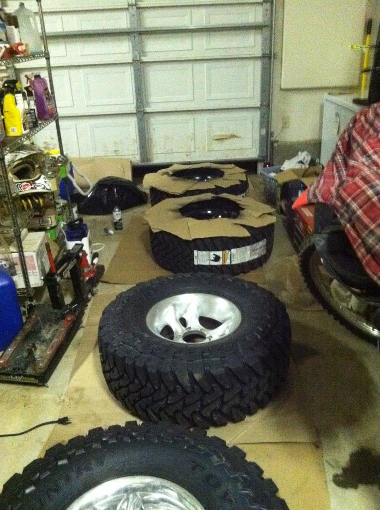

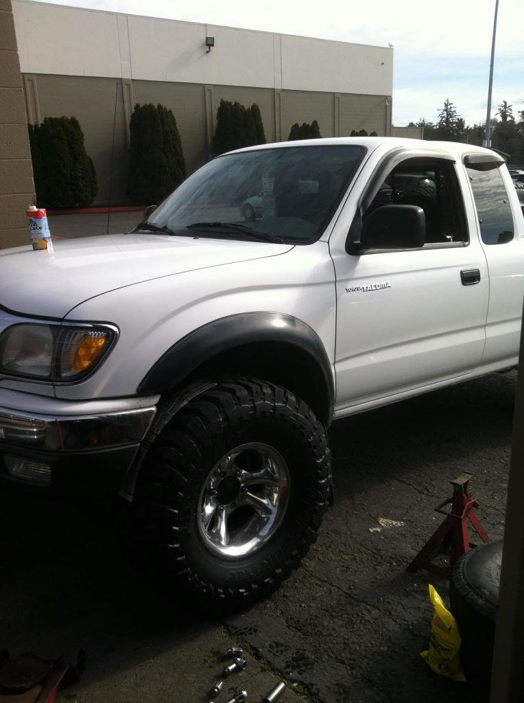

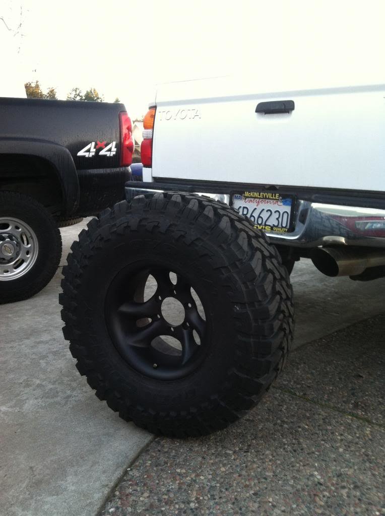

    stock muffler dual out, 33" toyo mt's, rough country AAL, bilstein 5100's at 2.5, ebay grill, red TRD decals, BFH! to cab mod, rmx monotude rear shocks(junk), custom delta toolbox(1) regular lo-pro delta(2), and weather guards for windows.
    American racing Ventura's painted black with toyo 33/12.50's.

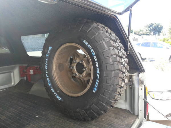

    Built an in bed tire carrier.

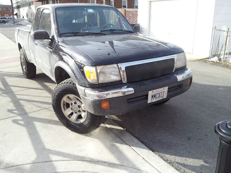

    I had an extra grille and some 1/8" flexi-plastic, so what the heck. I just trimmed some of the more pronounced parts of the grille, zip tied the plastic on and voila. Makes a big difference in warm-up time and therefore gas consumption especially when you're in the grip of a polar vortex.

    Those look good black I've never been a fan of those wheels but they look good

    I would take that off once it starts to warm up, not likely that you will overheat the engine but anything is possible

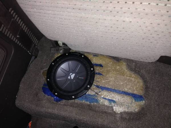

    Made a fiberglass "stealth" subwoofer box a few weeks ago.. 8" Kicker. Still have to finish up the carpet.

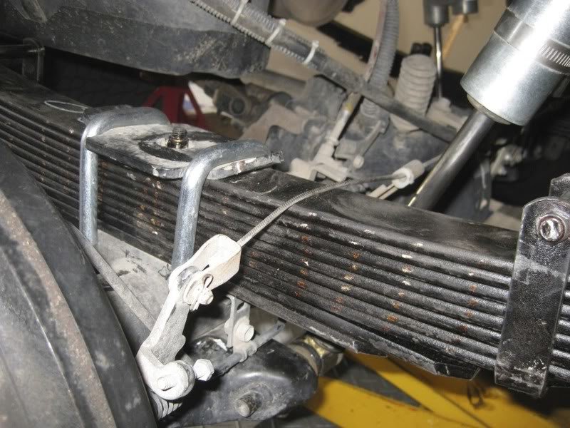

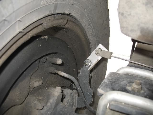

    E-brake bracket modification.
    From this....where the cable was laying over the leafs.
    To this...machined a bracket to elevate the cable off the leaf pack.

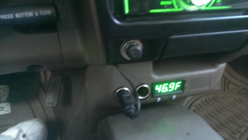

    Forgive the blurry photo. But I installed a temp gauge for the a/c and stuck the probe down the vent. You might think it's weird. But living in Az and having a heads up on any ac problems is nice. I always had those crappy needle thermometers in the vent which always ended up breaking or not reading right so I did this mod.

    This. I want this! Can you describe how you made this? Even better, pics of the process? It's beautiful!!

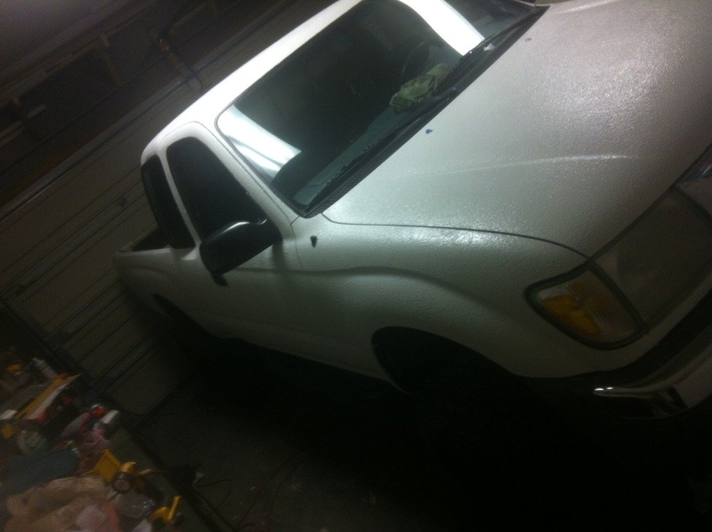

    no your not:D.... I also have the tundra trd coils... Wish I would have known you did though. Had a couple questions before I bought and installed.
    EDIT: Holy crap just realized that was posted 6 years ago. :facepalm:My bad, you are the sole originator for sure.
    I might have the only white bed lined truck?

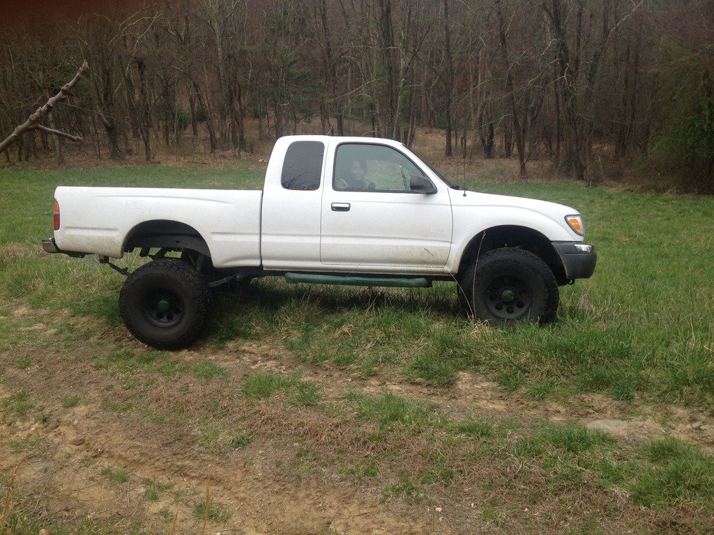

    I have a OD Green Bedlined truck!!

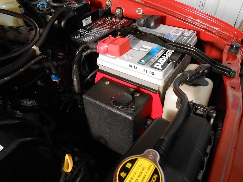

    There's been some talk lately on the daily thread about battery disconnects.
    This little fellow is more of a "no tools required" thing. It simply replaces the nut on the terminal clamp bolt of the "mil spec" connector and functions like a permanently attached non-conductive ratchet wrench. A180 degree swing is all it takes.

    Ooh I like that

    Holy leafspring batman !!! How many leafs are there anyway ? 10 + ?.....:eek:
