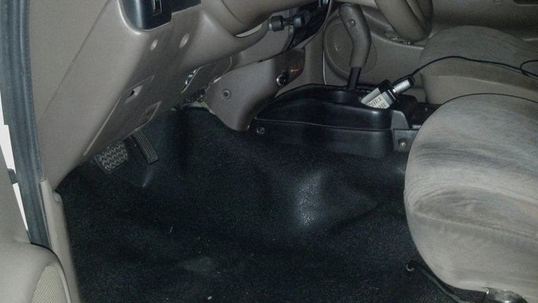

    Been looking for that type of stuff for years, what's it called, just vinyl flooring, mat, or what?
    rodehard and ToyRyd04 like this.

    KDMaxx tune K&N drop in AFE catback Oil catch can Bill's 6112/5160 Dynomat whole inside of cab TRD skid plate
    I know this is an old post but, Thats bitchin.
    How did you deal with the air bag light and the cruse control stuff .
    I'd like to go after market on my steering wheel

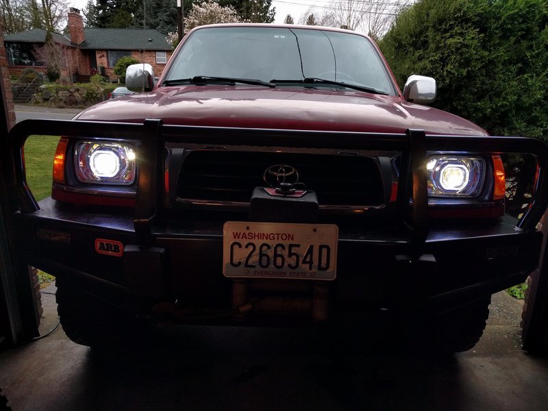

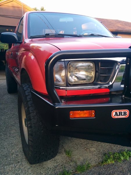

    HID projector retrofit into the 5x7 housings! All parts from The Retrofit Source (used the Morimoto Mini D2S 3.0 as they have the shortest front to back dimensions). Also put on the Morimoto XSB Square Halos, which switchback from white to amber with my turn signals but kinda wish I hadn't bothered wiring them as they are 5000K and look... lame... next to my 4200K Osram nightbreaker bulbs. But the halos are nice and bright and pretty nice for setting up a campsite at night as they don't blind all your neighbors/you (as the HIDs would) and hardly have any current draw so you can run them for a long time. They are also nice as DRLs, but still wish they were 4200K not 5000K.
    Before, ugly, low output:
    After!! Bright, beautiful cutoff line, switchback halos.
    These headlights are SOOO much better than stock. Driving at night is very enjoyable now :)

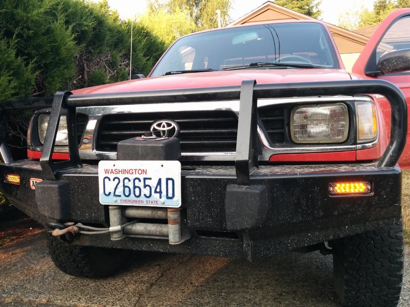

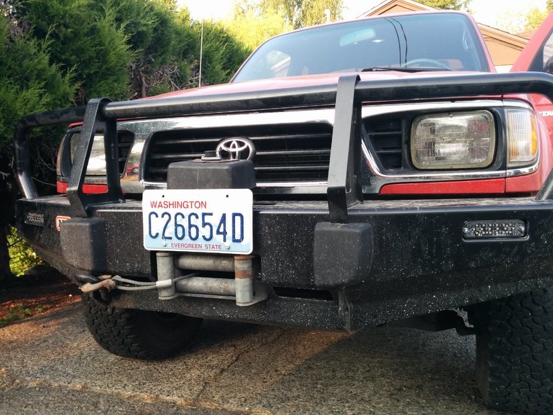

    Aaaand my ARB bull bumper incandescent to LED blinker upgrade!
    Used these: XSLULTRAA LED Ultra Strobe Head Surface Mount (Amber)
    http://austin-electronics.com/products/nova-xslultra-surface-mount-led
    Though I bought them from http://www.hyper-lights.com/ same price though!
    Before, lame incandescents that eventually leak and burn out and rust and are dim and... you get the point...
    After: Nice and bright, didn't get hyperflash (I am assuming a previous owner changed out the relay or something...), won't rust!! I only had to use some washers to space these LEDs forward as they are super thin and the incandescent housings are huge.
