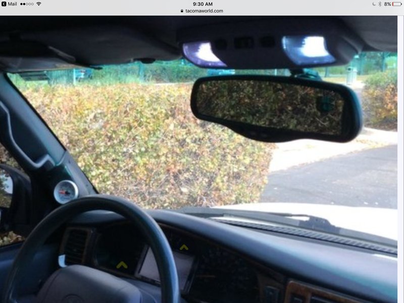

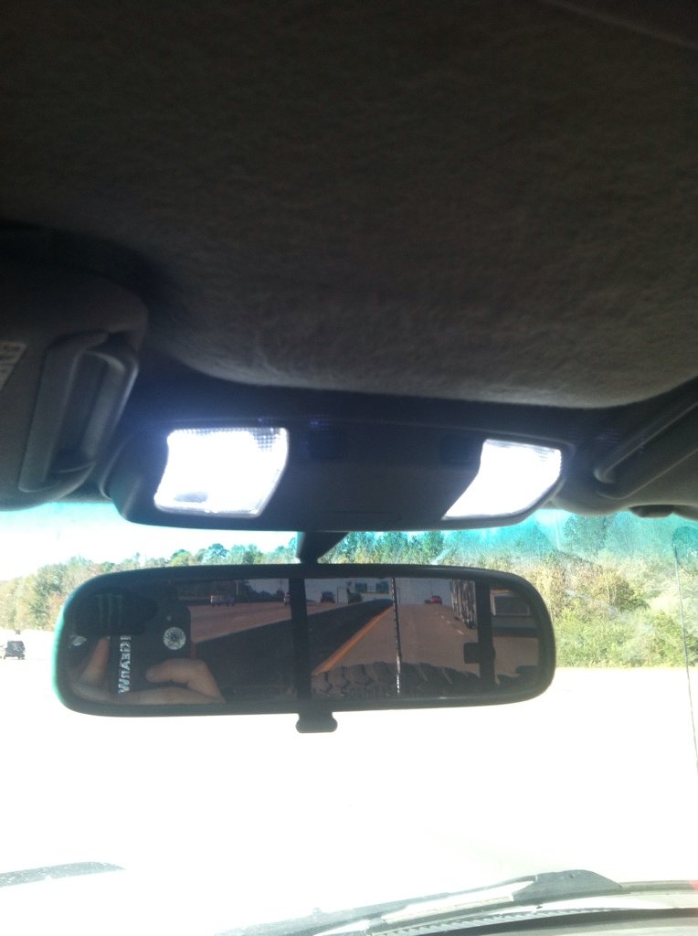

    What lights are these? I'm really interested in swapping out interior lights for LEDs.

    Mine is from 2000 sport 4Runner then added LED bulbs

    Which LED bulbs? :confused:
    I'd like to know so I may do it too!

    2001 Toyota Tacoma Car ReplacementLight Bulb Chart
    Low Beam Headlight Bulb Size: 9003/HB2
    High Beam Headlight Bulb Size: 9003/HB2
    Parking Light Bulb Size: 168 or 4157NALL
    Front Turn Signal Bulb Size: 4157NALL
    Rear Turn Signal Bulb Size: 1156
    Tail Light Bulb Size: 1157
    Stop Light Bulb Size: 1157
    High Mount Stop Light Bulb Size: 168
    License Plate Bulb Size: 194
    Back Up Light Bulb Size: 921
    Front Sidemarker Bulb Size: 168
    Dome Light Bulb Size: DE3175. This one
    Step/Courtesy Light Bulb Size: DE3021 or DE3022
    Instrument-General Bulb Size: 194

    Went to pepboys and they had a chart for replacing the standard bulb
    to an LED bulb, bulb was made of 12 little light section.
    You need two of them I think they were 7.00 each

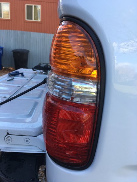

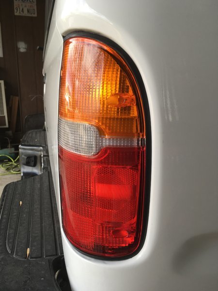

    I blatantly plagiarized this guy. The smooth tail lights look way better.

    haha, I went the other way, put 04 tail lights on my 98.

    So I have read that when going from 01-04 tailights to 96-00 that there is a wiring issue? Pretty much the 01-04 trucks need an extra ground wire? Did you find this issue with yours?

    Yes! I really don't like these tail lights; think I'm going to do the same soon.....

    If that is the case you can remove the pin and splice into the existing ground wire, the pinout is super easy to determine with a test light or a multi meter.

    Ya, I just read some threads about this and people said it was a pita

    It won't be, you could literally just jump it with a t-tap in 5 mins to test it.

    I didn't know that. I bought the lenses only, not complete assemblies. I thought they were interchangeable, but I had to modify my 01-04 tail light housings with a dremel to get the smooth lenses to fit. No biggie, though, it only took a few minutes per side.
    I only have the lenses but if you want them I'll sell them to you.
