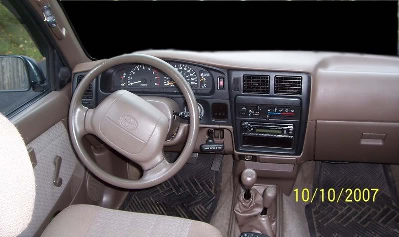

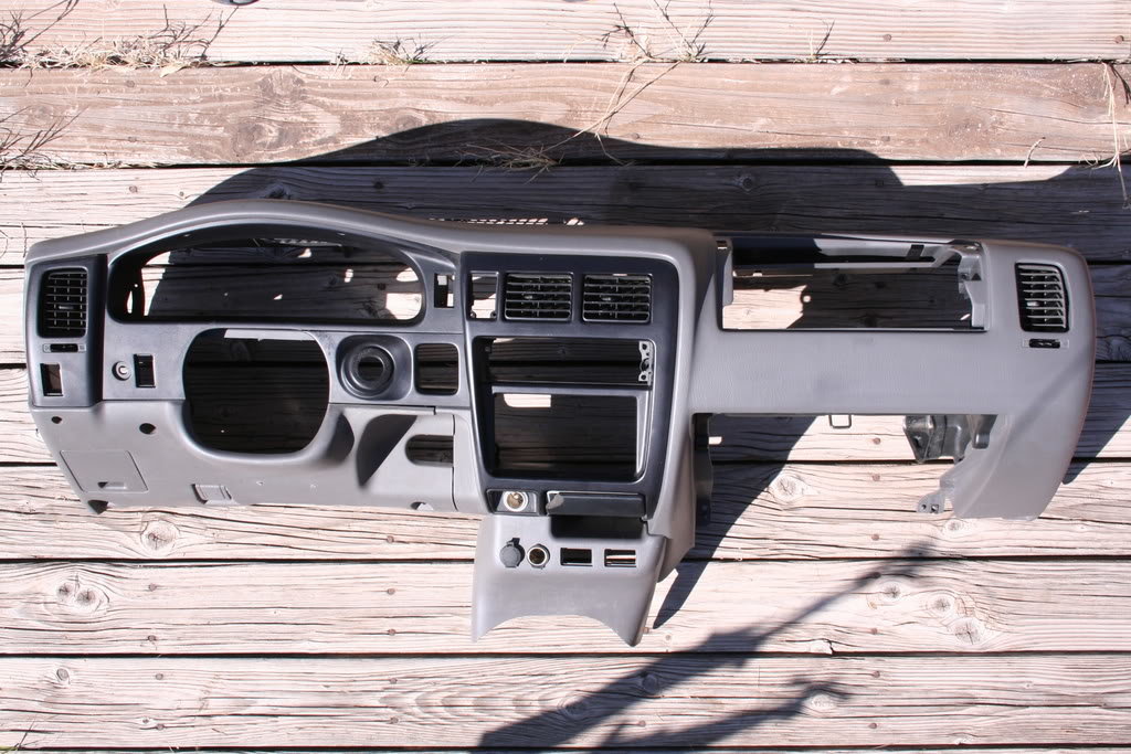

    If you look at pictures of the 97 radio bezel, it is a different shape. The 98-04 bezel includes the ash tray while the 95.5-97 does not. The 95.5-97 has a separate dash piece for that, but even swapping that in isn't possible because the 98-04 is one piece on the passenger side of the dash. You could potentially trim it to fit, but I'm guessing things won't line up correctly.
    97 dash
    04 dash

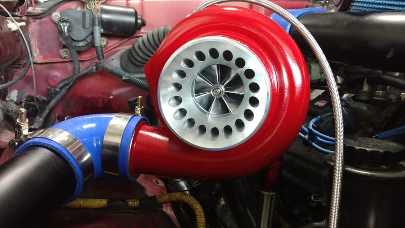

    Would a 5vz turbo count as unique? We are but a few :D

    Beautiful.
    How much did this setup cost you, assuming you installed everything yourself?

    Around $3500-4000 Including an AEM unit and the potential for 350 HP :D And I installed it all myself.

    How hard was the install?

    Time consuming. Not necessarily hard but definitely tedious. It took me about 5 days total install time. Over a period of two weeks since I didn't have all the parts I needed. I'm actually about to make a in depth how-to turbo a 5vzfe thread. In the next few days. :D Id say its totally worth it.

    Not bad! As much as I want a turbo on my 2.7l, there's no economically sensible way it would ever make sense for me to get one. Lol.

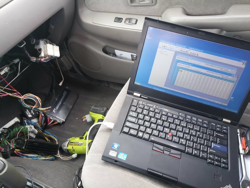

    Does running a Greddy EMU w/ Split Second enricher count as a unique mod, doubt many or even a few run this EMS.

    I'm going to school for Computer Engineering and I have no remote clue what any of that does. Lol.
    Why are you running Windows XP by the way?

    doooooo it. Split second enricher and injectors and you're good on low boost i'd assume :D
