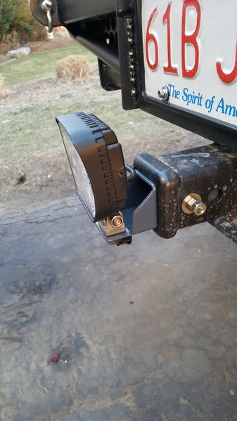

    Easily unplugs if I need to tow, tied to reverse lights but also on switch so I do not blind people in parking lots

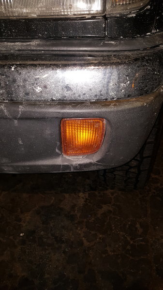

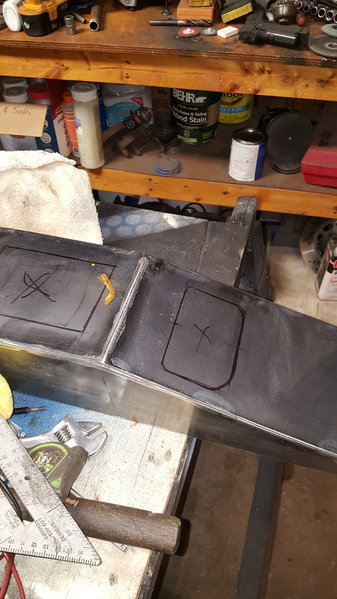

    Building a front bumper was contemplating what i was going to do with blinkers ,was going to mod marker make it marker/ blinker but i was looking at my stock bumper and the directional is at the perfect angle to use on new bumper im going to cut out a pocket to french it in ,led spots are supposed to be here tomorrow so im going to be finishing this up this weekend im kind of excited about finishing it

    How do you wire something like this? Wanting to the same thing with some reverse lights, have them on with reverse lights but also on a switch to turn it on and off when wanting to

    I did that, reverse and switched. I ran the switch to a relay and the I tapped into the back up switch ran the switch and back up switch into a diode and then to the relay. I think there is a better write up in my build thread.

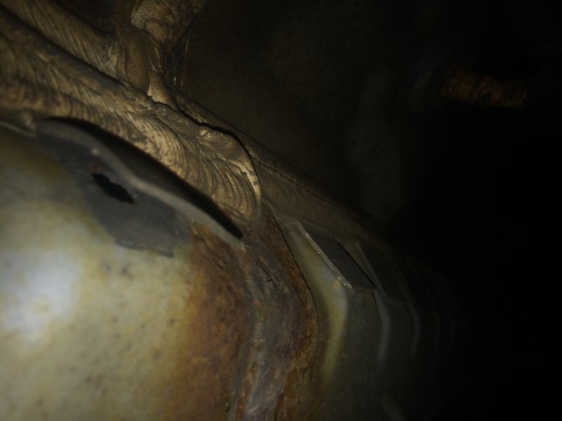

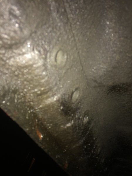

    On my 04 Tacoma there are rubber covering holes on the back side of the inner rocker
    On my 02 I took them off and I think I used a step bit to open them up so I could put plugs in them to keep salt and crap out. Filled with rust check first. IMG_2990.jpgIMG_2986.jpg

    That's a great idea. Gotta check mine.

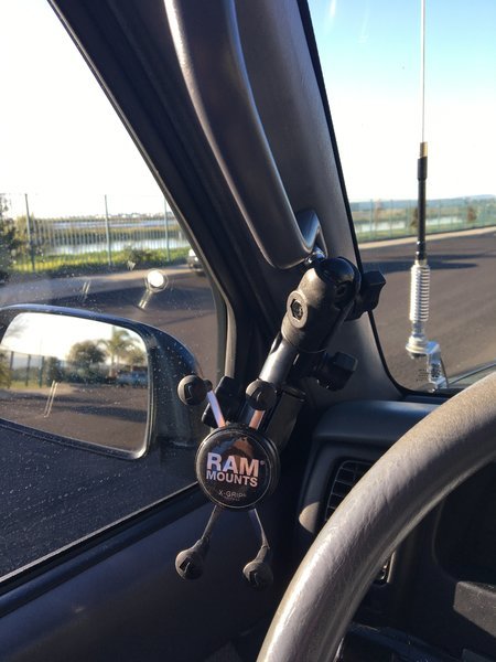

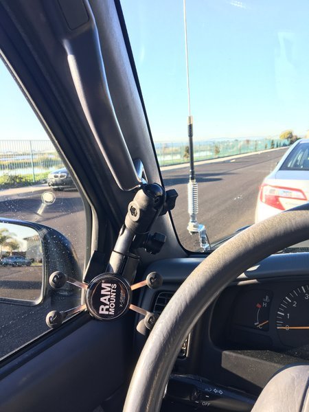

    This is usually a 2nd gen mod, but I mounted a RAM device Mount to the lower grab handle bolt. I used the 2nd gen write up on it and since Toyota kept the M6 handle bolt pattern constant throughout the years it mounted up just fine.
    It's really as simply as buying some M6 bolt hardware (lock washer, washer, and nuts) at Home Depot and bolting it on. The all mount originally uses M8 bolts intended to be used on a motorcycle but it works just fine with Toyota M6 bolts.
    Here it is installed on my '98:

    where did you get this?
