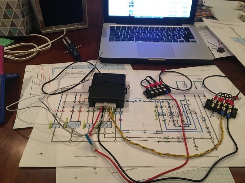

    I'm working on converting my 1998 Extended Cab factory manual doors (locks, windows, mirrors, etc.) to fully powered doors using door components from a 2004 Limited Double Cab. I'm fabricating the crossover wiring harnesses and locking computer system myself since it would be bypassing the body-ECU/Integration Module. Here's my build thread (still a work in progress!)
    Here's the schematic for the locking system:
    And here's the first component assembled of the locking system, a cheap keyless entry system off Amazon:

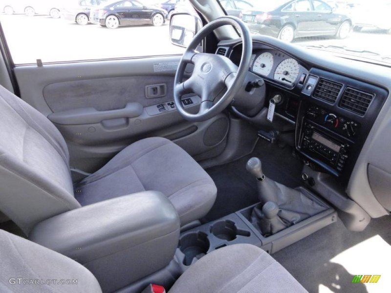

    Not at all, all power components across the entire line of 1st gen Tacomas should be inter-compatible. In 2001 Toyota re-designed the interior of the Tacoma giving you the more modern door panels instead of the switches just thrown onto the armrest like in the '95-'00 models.
    The '01-'04 door panels in my opinion look a lot better. I could have used the '95-'00 style door panels and avoided replacing them by just finding a donor truck with the correct armrests for the switches, but '95-'00 Tacomas with power options are incredibly rare. I will have to get the wider door speakers, or cut some of the existing speaker grille out since the '95-'00 style interior uses round speakers, while '00 forward used elongated ones. The newer style also has tweeters present in the doors while the earlier style does not.
    '95-'00 Style Interior:
    '01-'04 Style Interior:
    It really will only be plug and play if you have the 4 kick panel connectors present for power doors. If not, you will have to fabricate the wiring, electrical, and computer modules like I have to do. (Since we're bypassing the integration module)

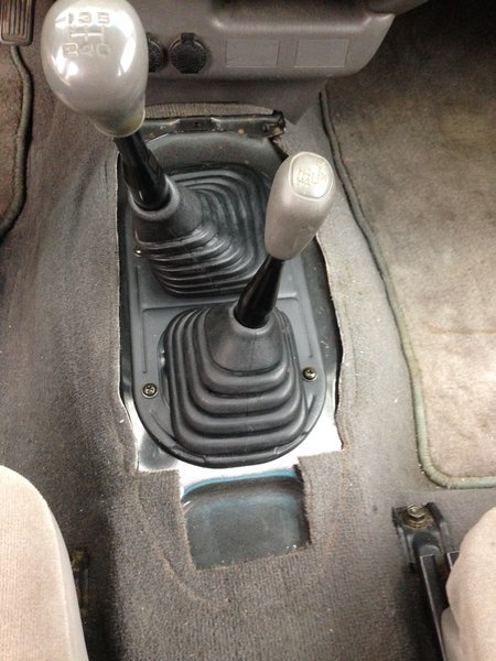

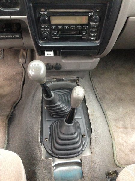

    Going commando on my shifters latest mod. The grey vinyl boots were getting worn and my wife didn't like the cup holder sticking out on passenger side. Stainless plate had surface rust so painted with plastic coat rustolium.
    Planning to trim out the carpet edge and glue down. Will use front remaining brackets for gauge mount plate and planning to put a phone mount behind the 4wd shifter. Will update as it goes...

    Here's an update to my power window, mirror, and lock retrofit. All the wiring is done. I just need to fit the terminal blocks, relays, fuse block, and locking computer inside a project enclosure to make it a little more neater. All the parts are genuine OEM components out on '04 Limited Double Cab.
    Everything works great. I'm planning on motorizing the rear vent windows of my extended cab utilizing the double cab switches on my master switch. I might even motorize the rear sliding window if I can figure out a worm gear system.
    Once I get my new window regulator in, I'll put it all in the truck.
    Video of everything working can be found in my build thread!
