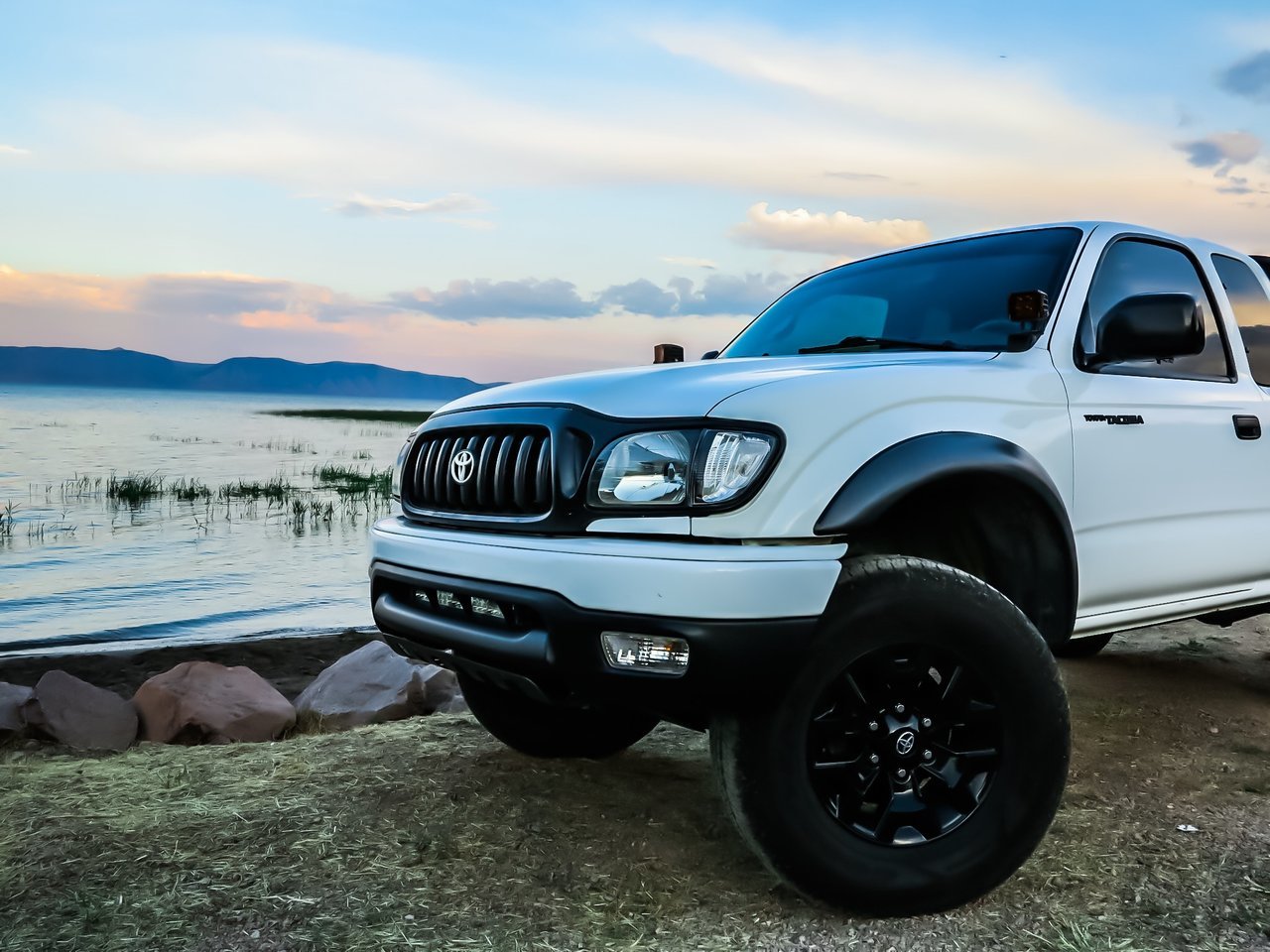

    I love the look of the 3rd Gen TRDOR rims on our trucks! I powder coated mine gloss black.

    Very clean truck, well done.

    Thanks man!

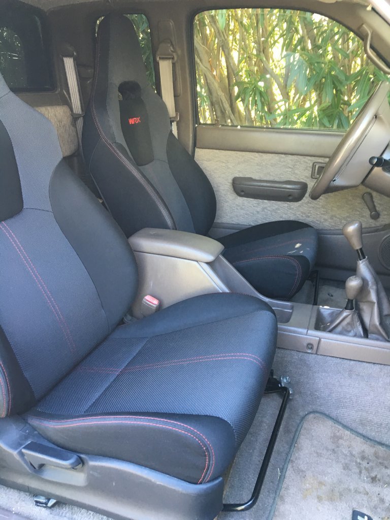

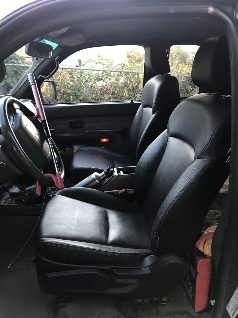

    I'm not sure if I'm the first to do this but I put in Subaru WRX seats. They are amazingly comfortable. We did a 10hour drive and my wife didn't even mind and the older seats would have killed us. They don't flip forward like the old seats, which is awkward, but I'm going to see if I can mod them to come farther forward.

    Those are SAF! How are they mounted? Did you use the Tacoma brackets?

    Interested in mounting details as well. Looks comfy!

    Damn I was interested in the swap till you said that. It's the only way I can get some of my bigger boxes in the extra cab, and was how I was going to get a fridge in there eventually.

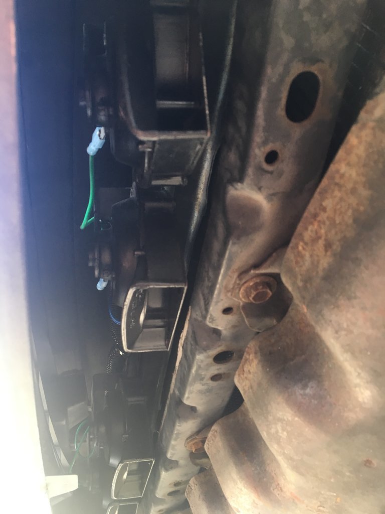

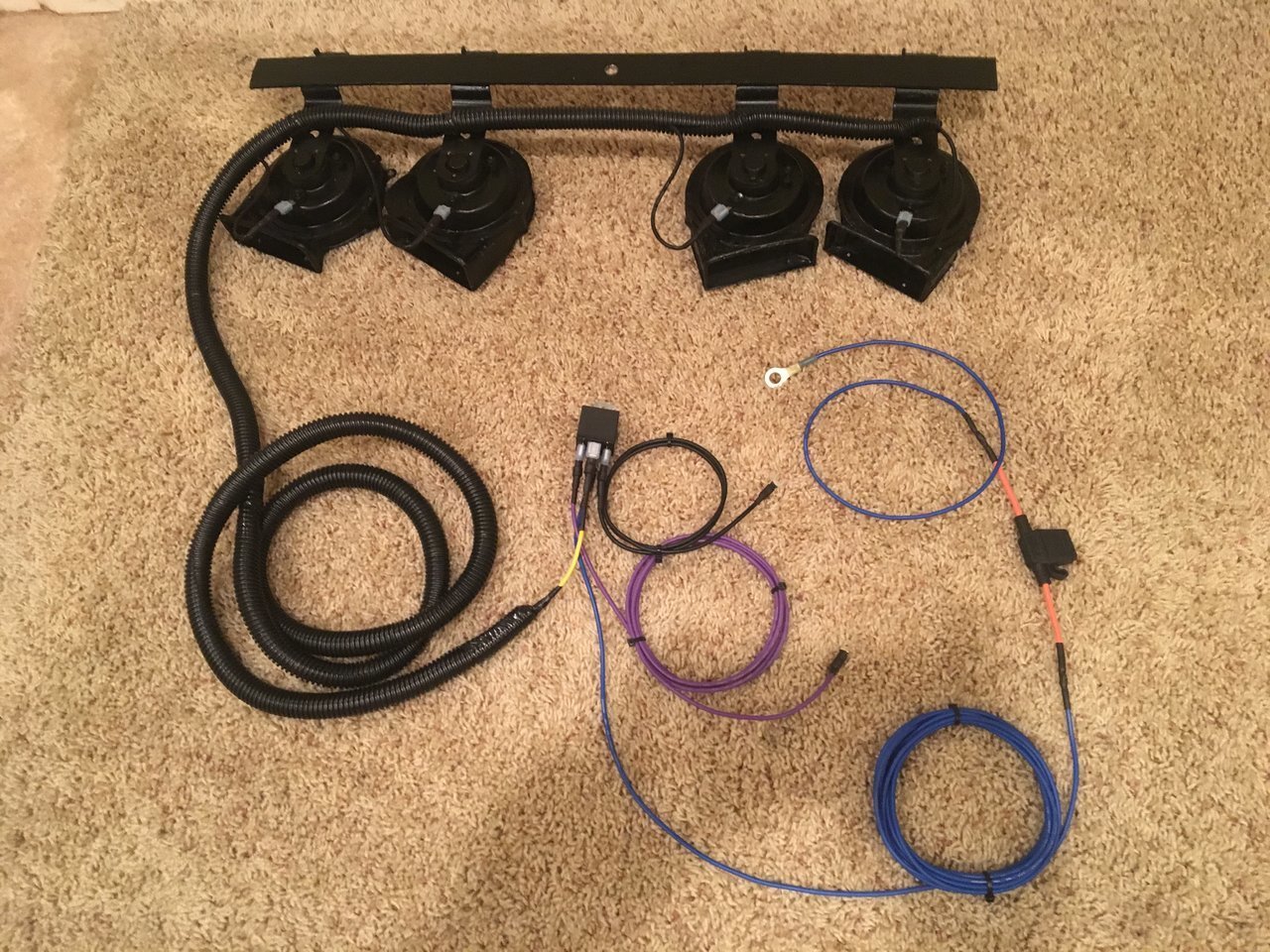

    I have four Delco-Remy horns from a 1980's Cadillac DeVille in my truck. Each horn plays A, C, D, and F notes respectively. Hell of an improvement over stock - people actually pay attention when you honk now. Sounds like a damn train horn.
    Here's the setup on my own personal truck:
    I just finished up making a plug-n-play setup for someone on the forum shown below. It is powered by 12v from your battery, fused by a 20 amp fuse (each horn draws 5 Amps each), and controlled by a relay. A lead from the relay plugs into your factory horn trigger wiring and will sound the Cadillac horns without any modification of the stock Tacoma wiring system. I can set it up in a way to include your stock horn(s) if you really wanted. (You can have up to six horns!)
    Here's a video of the horns in action on my truck:
    And here's a video of the setup stock on a Cadillac El Dorado:
    https://www.youtube.com/watch?v=B3e5BCE9zFI
    If you'd be interested in a setup for your own truck PM me and we can work something out. As you can see in the picture above I make a plug-n-play kit that bolts inside of your factory valence under the grille.
