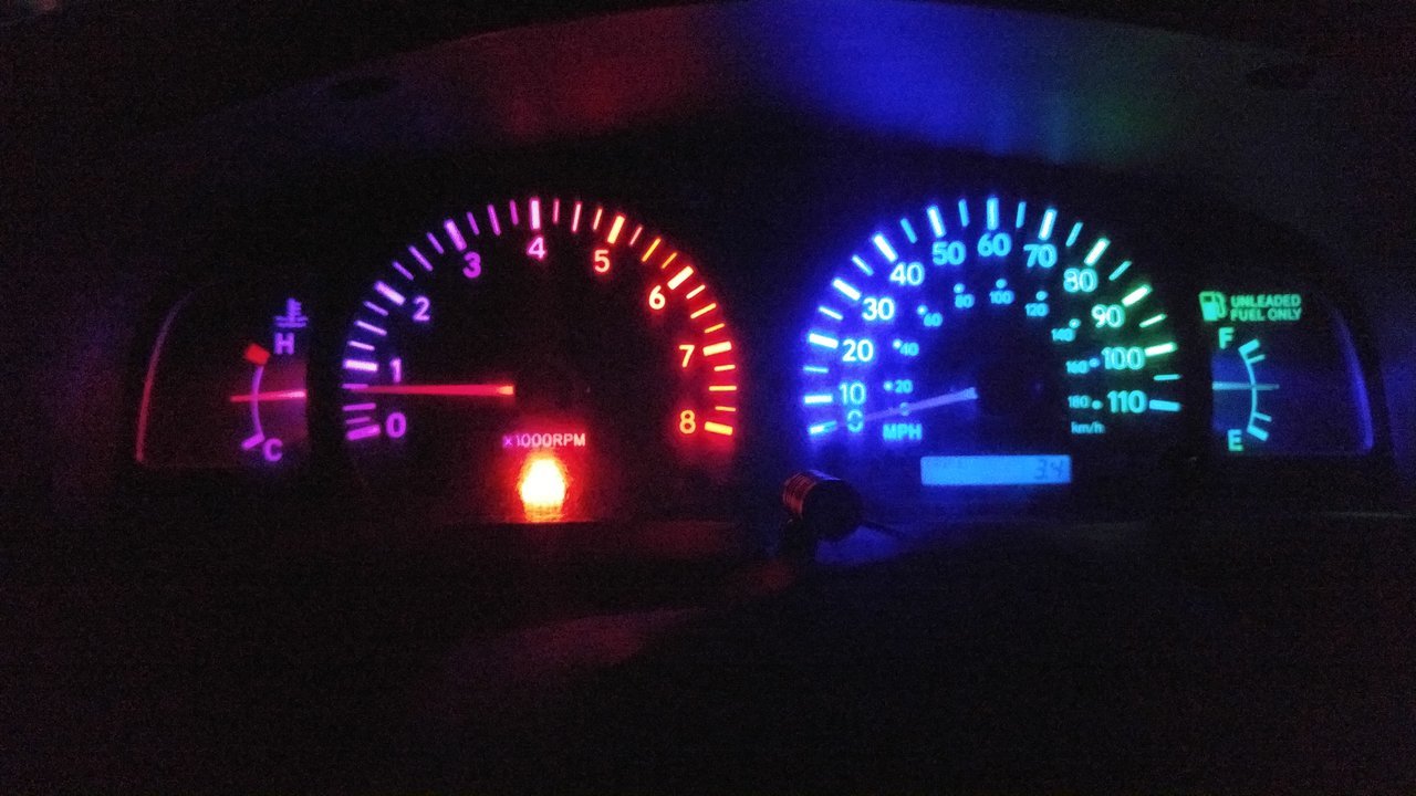

    Pretty sure this is a first. 4 bulbs, all remote controlled with varying transition settings or I can set one color for all.

    how much was for a set of 4?

    Where did you get them from and can you change how bright they are?

    How hard is it to get the those bulbs?

    really easy actually all you need to do is unbolt the panel under the steering wheel and go from there takes about 5 minutes to take it all apart

    Easy to get. Lotsss of variance. Comes with one of those full color option remotes along with brightness settings. Took a little finagling and the right side didn't want to work, took some trial and error and it works now.
    The only downside so far is that the constantly changing color mode is a little quick for my liking and you have to mess with it a little to get the color you want without it strobing. Not much, but enough that it's worth mentioning.
    I love the variety of colors since I get bored a few times a day.
    T10 194 W5W 168 2825, (6)SMDs 5050 RGB LED Chips 12V DC by MONDES, Super Bright 16-Color Changing Wireless Remote Control, Silica Gel Coated Chip Boar https://www.amazon.com/dp/B01N6RRDM8/ref=cm_sw_r_sms_apap_ErkuflhznZ96o

    My bad, misunderstood your question. 3 screws and two clips to get the center a.c. rack off.
    3 screws(two above the cluster) and 4 bolts to get the part under the steering wheel off. The clock piece clicks into place and the key hole light takes a 74 bulb(in my 98), two 74s for the a.c.,one 74 for the ash tray and one for the glove box
    4 194s for the gauge cluster, three wire clips on the back of the cluster and one clip for the emergency flasher. It takes some cursing and stretching of the dash to get everything out but it's not bad considering I did the whole procedure twice in a week.
    Oh, and tape up the part above your steering wheel with painters tape. Realized I'd scratched it when removing the cluster the third time.

    $16 for a set of two so around $35
