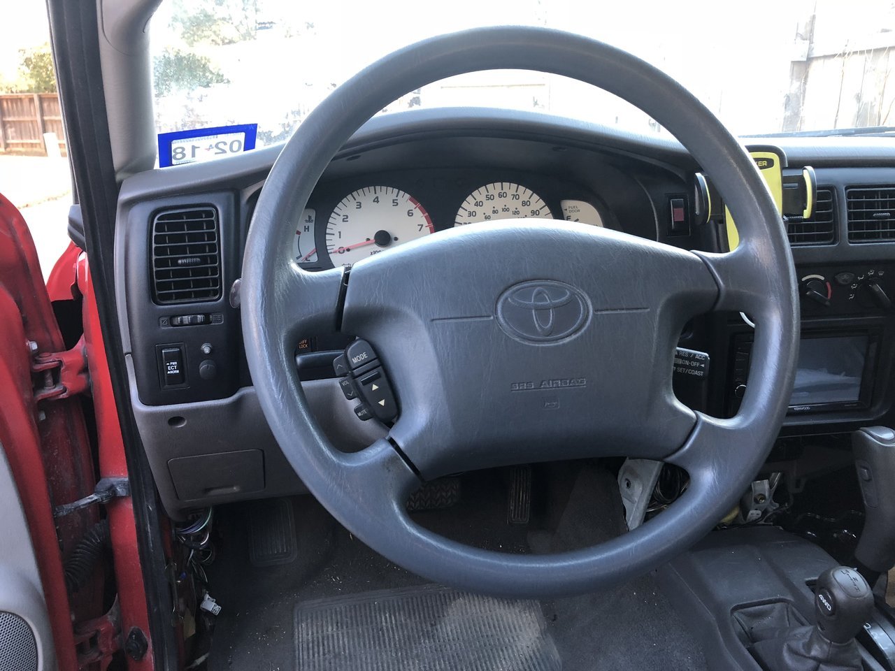

    Correct the sienna wheel, bag and spring are all plug and play to the Tacoma, you will have to add a steering wheel control interface to go with your aftermarket stereo.
    And the sienna gray is a little different, but not that noticeable.
    I’ll get better pics of it installed today.

    Already have a wheel and airbag from a 4runner. But it has a dual pressure airbag.. 2 plugs on it. The tundra 01-04 has the single pressure air bag. Still researching it.
    Depending on your head unit it can just require a plug and a few resistrs. Info about it on the web.

    Were do the extra radio control wires run through clock spring?

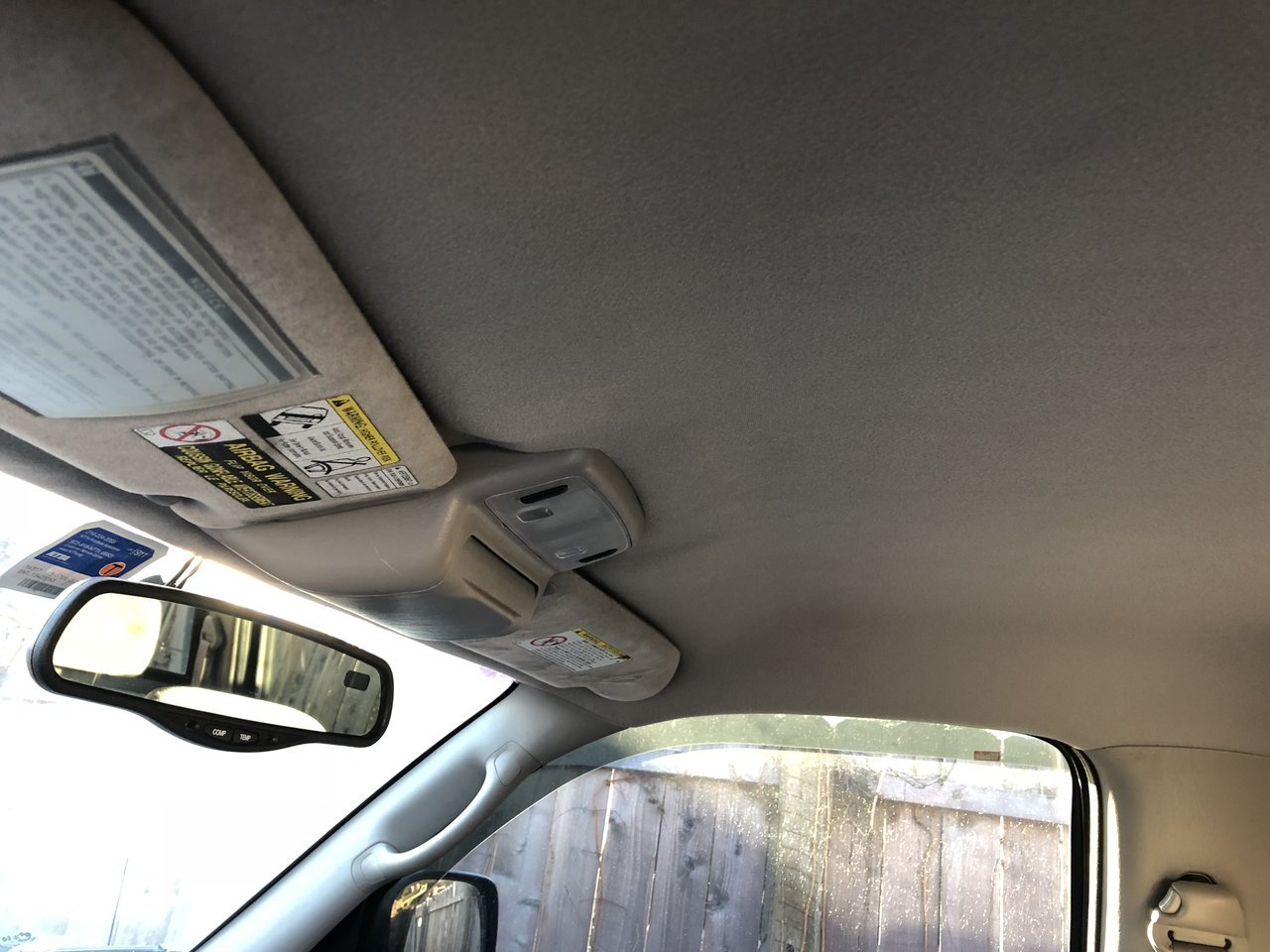

    What year runner is the console from?

    The steering wheel controls plug into a harness on the “new” clockspring. It’s 3 wires one goes to switches ign, one to ground and the other is data to the radio.
    The overhead console is 3rd gen non sunroof. I took the console and surrounding 12” of headliner from the runner and grafted into mine, I needed to recover my headliner anyways.

    Think a Lexus steering wheel of the same era would work? With airbag?

    I did look at a steering wheel from an LS400 and I believe the clock spring looked interchangeable. And the airbag was a single contact.

    What should I be looking for in a potential steering wheel?

    Single plug air bag. The steering wheel is very common around those yesrs.

    What about the cruise control?

    Yeah, really anything else you can probably repin to your stock clockspring and clockspring plug if you want to keep it. Otherwise a clockspring swap is required to add extra features. Hell the A340 can even use the tip tronic option the IS300 wheel has if you get one of the little controller boxes, strangely enough so could my cruiser not that I'd ever do that.
