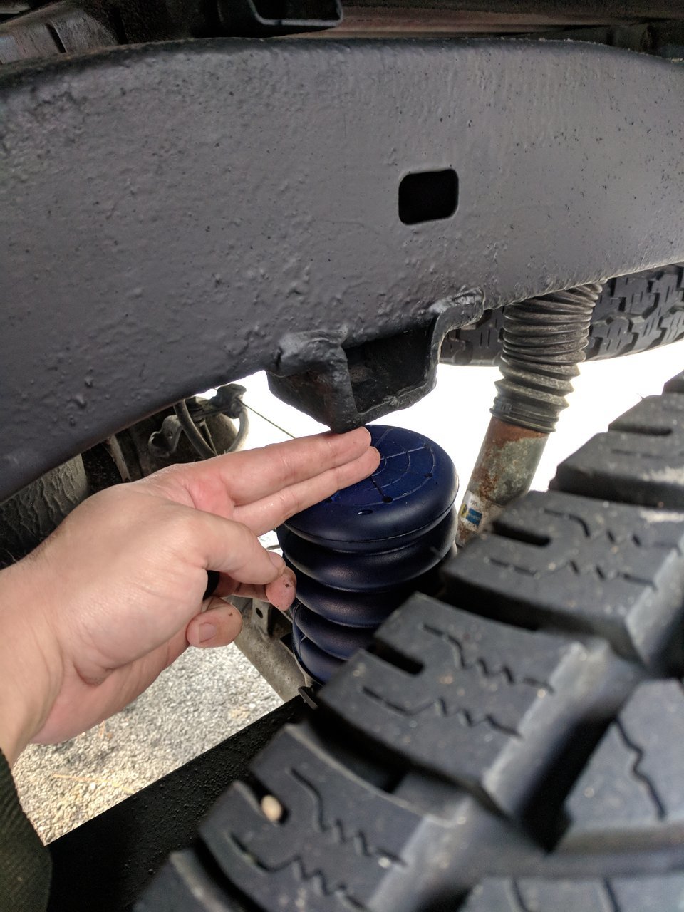

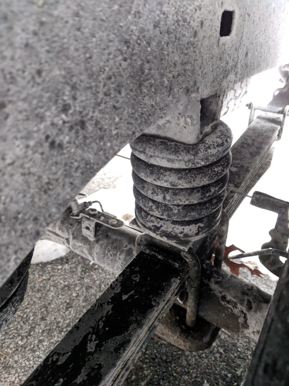

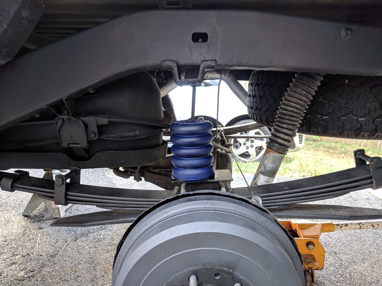

    Put these super springs on my lifted 96 to help with load carrying. Worked out really nice.

    and how does this thing ride with that on there?

    When it's unloaded you can't even tell. I left about an inch and a half between the bump stop and the foam spring. So general driving they almost never engage. Can only really feel it if I'm unloaded and go over a large speed bump, and I can tell when the super springs engage, but they are pretty soft until more heavily loaded.
    When loaded down they help ALOT! minimal sag, and really limits body rolls on sharper turns. And for reference I have the headstrong 3 leaf AAL which is why I had to make those raised mounts for the springs.

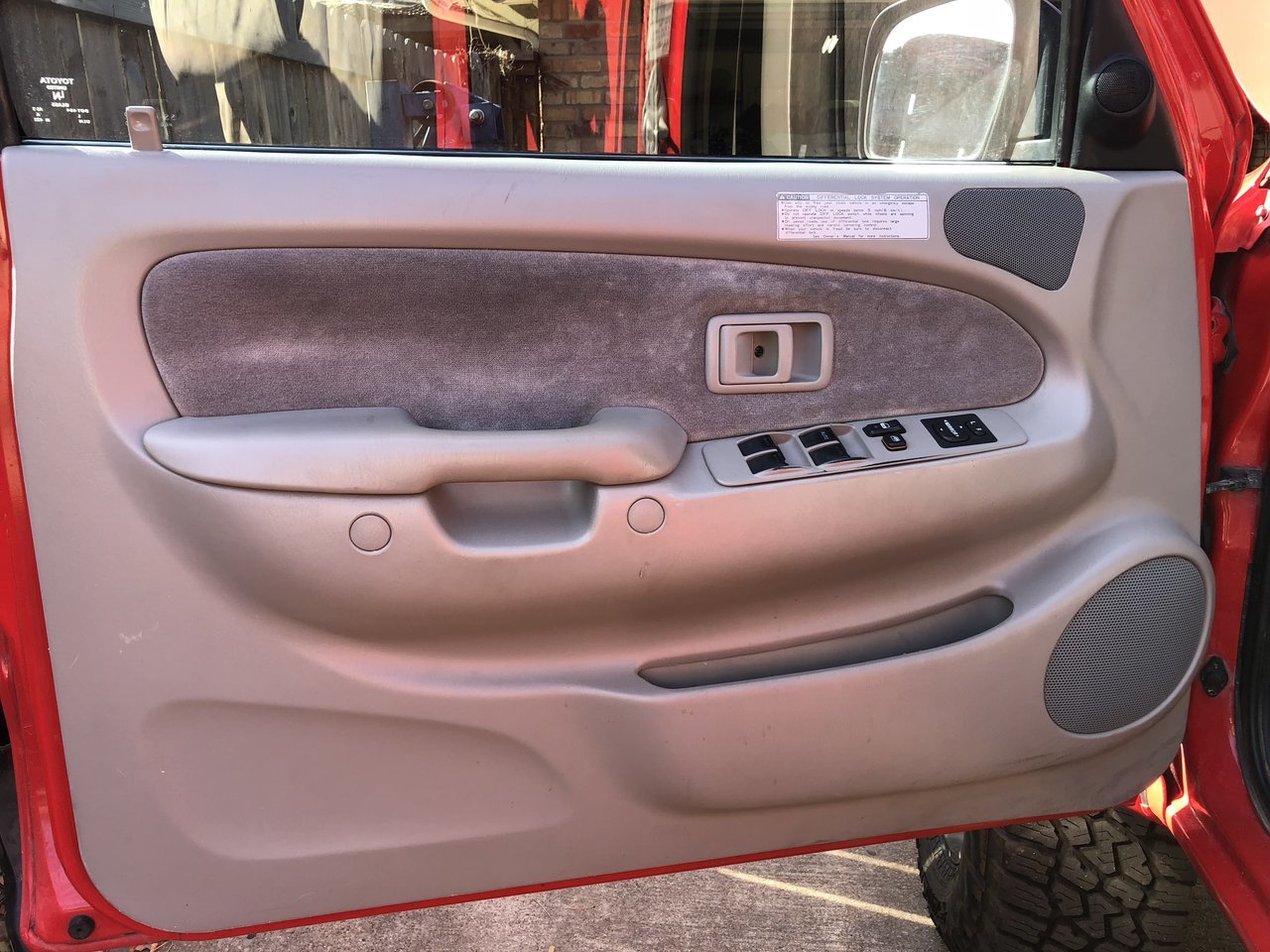

    Any pictures on the mids installation in the door panel? I like the looks of that very clean. What's the backside look like?
