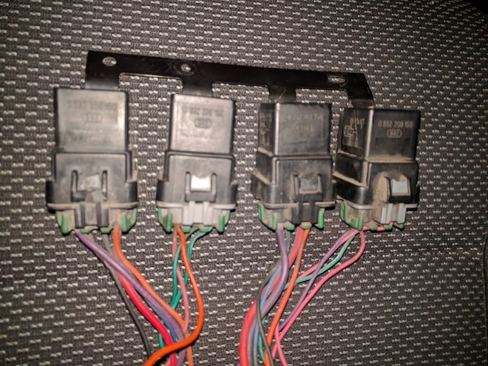

    If you are looking for a sealed relay setup there are Bosch setups on second gen Chevy Blazers/ GMC Jimmys. On the passenger side firewall in the engine bay. Some have Hella relays.

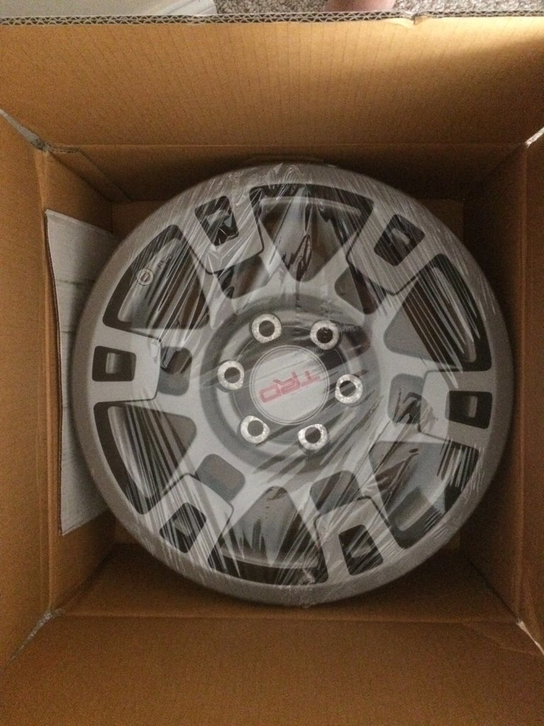

    Did you install these rims? Did they hit the inside? Or did you have to use spacers?
    I'm looking at a set but don't want to deal with spacers.

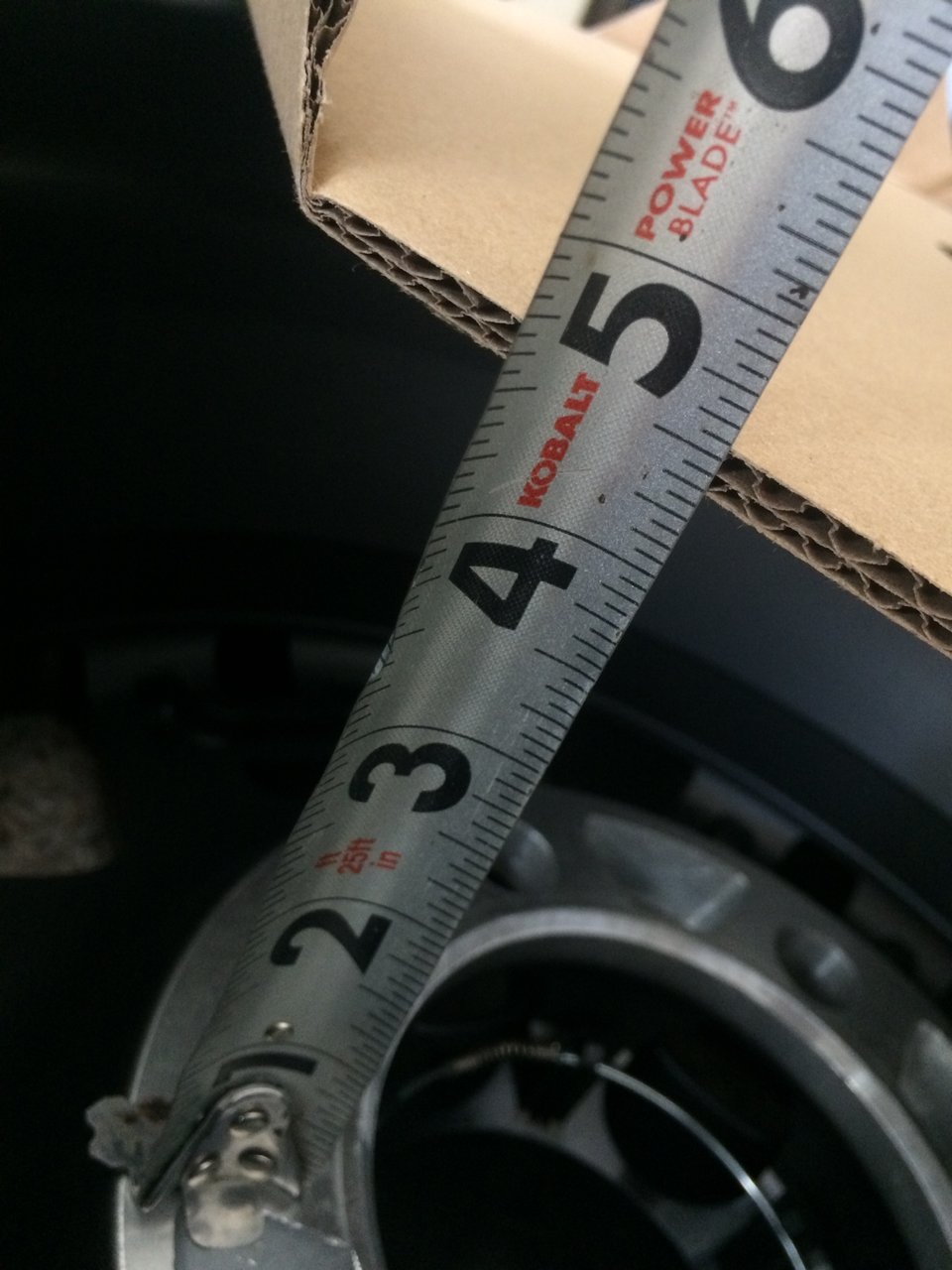

    They are still in a box but the backspacing is 4.59”, stock is 4.15” so less than 1/4” difference from stock 2003 wheels. I don’t expect to rub.
    Not exact measurements but this was measuring back of wheel to a piece of cardboard laying across it.
